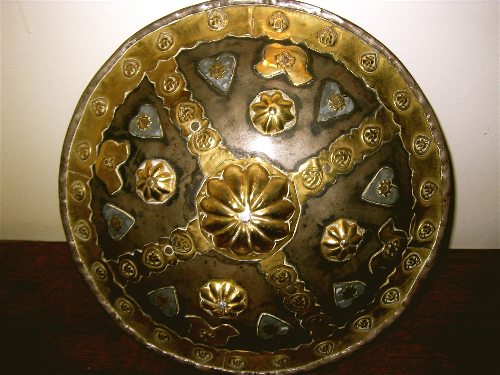

Moreover in here is a round shield (Rondache) about which I wish to ask for some questions about it's was bought in the 80’s from Jeddah KSA,

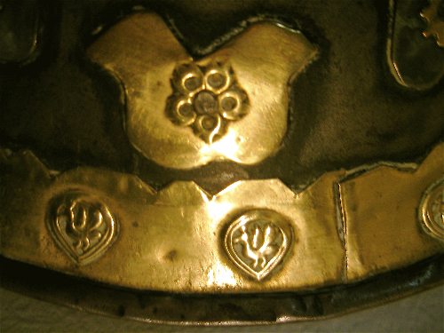

I have of make restore the central part in brass which had disappeared,
average restoration (in Egypt ), the replacing cabochon is of a size lower than the original in sight of tracks left by the precedent
with your opinion;
- that it’s could be his origin;? Yemen, Persia? or ?
- datation, I think circa XIX or any beginning of XX ??

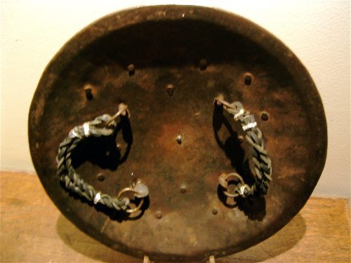

just f.y.i., I reconstituted myself the leather belts
best regards

Don't worry - most of us aren't experts either.
To me your shield looks to be possibly from around Pakistan or Baluchistan, and made in the mid-late 20 century. I base this on the type and amount of decorations on the shield, the use of brass, and the sharpness of the cuts in the brass.
It would have had padding inside inbetween the leather pieces, in the middle. Nice leather braiding.

Interesting piece. the style of decoration is very different to Indian dhals and Iranian Sipars. I won't even try and guess where it's from originally.

It is Aceh from Sumatra.

I don't think this shield is from Aceh. The ornaments on the shield don't look Aceh to me. Persia or India is probably a better direction.

I have seen some examples from Pakistan and Balukistan region that are very similar. No, it is not your usual dhal or sipar, and definitely not from Sumatra.
