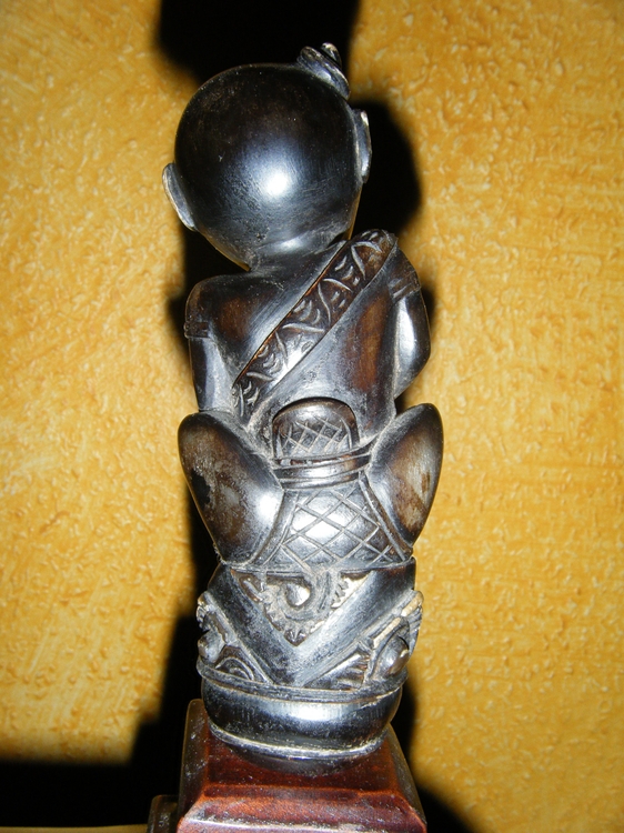

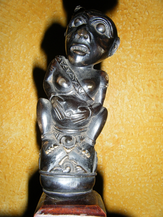

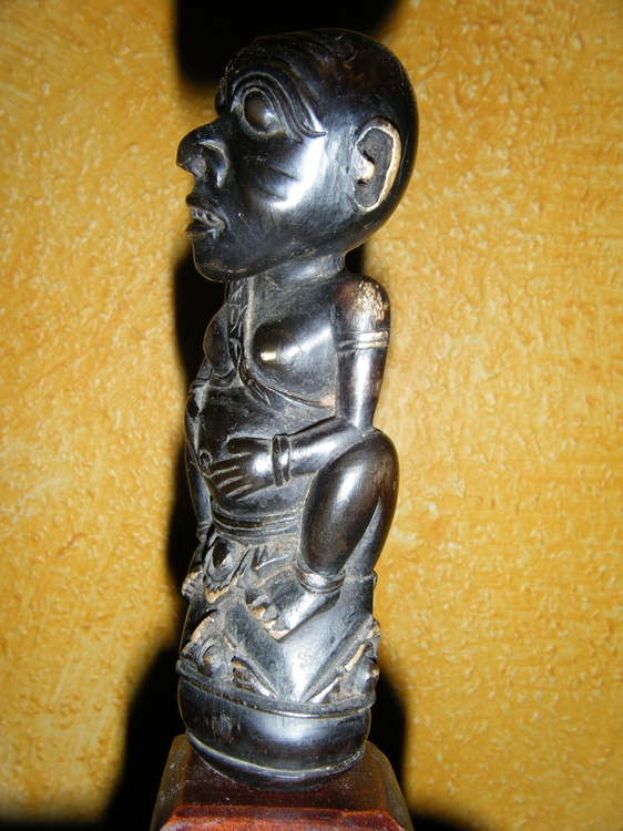

Dear members,
I have already long this hilt and I am very unsure if this is a keris hilt since it is bend to the right while keris handle normally have a light bend to the left. The handle is worked from black horn and seems to have a good age. I think that it is from Bali or maybe from Lombok. What do you think?
Old 10th October 2011, 12:05 AM   #2
I have also this three handle, I guess all from Bali, where I think that this are most probable plocokan (betel pounder) handle, but really sure I am only by the last one.
Sorry, the order is not like I upload the pictures. The first and the two last pictures show the handle where I think that it is a plocokan handle.
All comments are welcome and I am curious to read what is your opinion.
IMHO you are right. Frankly I am a bit puzzled by the hilt shown in pics 2,3 and 4 . Holding it in hand would not be so comfortable ....
Could it be made for a display keris ?
Hello Gio,
thank you for comment. I think you mean the handle from whale bone, the human with the bird on his shoulders? Believe me, I just test it again, this handle is a very confortable grip.

With usual qualification:- based upon what I can see in the photos.
man with bird --- keris, recent, not for wear
black hilt --- keris, recent, Lombok
naked figure --- keris
man with serpent --- pestle or small knife (pisau pemutik or temutik), however, I feel this has been done purely as a sculpture, because both knife hilts and pestle handles usually have a ferrule fitted
By "recent" I mean after WWII
An enormous amount of small sculptures in the form of hilts have been available in Bali and Lombok over the last 30 years; a lot of things produced in Lombok are sold in Bali.
Old 14th October 2011, 08:28 PM   #6
Hello Alan,
Do you have a statement for the circumstance that the black hilt is bent to the wrong side? I am unsure about the age of this hilt, you may be very well correct that it is a hilt after WW2 but this hilt have clearly signs of good use. It is worked from black horn and at the touching areas becomes "white" what I have only seen by horn when it was long in use. So when my assumption about use and your assumption that it is a keris handle both are correct why is it bent to the wrong side? This question employed me every time again when I have hold it in my hand and was also the reason of this thread. Do you have seen other hilts (for keris) with this "wrong" bent?
