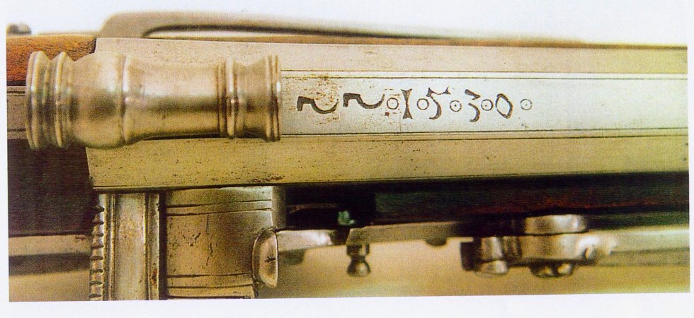

I attach an image of the same date, 1530, on the barrel of the earliest known dated wheellock arquebus, by the Ausburg gunsmith Bartholomäus Marquardt, who worked for the Roman Emperor Charles V.
Real Armería Madrid, inv.no. K 23.
m
