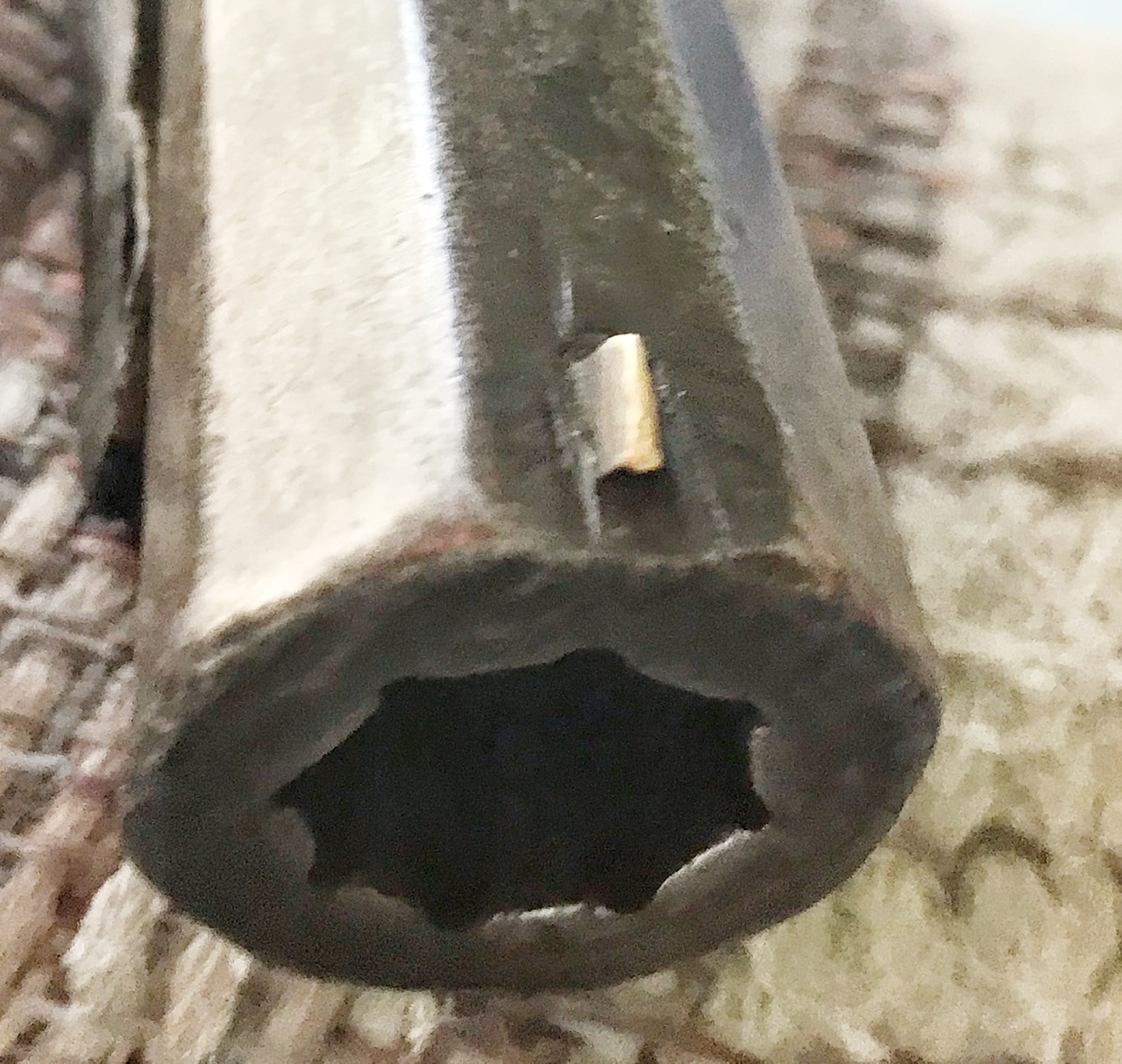

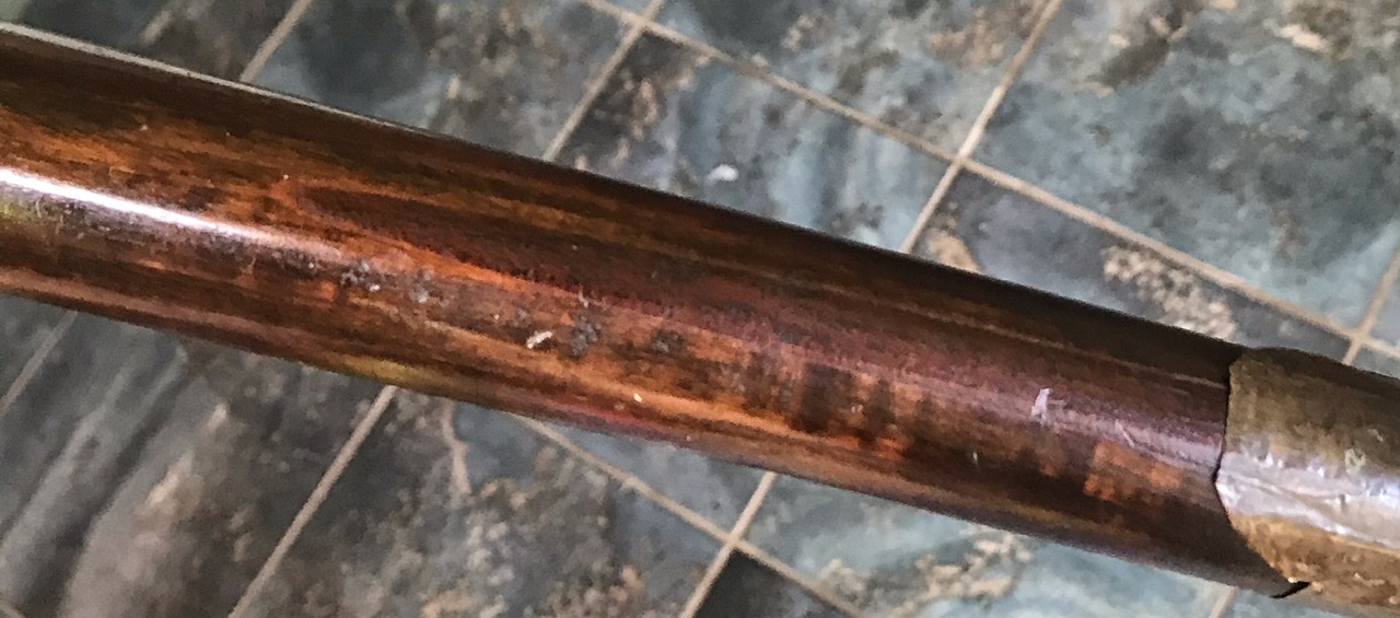

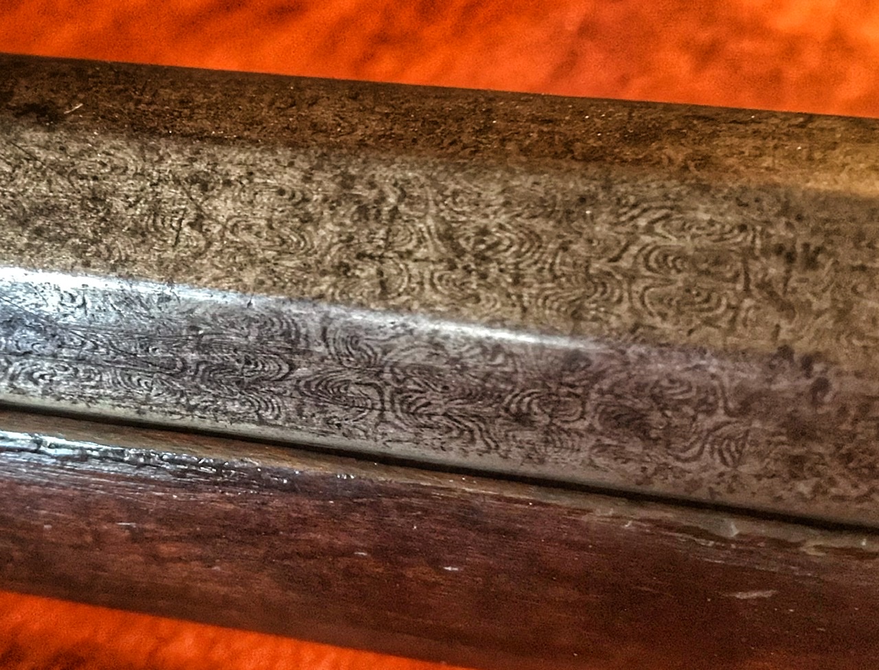

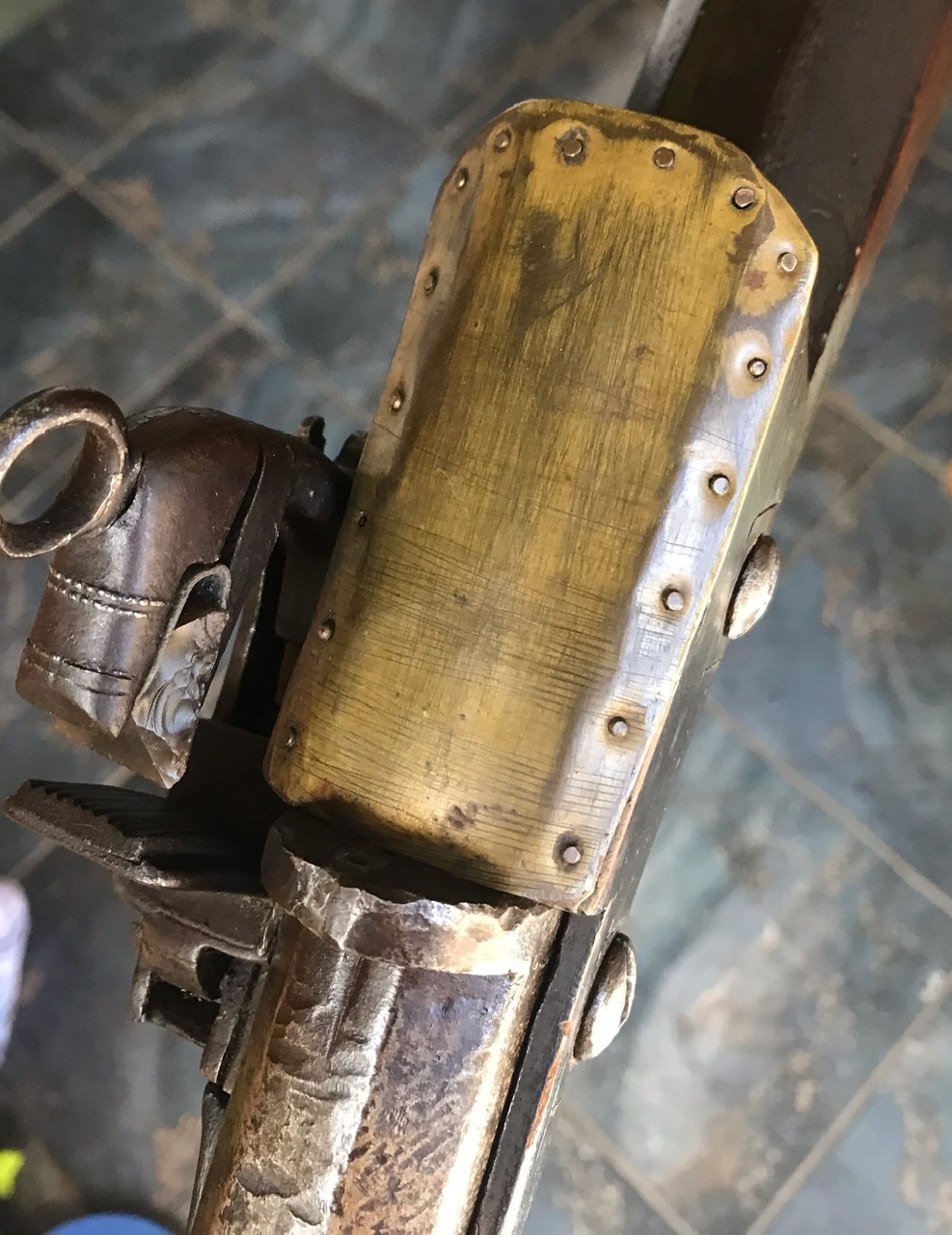

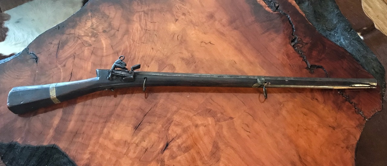

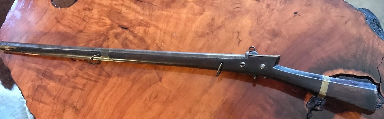

Hello, long time lurker of the boards here but after coming into possession of this I decided to finally register. I'm excited to share what I have and know as well as looking to learn from you fine folks.

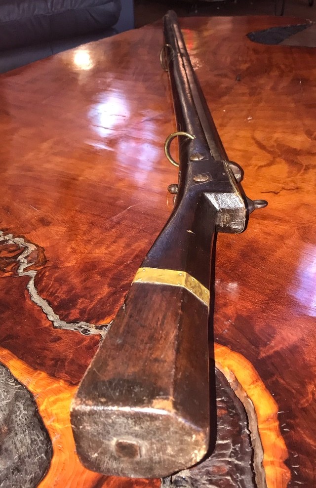

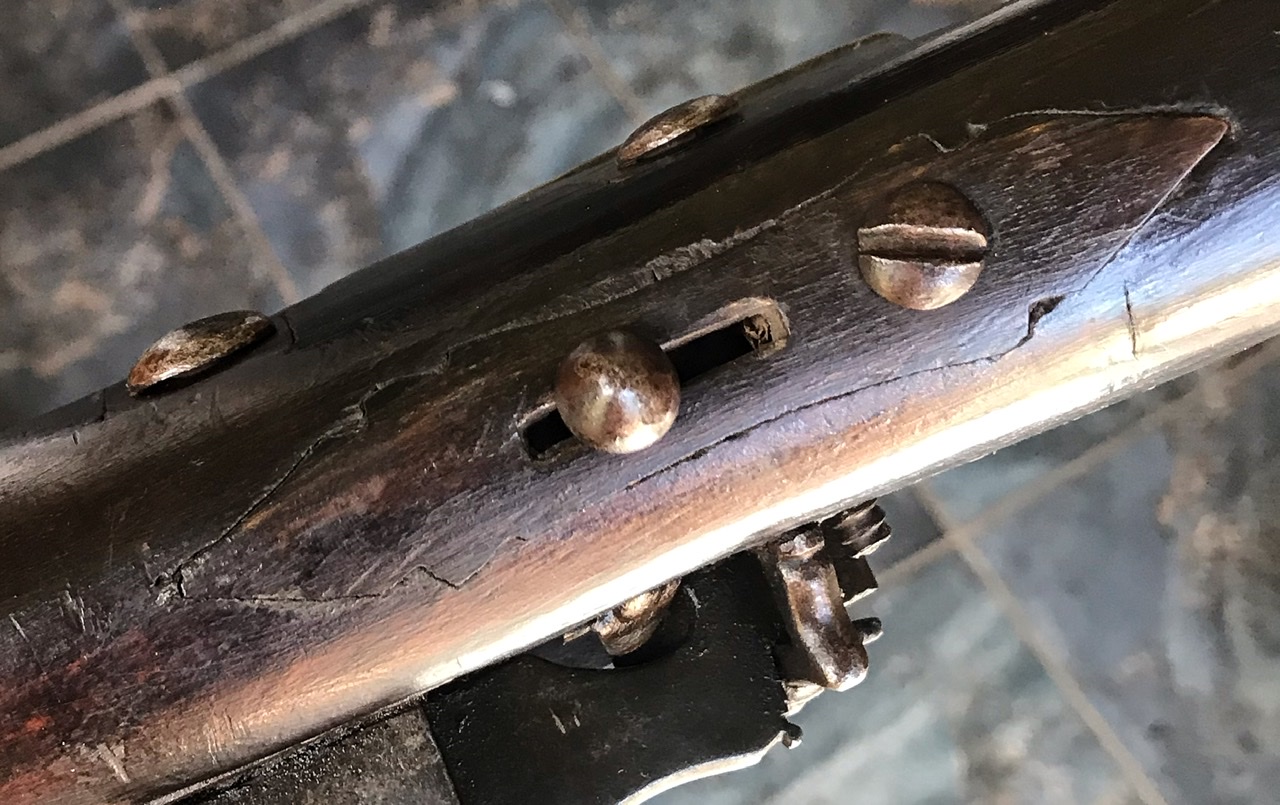

This rather plain rifle has a 31.5 inch damascus barrel with 8 groove rifling in .55 caliber. The bore is actually quite good with no pitting. As I've never seen a sling set up like this on any rifles of this sort, I believe the rings in the stock to be incorrect and probably a modern addition by someone who thought something was missing.
It has some period repairs, such as replaced missing bone/ivory inlays with wood, brass cap covering the tang, and some kind of fabric acting as bedding for the barrel it seems. The ramrod I believe is also not original as it is mostly unfinished wood and fragile. It needs some cracks fixed as well.

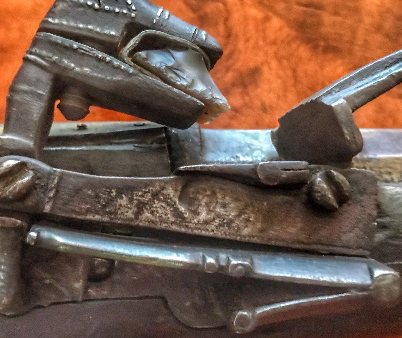

I'm hoping someone might be able to tell me something about the age and/or place of origin. I know this style of rifle was used from 17th century till 19th so it can be difficult to gauge. The hallmark on the lock is pretty worn but maybe it is familiar or legible to someone here? The hammer wont go to full cock and is VERY difficult to get close to the notch. EDIT: after cleaning the lock up a bit, it now easily goes to half cock and full cock.
I look forward to and am grateful to any and all information,
Thank you.

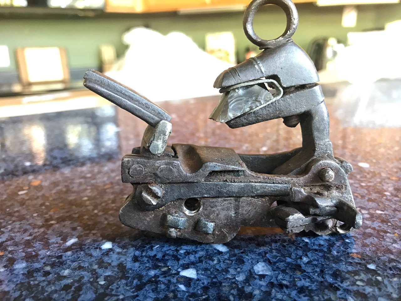

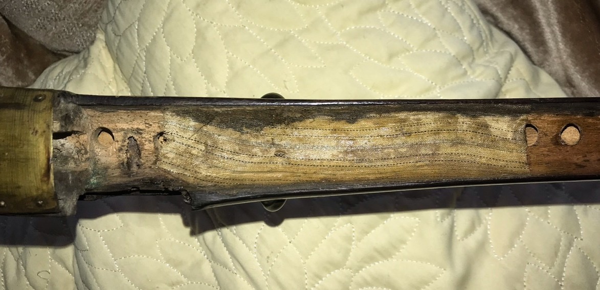

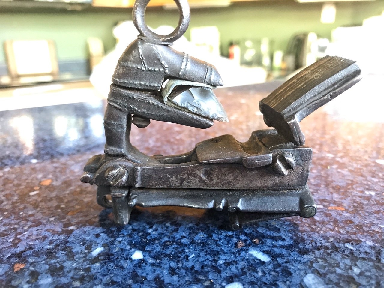

The lock removed, some period repairs/replacements. Strange wood splice in the ramrod channel.

Hi,
From what I see it's a very net gun, in very good condition.
As you wrote the suspension rings are a late addition, probably also the big screws. The barrel bands are missing.
The lock is typical from Ottoman TURKEY. The whole gun looks Turkish, the Balkans models are well known. As you wrote, it's difficult to give an age to a gun like this, without taking any risk I would say 1750-1850.
I'm sure Rick will tell you more. Very nice gun

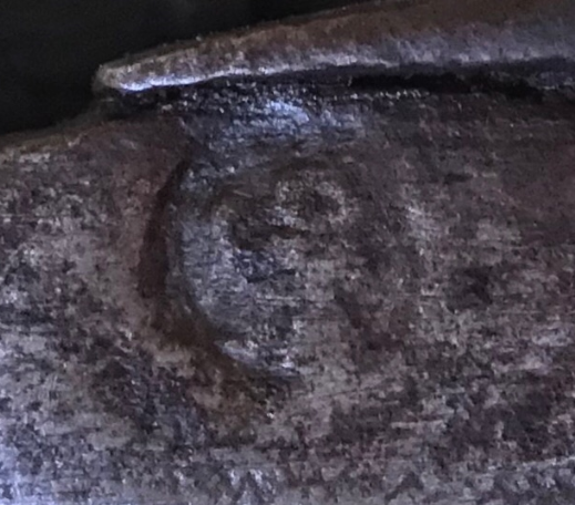

If you send a close-up of the mark on the lock I might be able to help
kwiatek is offline   Reply With Quote
Old 11th June 2020, 12:05 AM   #5
cyten
cyten's Avatar
Join Date: May 2020
Location: Caucasus
Posts: 97
Kwiatek, I really appreciate it! Unfortunately it is very worn and this is the clearest I can get.
Having no reference material, I can't even guess what it could be.

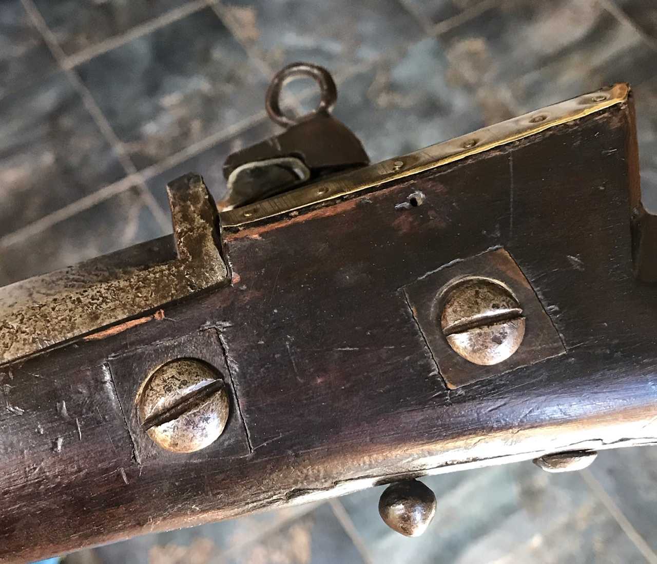

Posts: 97

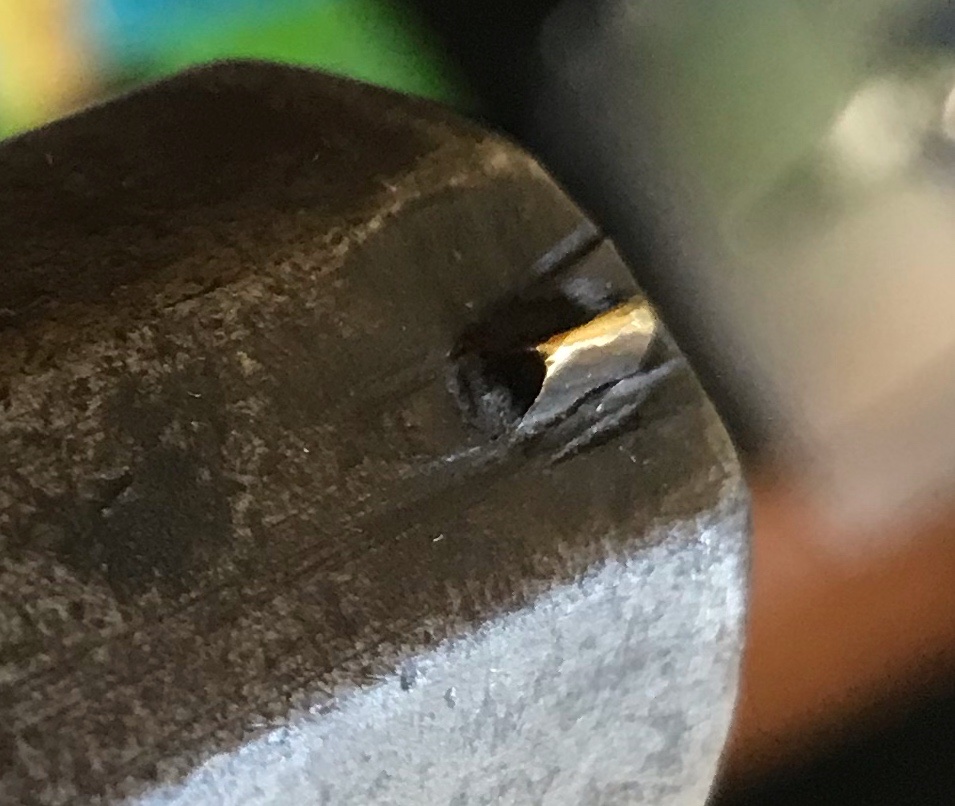

Originally Posted by Kubur
...As I said the rifles from the Balkans are very well known, the boyliya in Bulgaria is probably the most similar to your gun... Can you post a photo of the sight?
While I have no reason to doubt you, I have seen this "shishane" type in Bosnia (where I know the Dzeferdar was more common) Montenegro (where the Tancica was more common) Bulgaria (where the Boyliya was more common) Kosovo, Romania, Serbia, etc. But of course these could be captures/leftovers/personal rifles of Turks and there certainly was a widespread gun trade.

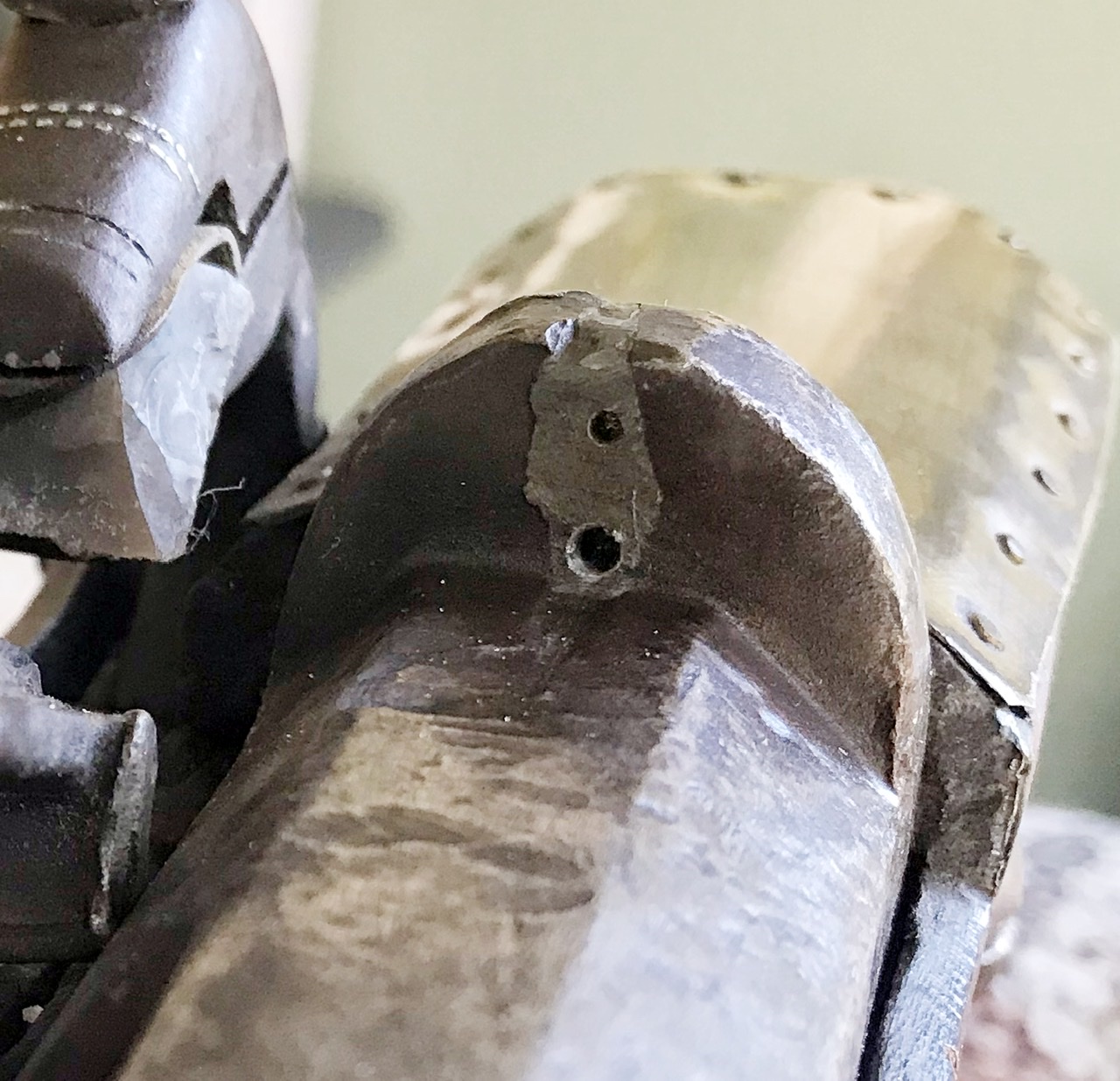

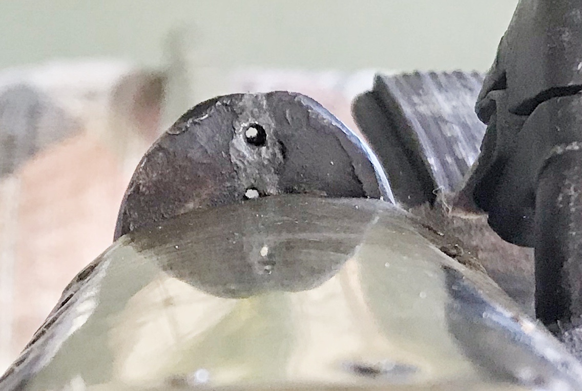

Attached are the sights of my rifle. Any idea of when the "peep" sight became more in fashion for these over the more western barrel notch sight? I've seen both types used on these but the vast majority have been the peep hole. From the wonderful collection in Vienna I rarely recall any "standard" notch sights on the shishanes they had.

Hi Cyten
That's a nice looking Ottoman Shishane. Likely made at one of the many gun making centers in the Balkans. Probably first half of the 19th Century.
The Damascus barrel with the 2-point rear sight look very common Turkish. The 8 groove rifling is the most common I've seen on these rifled barrels.
The lock is very common Turkish. (glad you got it working again) Even the pattern of the silver mounts. The mainsprings in these locks are very strong (a bit too strong in my opinion). But they are all made this way.
I think the brass cover over the barrel tank is also a replacement. But a full or partial cover in this area is also a common styling feature with these guns.
The round sling rings are likely a 20th Century replacement. But they look good on this gun. LOL
There is actually a Thread about a year ago on this Forum that showed the correct way a leather sling was attached to the two slots with a clever knot.
I think I saved the pic on my other lap top. So I will locate it and post here.
Thanks! Yes, it's very worn, wouldn't want to make a suggestion. Someone might be able to read it with the aid of a magnifying glass

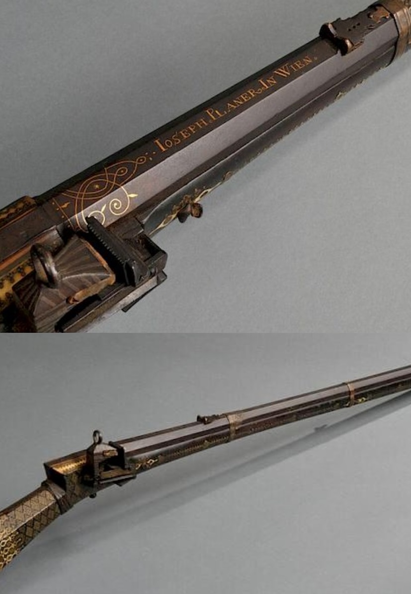

I've come across several articles from Bulgaria stating that (in Bulgarian) the town of Sliva was a major manufacturer of (specifically) shishane rifles, no mention of boyliya.
I also came across this shishane with the barrel marked by a maker in Vienna!
