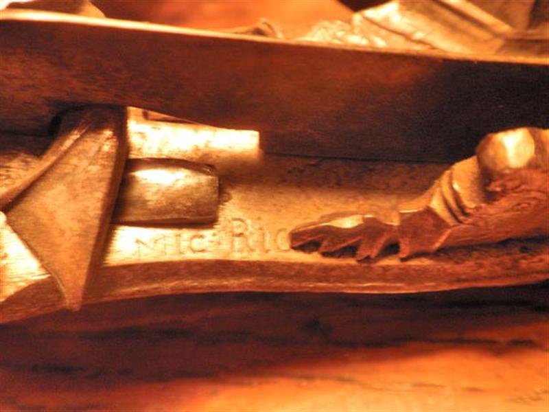

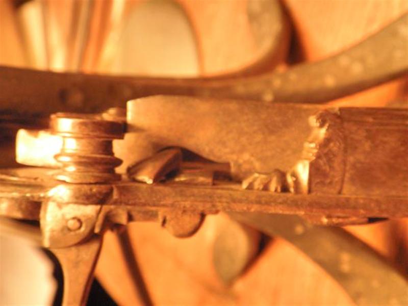

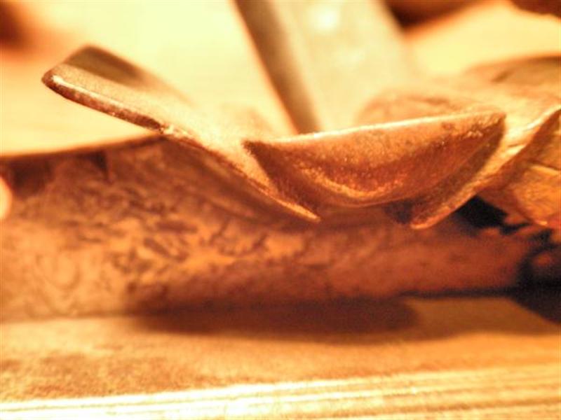

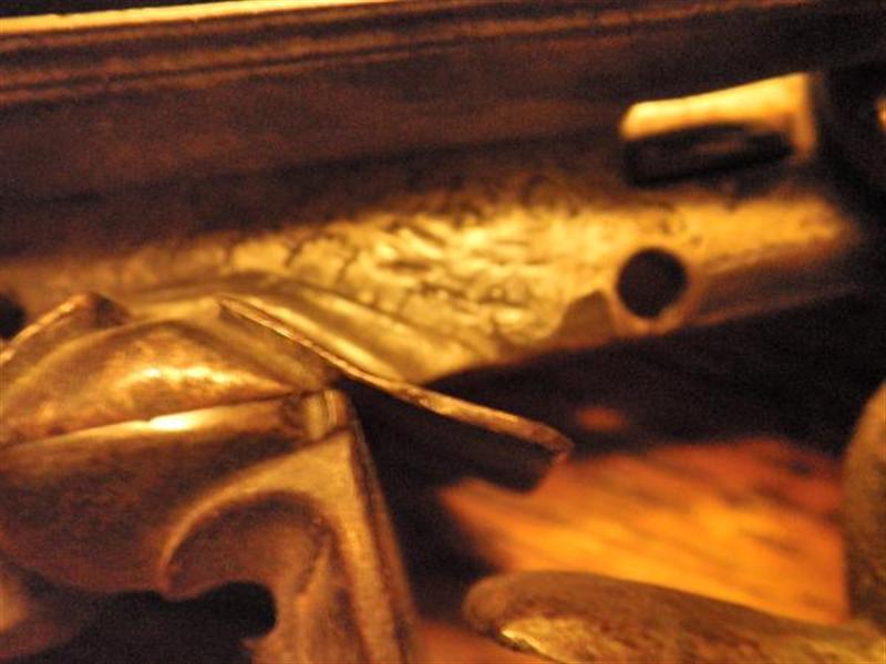

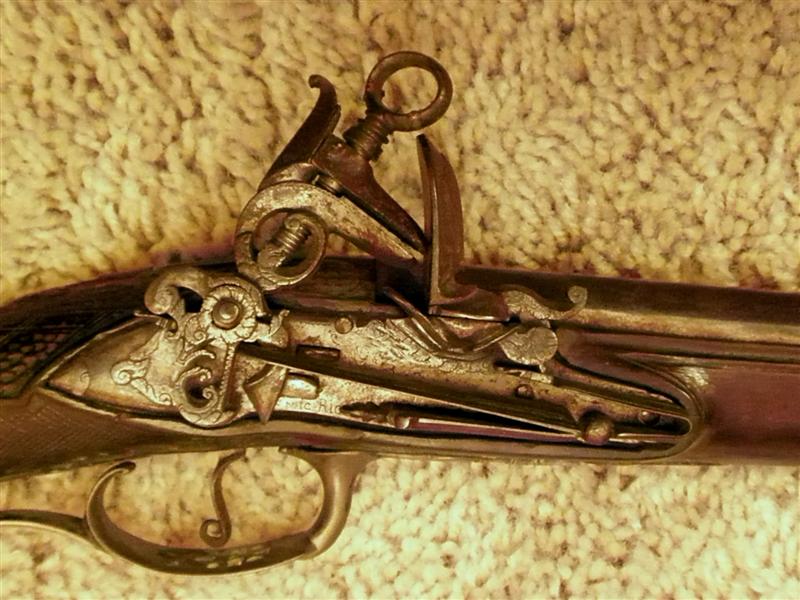

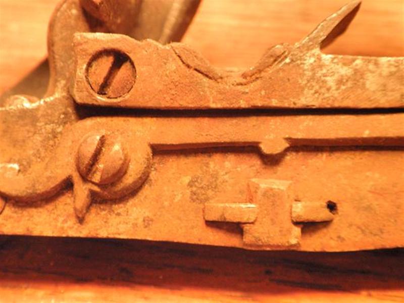

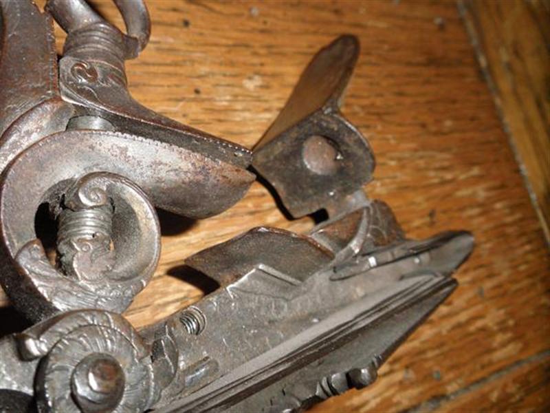

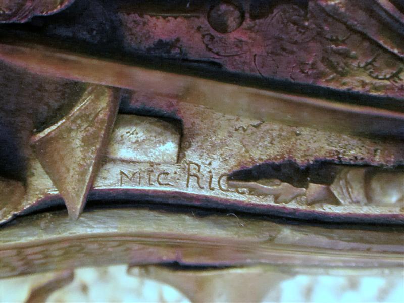

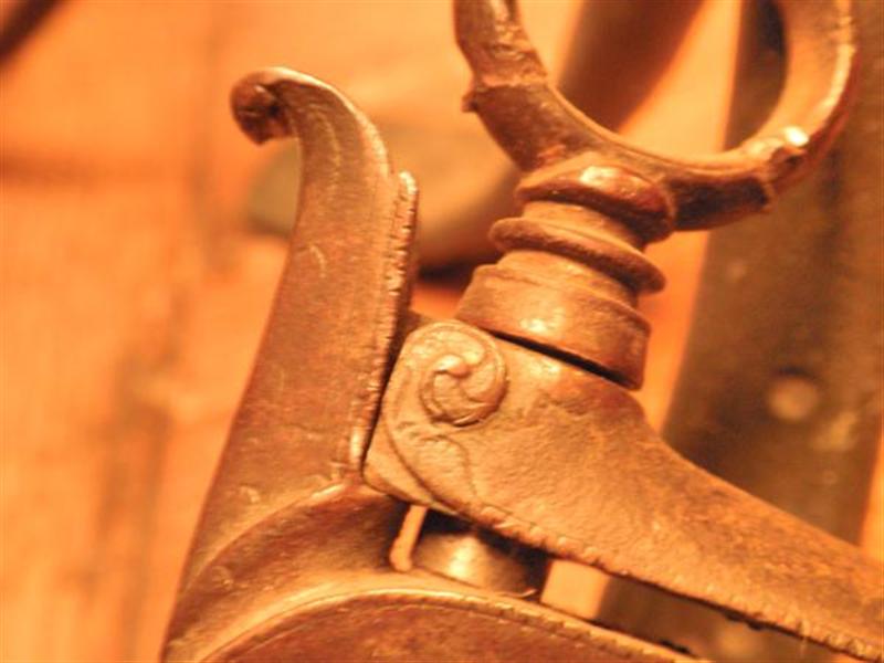

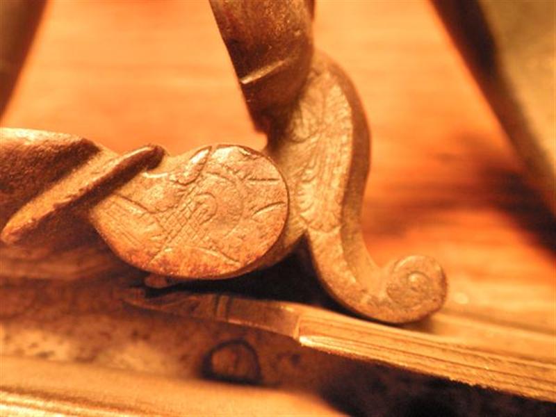

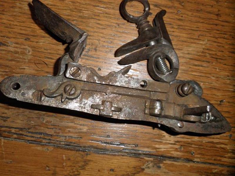

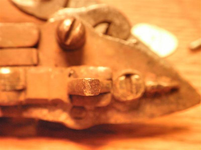

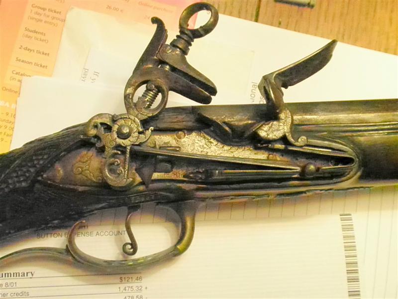

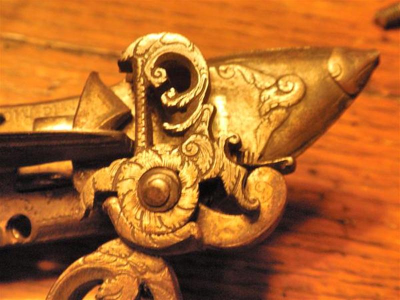

Hello all. I'm doing this for a friend that is not a member of this Forum - yet.
The photos are of a Spanish miquelet lock on a fowler he owns (wish it was mine ). To me, this is a turn of the 19th Century lock. The rest of the gun looks the same. Can anyone make out the name on the lockplate? Strangely, the frizzen spring seems to be covering up part of the name. Thanks for any help. Rick.

Hi Rick,
I confirm your dating of the gun although the scrolled trigger and the curved lower outline of the lock seem to suggest a date of the late 1st half of the 18th c.
I referred to all my gunmakers names sources but cannot see a chance to identify this special signature without taking off the frizzen spring.
It is not as unusual as you may assume to find lock signatures partially covered by functional parts as the lock plate was signed before the assembling process.

Hi Michael. Thanks for your response. OK. Yes, maybe last half of the 18th Century. I'll get him to photo the entire gun. And, I'll see if he can remouve the frizzen spring. OR, better yet, send the gun to me and I'll remove it Rick.

Hola, Rick
La llave (lock) es probablemente una llave (lock) construída en Italia, con influencia de la llave (lock) "a la Romana" (roman lock) y de la llave (lock) de chispa clásica (flntlock). Sería lo que los españoles llamaban " a las 3 modas".
De llave (cock) "a la romana" toma la disposición del muelle del rastrillo (frizzen), que está situado delante del resorte Hola, Rick
La llave (lock) es probablemente una llave (lock) construída en Italia, con influencia de la llave (lock) "a la Romana" (roman lock) y de la llave (lock) de chispa clásica (flntlock). Sería mayor y no queda oculto por la brida (bridge) de la cazoleta (pan) que en el miguele (miquelet) clásico es postizo.
De la llave de chispa (flintlock) toma la brida ( bridge) del rastrillo (frizzen) que es fijada a la cazoleta (pan) y no postiza: y la mandíbula superior, que no tiene apendice que se introduce en la mandibula inferior o en el cuerpo del gatillo (cock), sino que corre en la su columna.
El método de disparo es el del miquelete clásico.
LAVIN , en su apendice, pagina 239, trae la tarifa fijada para una llave (cock) "a las 3 modas": "Plantilla con el estribillo en la cazoleta"
También algunos armeros españoles fabricaron esta llave.
Afectuosamente. Fernando
Hello, Rick
The Key (lock) is probably a key (lock), built in Italy, influenced by the key (lock) "to La Romana" (Roman lock) and key (lock) classic spark (flntlock). It would be what the Spanish called "fashion at 3."
Key (cock) "to the Roman" takes the provision of spring rake (frizzes), which is located opposite the spring Hello, Rick
The Key (lock) is probably a key (lock), built in Italy, influenced by the key (lock) "to La Romana" (Roman lock) and key (lock) classic spark (flntlock). Would be greater and is not hidden by the flange (bridge) of the bowl (pan) in the Michael (Miquelet) classic is fake.
From flintlock (flintlock) takes the clamp (bridge) the rake (frizzes) which is fixed to the pan (bread) and not fake, and the upper jaw, which has no appendix that is inserted into the lower jaw or the body of the trigger (cock), but runs in his column.
The shooting method is the classic Miquelet.
Lavin, in his appendix, page 239, bringing the tariff set for a key (cock) "at 3 fashion": "Talk with the chorus in the bowl"
Also some Spanish gunsmiths produced the key.
Sincerely. Fernando
Old 19th September 2011, 06:44 PM   #6
I have contacted a Spanish specialist.
His impressions coincide a lot with those of Fernando K in that, this lock may have been made in Italy.
Even the way the mark is engraved on the plate doesn't look like a Spanish work, neither its initials sound Spanish.
Although the mechanism complex looks interesting, the finishing reminds the 'easy' way of a (Spanish) Colonial example.
Fernando K is more precise in detailing this lock system ... pass the rough translation. The system called 'a las tres modas' (three fashions) is a fusion of 'a la Romana', classic flintlock and Miquelete, as this example appears to be.

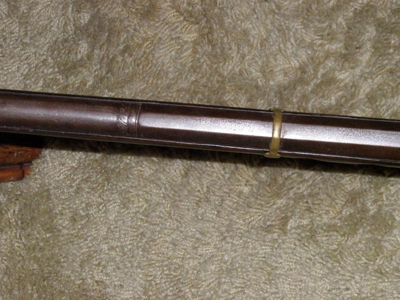

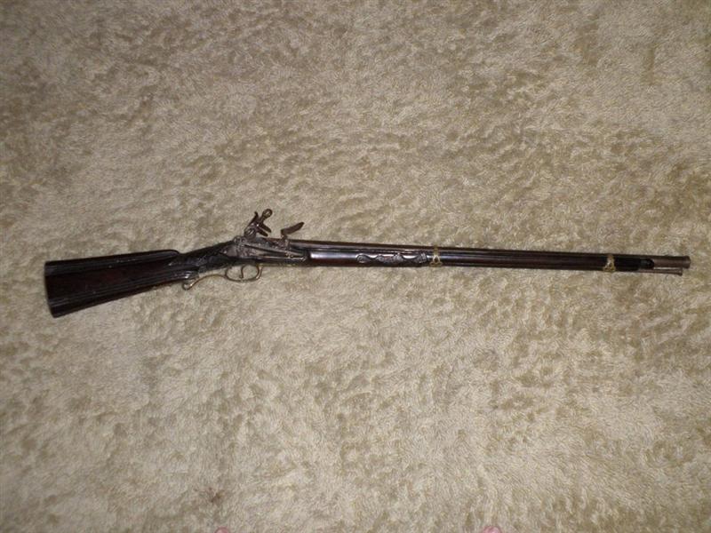

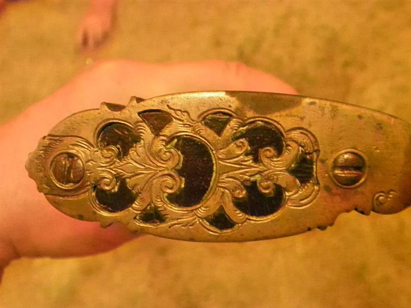

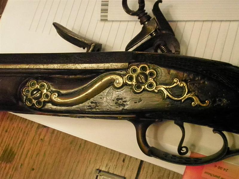

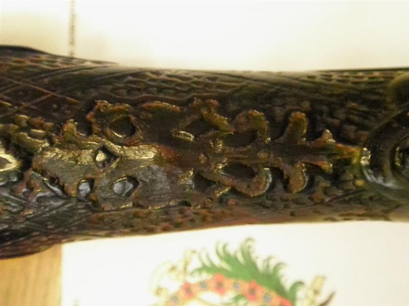

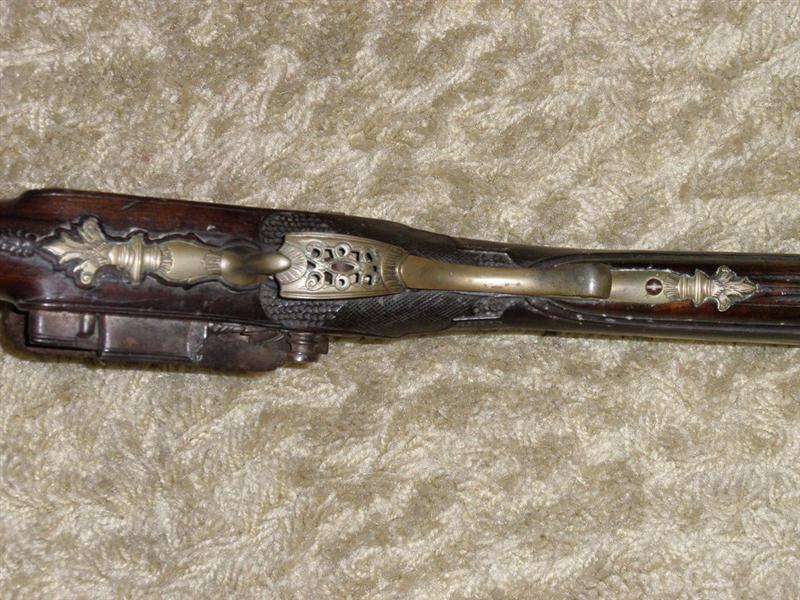

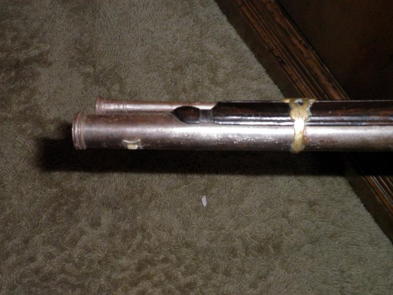

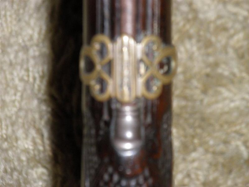

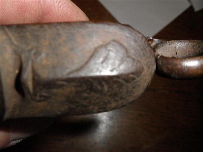

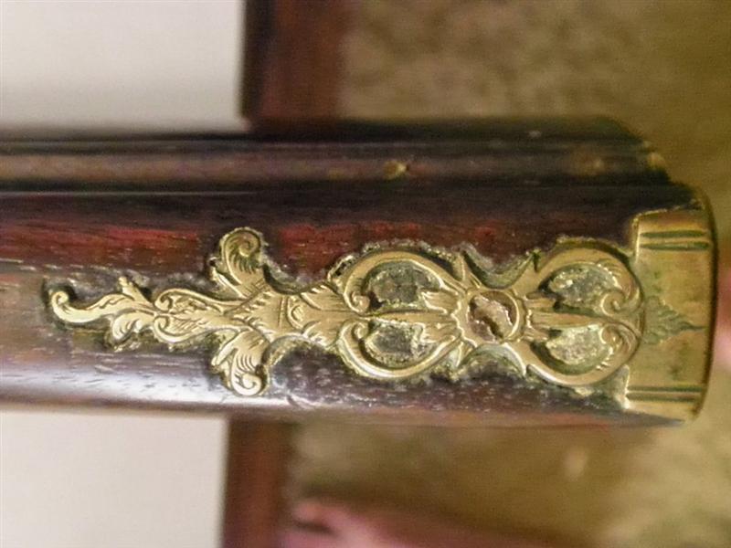

Hello Fernando and Fernando K !!! Thank you for your responces. Attached are some additional photos. This gun looks both Italian and Spanish - at first glance. The overall stock architecture and barrel bands look Spanish. But, yes, I see the Italian influences elsewhere. Same with the lock. And, good point: The signature "style" on the lock does not look Spanish. Wish I had this gun to study and take better photos. Rick.

Quite intricate detail work ... as with the lock.
But again, the finishing is not top class ... don't you agree?

Yes, I agree. Maybe it's just the photography, but it looks as though some of the brass castings were not finished very well? Too many "burrs" left on the metal. I know he is out of town at the moment. I hope when he returns he'll remove the frizzen spring so we can have a better look at the lock signature.
Hmmmm, maybe I can talk him into sending the gun to me?
I would sure like to study it further. Rick.
