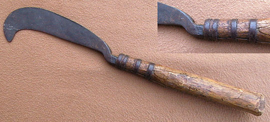

Mark has posted on these a couple of times also. You can see some folks carrying them in the picture on the first page of his site http://dharesearch.bowditch.us/
And there are some threads on here about them so I am sure there will be more answers comming
Old 1st November 2005, 01:54 PM   #4
Andrew
Andrew's Avatar
Location: USA
Posts: 1,725
Cool

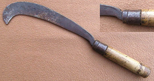

It's a mak, used by various peoples across continental SEA. At one time a battlefield weapon (see Mark's site as recommended by JT), I suspect these are now primarily agricultural tools.
I've seen fairly well-made and ornate examples (one was offered by Oriental Arms at Timonium last year--perhaps the owner will post pictures), but the ones I have are somewhat crude, but quite effective.

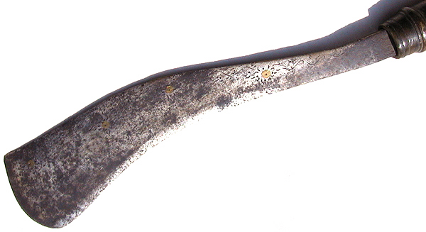

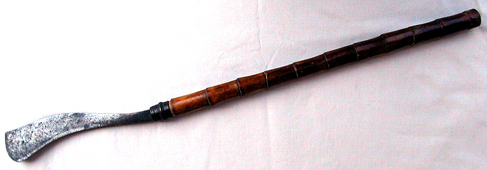

Default And this is the chopper ...
that Andrew referred to that was purchased from Artzi Yarom in Baltimore. The blade has an inserted edge, as well as brass inserts in the blade and along the spine. The handle is bamboo or rattan. Probably late 19th or early 20th C. Judging from the decorations on the blade, most likely from a hill tribe in northern Thailand or Laos.
Blade is sharpened along the inserted concave edge as well as the broad end. Overall length 30 inches.
Ian.
