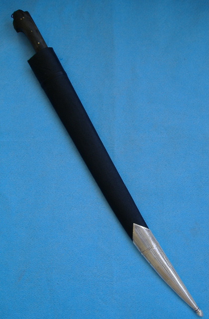

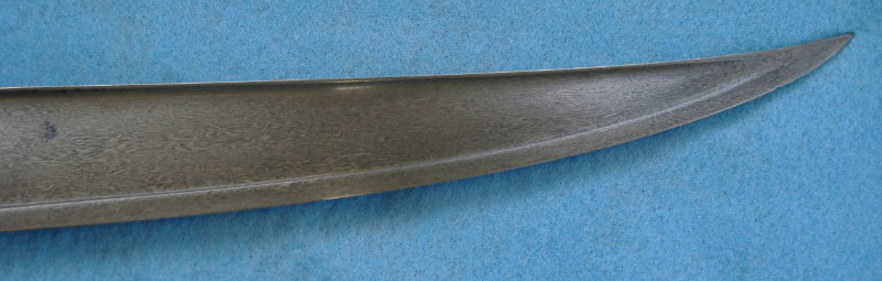

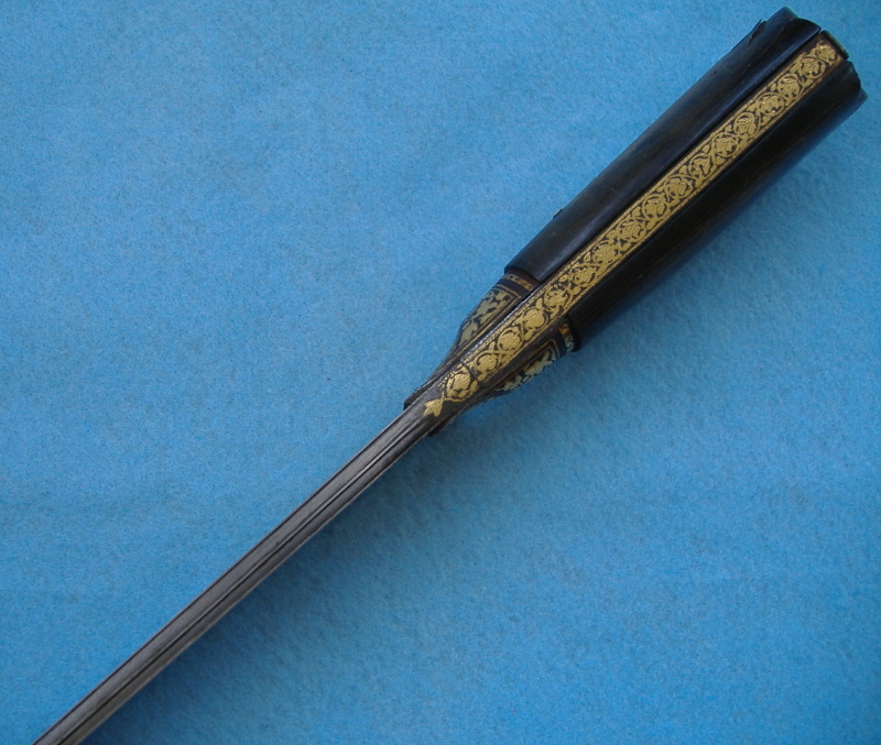

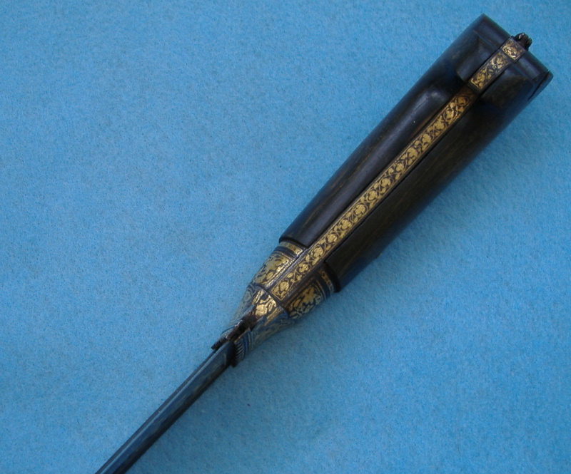

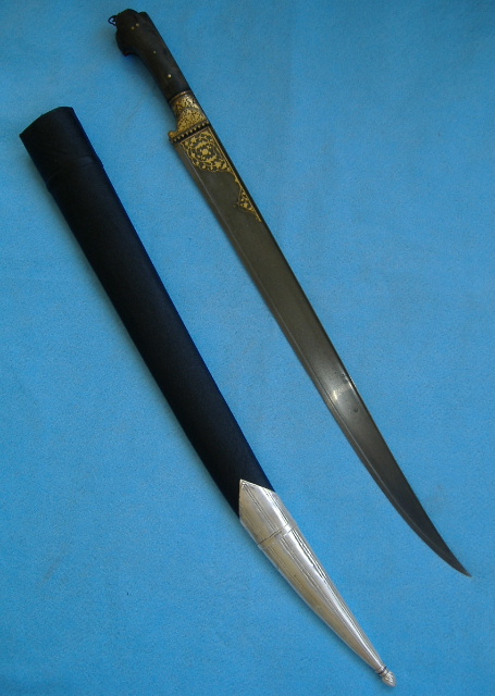

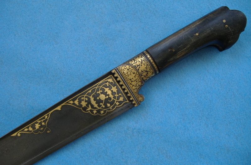

I was fortunate enough to just pick up this example of what we generally call a "Khyber Knife", but also known as a Salawar yataghan. I have known of its existence for some time and have always been curious about some of its unique features, such as the extraordinary quality of the wootz and koftgari. Also note the slightly upturned tip and reinforced edge. This is certainly better than normal quality and makes me wonder if it is, indeed, Afghan?? The wootz certainly speaks to Persian quality. I think there could also be an argument made for North Indian origins. The hilt scales are dark horn with a slightly greenish tint. The scabbard here is a replacement and has been done in a traditionally Afghan style.

That is one beautiful Seylaawa (that is what we call them). The hilt does not follow the normal hilt style of a seylaawa, the blade follows the norm all the way to the tip and then it becomes a bit unortodox. The wootz pattern is great and the gold inlaid kandankaari seems to be Kabuli. The hilt design looks suspeciously Bukharan, and the quality of work IMHO moves it far away from Khayber area and closer to Kabul. I'd say mostlikely it was made in Kabul by a migerant smith from North of Amu River.

The spines on the back of the blade remind me of shamshirs I have seen from Turkmenistan, and the Persian influence goes hand in hand with Bukhara. Gorgeous wootz!!!
All best,
I was thinking the same of the ribbed spine, with the Persian influence. You see that in the higher qaulity shamshirs here the style wrongly called palowars.

To my eye there are many Turkish/Ottoman aspects to the designs, shapes of parts and fullers on the spine...many similarities to a number of Yataghans found too...

Salaams, If you give send an e mail as I think I know the koftgari workshop this came out of ...in Kabul. I was there earlier in the year and discovered it. Regards,
