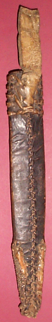

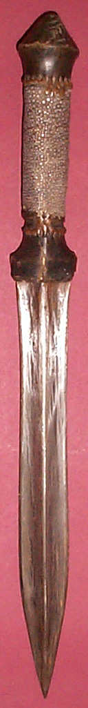

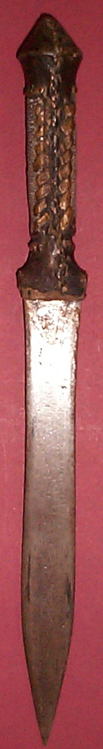

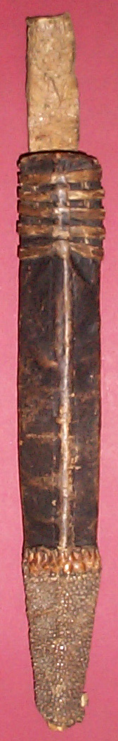

Hi All,
Given the decoration on the sheath, I believe this small dagger to be African but I've never seen a blade like this nor have I seen the use of shagreen on an African piece. Overall the dagger measures 10 3/8" (26.35cm) with a blade length of 6 3/8" (16.19cm). The small but robust blade is flat on one side and has a strongly raised rib on the other. To accommodate the blade, the sheath has a triangular cross section. There is shark or rayskin on both the hilt and sheath. Can anyone tie this dagger to a specific group?
Sincerely,
RobT

Very interesting having a mid rib on one side only. I have been looking in some books and although I cannot find an exact match, I feel this knife is probably Tiv from Nigeria, the same blade form is seen in their all metal loop daggers, if not Tiv then from that area of Nigeria and Cameroon borders. Tim

I agree fully with Tim.
The use of shark skin could indicate that this dagger originates from a place near the coast where this type of product could occur more easily.
Interesting dagger.

Tim and Freddy ,
Tiv (or Tiv related) sounds plausable to me. They would have ready access to shark and rayskin from the Atlantic. I should have picked up on the leaf shaped/center rib similarities between the Tiv loop dagger blade and my wife's blade. Thanks for pointing it out.
