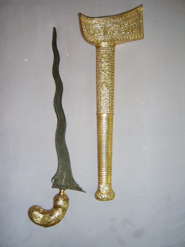

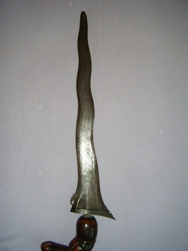

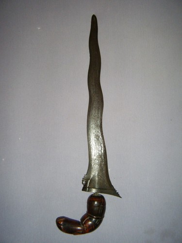

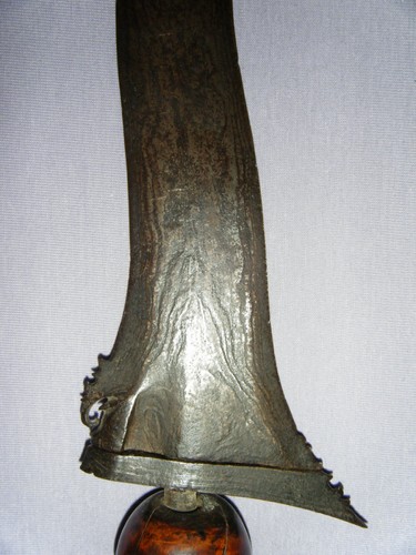

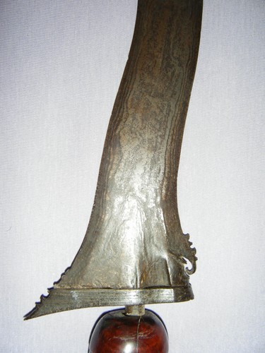

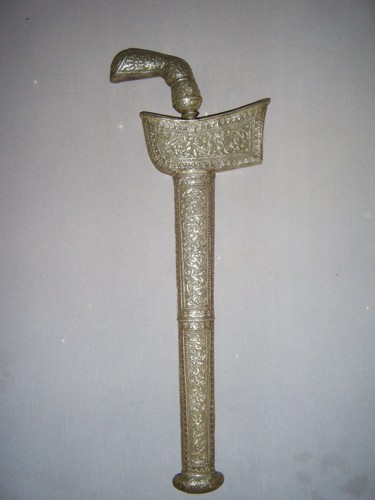

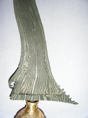

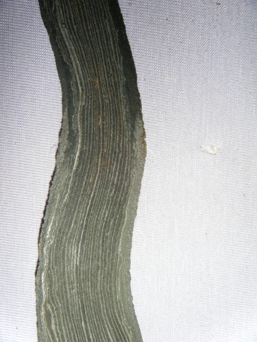

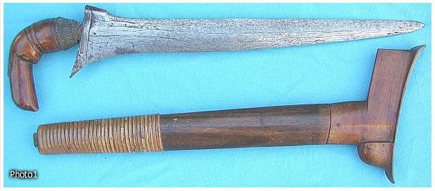

I have bought some time ago this old Bugis blade with 7 luk. Since I think this blade is worth to get a "house" I looked around what I have. I am unsure if the sheath and hilt is fittingly. Here first the pictures from the blade.

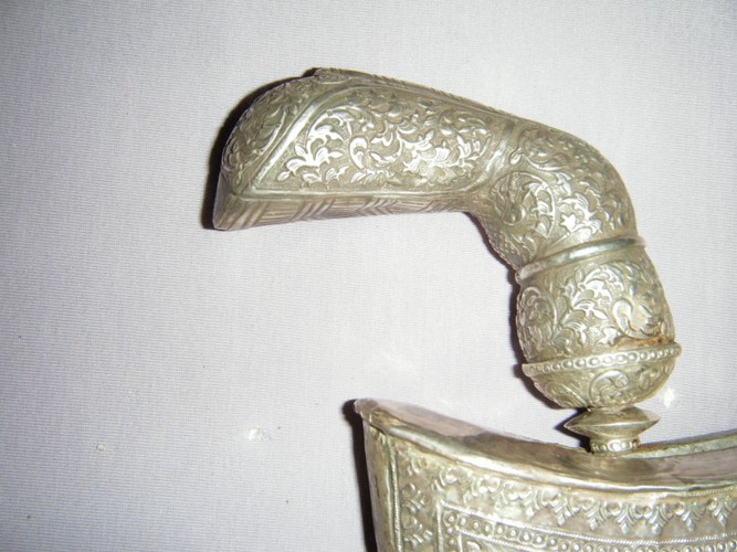

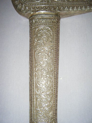

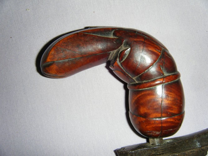

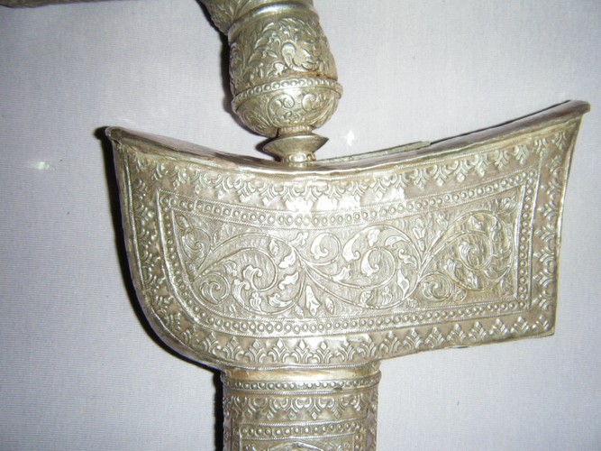

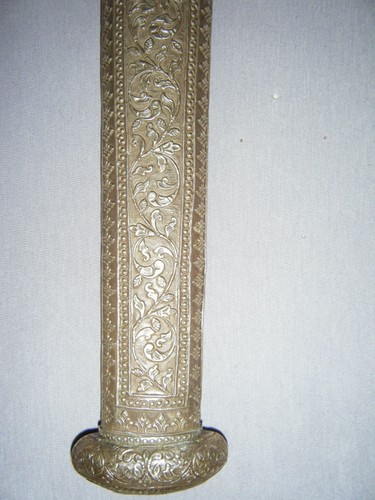

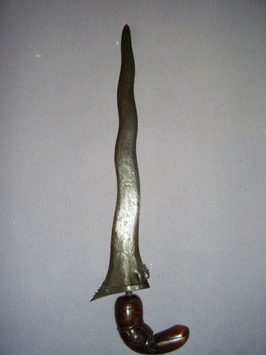

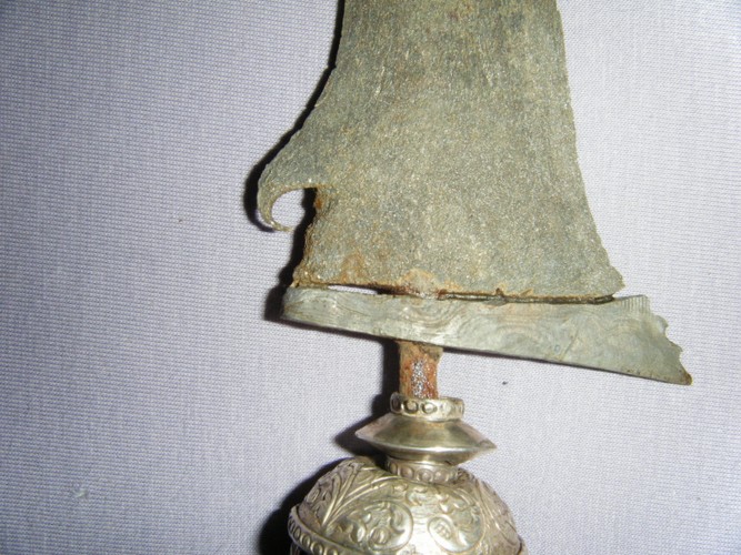

And here is the sheath and hilt which I have already long. There is a blade inside but this one is completly worn out and have cheaply carved refund gonjo.
The sarung is in IMHO an old one and worked from thick silver sheet over wood.
It will need some work but I am sure that it will be possible to get a nearly perfect fit.
What do you think, is it adequate?
Thank you very much for your opinion,

Hi Sajen,
From the sheath and blade, looks like a Sumatran Bugis keris.
I've always doubted the age of the full silver sheath Bugis kerises. I thought they were a Javanese manufacture.
What you need is a sheath like this:

Sorry, forgot to mention the photo was from Liongate. Couldn't find another photo of a Bugis keris from the same region.
Old 26th June 2011, 04:39 PM   #5
Posts: 9,757
Originally Posted by BluErf
Hi Sajen,
Hello Kai Wee,
thank you very much, your knowledge in this area is welcome.
I get both not together, the sheath from silver and hilt is already long in my hands. The blade I bought recently. It has my feeling also that the blade is Sumatran Bugis, but only from the shape of the hilt I have had this feeling.
Of course I can't say for sure that the sheath is old but I get it heavily patinated with this poor blade. And what I am able to say is that I have a second keris with silver sheath (gilded) where I am sure that it have a good age. But I have no knowledge if there have been sheath's like this.
But what have been my main interest was if blade and sheath are matching and I understand from your comment that you don't think so.
Thank you,
Sajen is online now   Reply With Quote

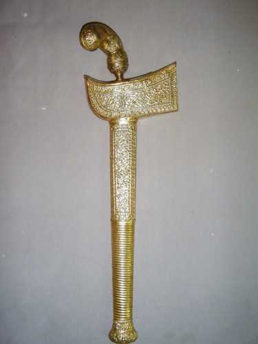

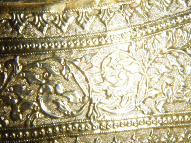

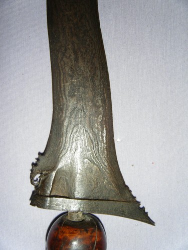

Here is the above mentioned keris. I have thought many years that the sheath is from brass until I get the idea to clean it carefully with soap and a tooth-brush. Regarding this it would be from great interest if there have been old sheaths like this or not.
Old 26th June 2011, 06:04 PM   #7
Posts: 7,397
Sajen really like that blade of yours on this last keris. Great pamor............
Is the dress gilt silver?
Old 26th June 2011, 06:39 PM   #8
Posts: 9,757
Hello Jose,
thank you. Yes, the sheet is gilt silver.
