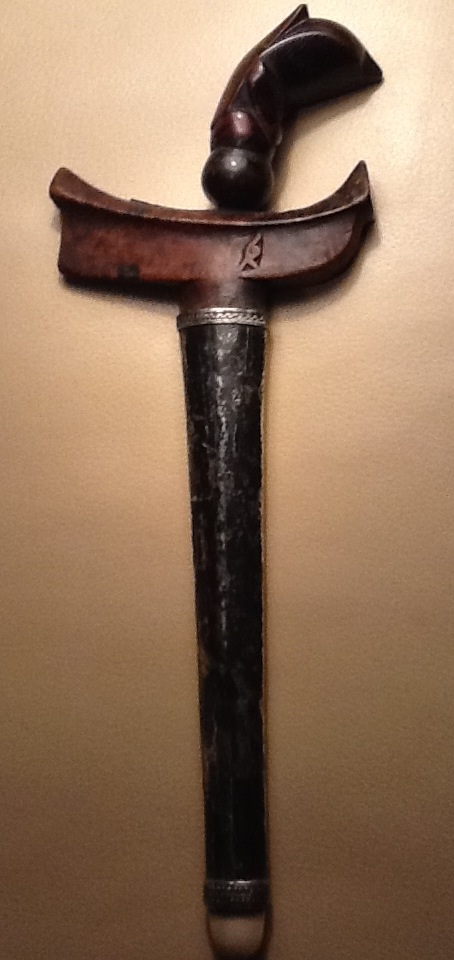

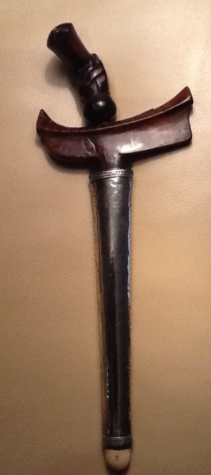

Hello ,
After months of not being bussy with my collection I have sine yesterday a new keris in my home .
But i hope someone can help pointing me in the right direction for the origin of this keris . I have problems to see of it is à keris from Sumatra or from Malysia ?

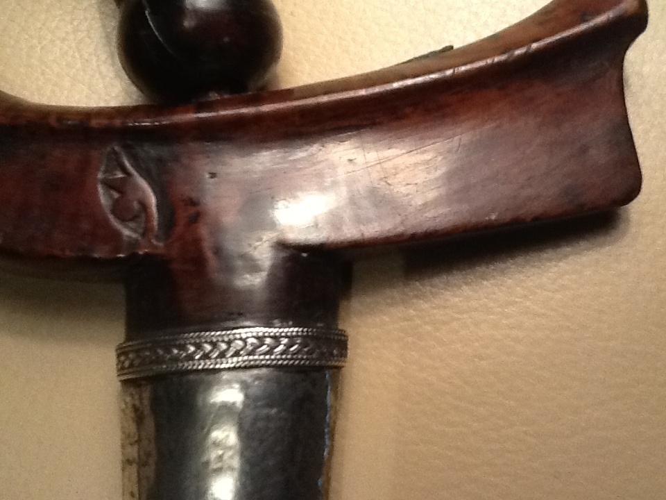

And I have my doubts about the pendok , the pendok does not run op till the under part of the waranka . Or is this something that can be common ?
The pendok and the sheat have some age when i look at the patin , i cleaned one side of the pendok and it seems to be silver .

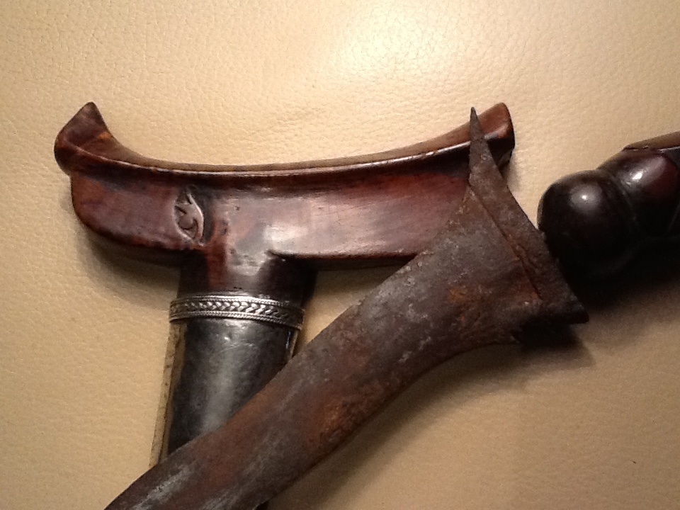

The pendokok is missing and the blade is in à bad condition , i have to clean it first.
There is à carving in both sides of the waranka , maybe it can help to find out the region .
The photo's are bad because I take them with artificial light.

Hello Danny,
Well, your pictures are already a lot better than those taken by the seller.
If he had posted these pictures I would have taken a shot at it as well.
My first thought is "Gayo".
But...
There are a few odd things.
- the ivory buntut. maybe a later replacement ??
- the floral decoration on the wrangka, maybe added on Borneo ?
- the hilt, jawa demam, but not very Gayo in style.

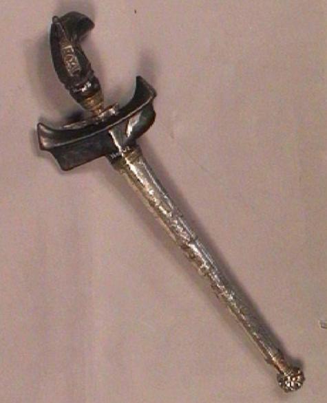

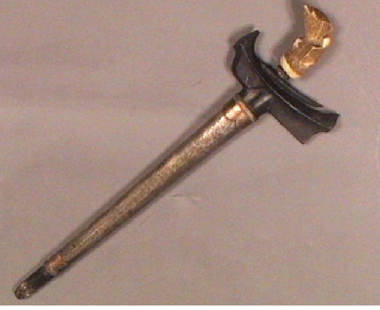

Here a few pictures of gayo keris from Museum collections.
As you can see, the pendokok not running upto the wrangka is absolutely normanl for this type.
Ps. don't overclean the blade. If this ensemble is Gayo, the blade will not be very special and this is the normal state for them to be in. It is not a javanese keris

Hi Willem ,
Thanks for answering , I also have the idea that the buntut Could be à replacement but if it is it happend à long time ago but maybe the sheat was ment to be like this . If we look at sewars from Gayo we can find also this kind of ivory "buntut"
It wassen't me that did buy the keris from the seller , but it is mine now .
Don't worry About the blade i will not stain it but i will remove the biggest part of the rust to protect the blade.
My thought was also going in the direction of Gayo but not sure yet , especialy because the info from the seller ( no collector ) is that this keris was à gift from a malysian friend long time ago.
danny1976 is offline   Reply With Quote

Hi Danny,
nice to have you back here! Very nice small keris. Agree with Willem, look like a Gayo keris because the pendok, only other posibility would be Minangkabau but the pendok and buntut are untypical for Minang. I am as well would remove the corrosion from the blade.
Anyway, nice addition to your collection.

I am looking forward to pictures of the complete blade.

Hello Danny,
I agree with others that this interesting kris seems to originate from Northern Sumatra but the carvings on the sampir and the style of buntut may indicate a Batak influence? The hilt is from East Sumatra or Malaysia so in principle it is not matching with the kris.
