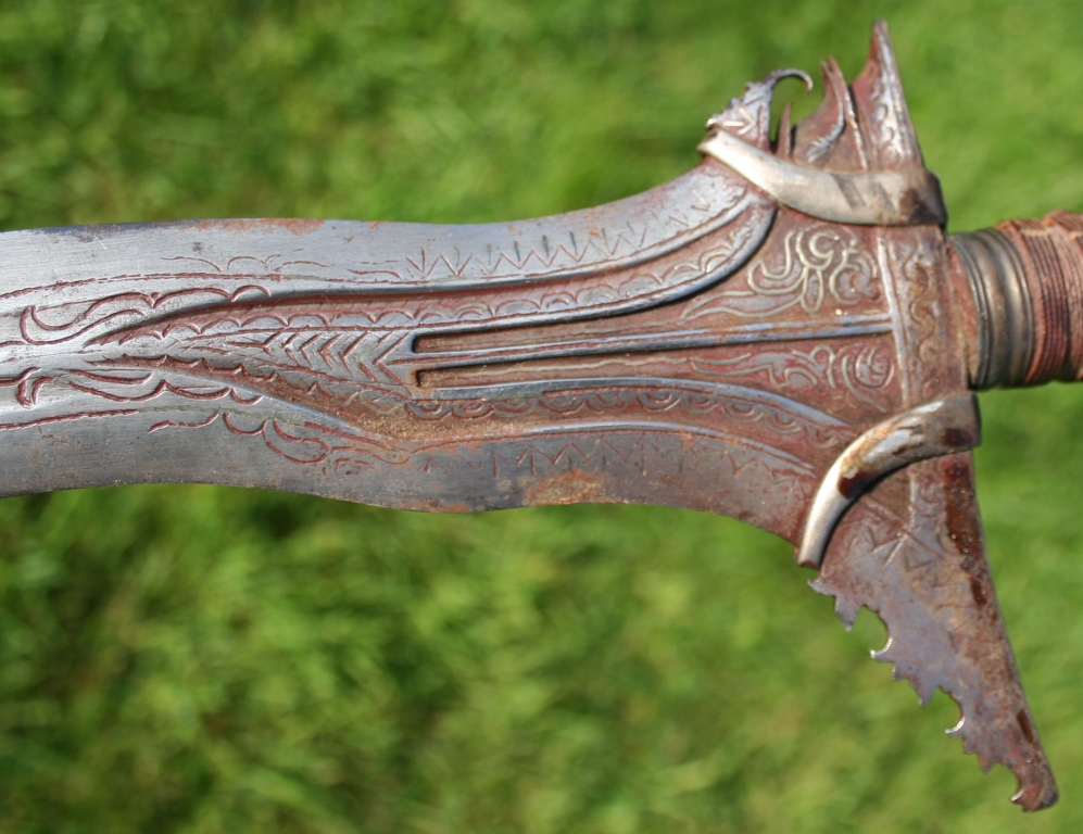

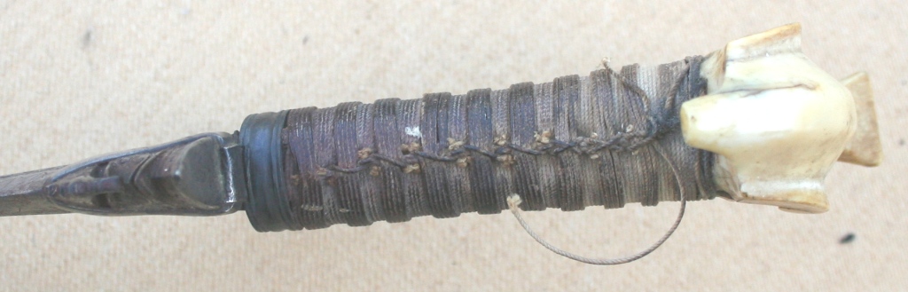

I have had this one for a while now without doing anything to it.
I would be greatful for suggestions on origin and for cleaning.

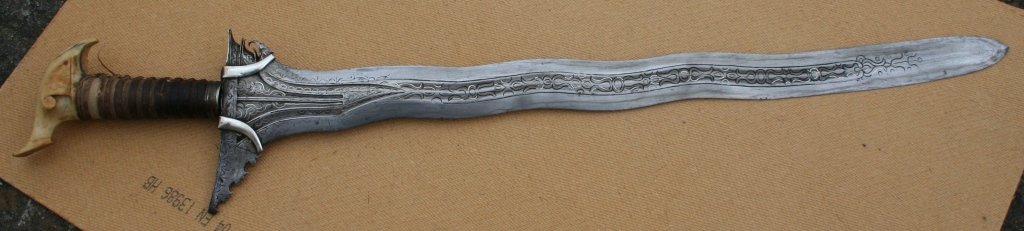

Length is 62 inches. blade is 52 inches.
Pommel apprears to be bone. Stirrups appear silver.
The brown discolouration appears to be dried oil.
As usual, all suggestions and comments are welcome.
Thanks
Roy

Very nice Roy,

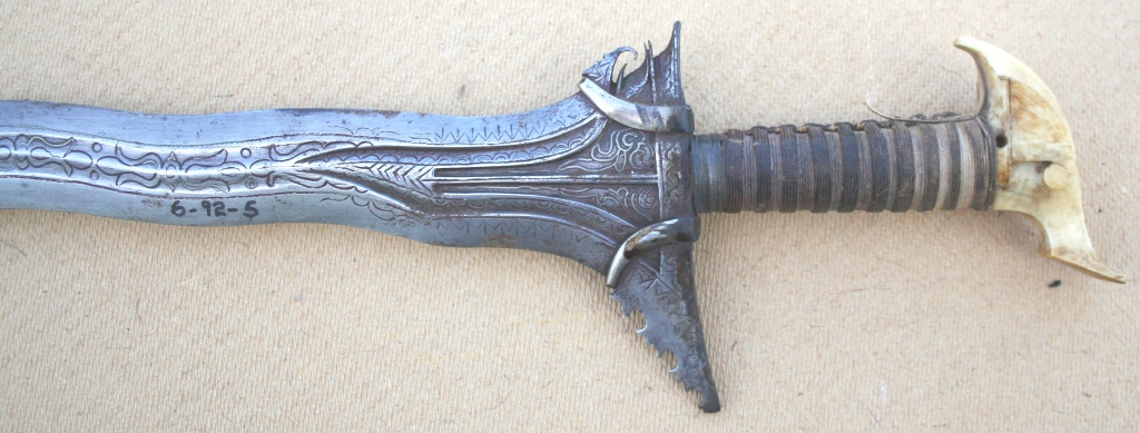

Pommel looks like Ivory from the grain.

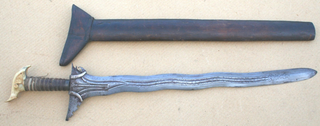

VERY NICE Sulu kris, though the scabbard throws me a little.

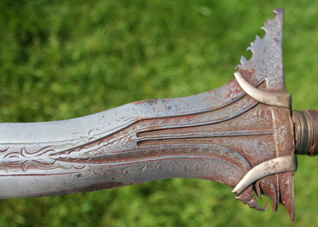

My biggest concern would be the active red rust - take that off first.
Old 5th October 2011, 08:58 PM   #5

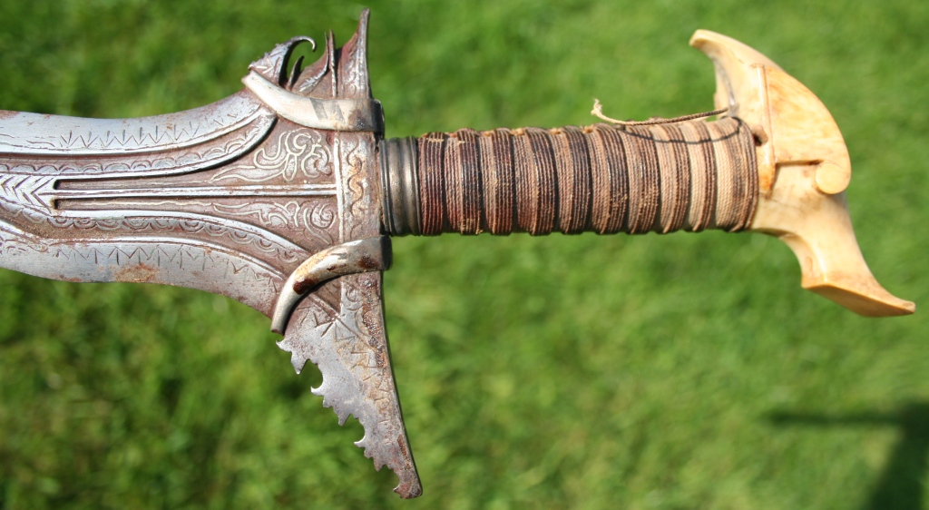

Congrats, Roy, that certainly is a nice one! Did you get it out of the US?
The scabbard is a late replacement. I'm sure Jose can make a suitable one for this beauty.
I agree that the rust needs to be removed. However, in this case this needs special efforts not to loose the remaining inlay (seems to be silver). I'd suggest to remove as much rust as possible by very careful picking in the engraved lines with already missing inlay (start with wooden picks and use fine iron pins if needed - avoid scratches from steel needles though); also use very fine steel wool for cleaning rust off the blade surface (take care around the katik/gangya area to evenly clean everything including - as much as possible - hidden crevices since you won't be able to disassemble the asang-asang).
Once the blade looks almost clean, I'd give it a fine polish and continue with quickly staining the blade with hot vinegar (applied and rubbed in with a tough brush) which will also remove rust in tiny crevices, especially around the inlay. Even if you're really careful, there's still a good chance that some of the inlay may come off. However, this can be reapplied (take before and after pics to help solving the puzzle).
You could also apply lacquer to protect the inlay (can be removed again later) but this would also protect any remaining rust and IMHO more risky in the long run. You may want to use this for protecting the surface of the asang-asang, the ferule, and the silver covering the katik though.

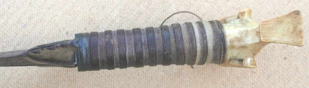

BTW, the hole in the right-hand side of the ivory pommel probably once had an ivory peg securing it to the wooden core of the grip (this is usually a bit more hidden under the wrapping - just my best guess). Try to find a suitable piece of old ivory to replace it if possible.

I agree with the others that this obviously an above average datu piece displaying great Sulu craftmanship. I'm not sure it's older than, say, turn of the century though:
Does it have a seperate katik? (Is it the line ending at the upper asang-asang? An odd position - if tough to tell, the laminations will reveal more after staining.)

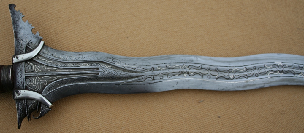

Open question to Jose, Kai, et al... what is the significance of the arrow motif (engraved on either side of the fullering running beyond the stirrups onto the gangya)? Or are those even arrows, i.e, are they simply stemmed zig-zags?
A good question. Not sure. Cato in his book Moro Swords says that they are arrows but does not clarify their meaning. All he says is that they are on datu pieces (and I choose to believe him based on what I have seen so far).

beautiful kris, congrats. What is dried oil and what is rust? Would be much better when the engravings only have this oil inside and no rust. Much more easy to clean.

A polishing compound/paste (e. g. as used for strapping razors) comes in handy. I'd recommend to try a fine compound first after thorough cleaning - if you can live with a speck or two on a blade, this is often enough (takes a bit of elbow grease - no power tools!). If you wish to remove stubborn corrosion, you'll likely need coarser stones or sandpaper (both lubricated with water or oil) and lots of effort (knowledge and experience, too). I'd suggest to post pics first; in many cases it may be preferable to pass this job on to a professional (qualified) sword polisher.
What's the best product for cleaning ivory ?
I don't think this pommel needs extensive cleaning - most of what I can see seems to be honest patina. Water with a tiny bit of detergent will probably take care of any grime. An old toothbrush and, if really needed, some toothpaste can be used for dirt in crevices. However, make sure that you don't get any paste on the grip binding - next to impossible to remove completely.

I wouldn't "clean" the ivory either, but i would condition it. I usually use mineral oil. It "cleans" it up without removing any of the patina and gives the ivory a nice luster.
