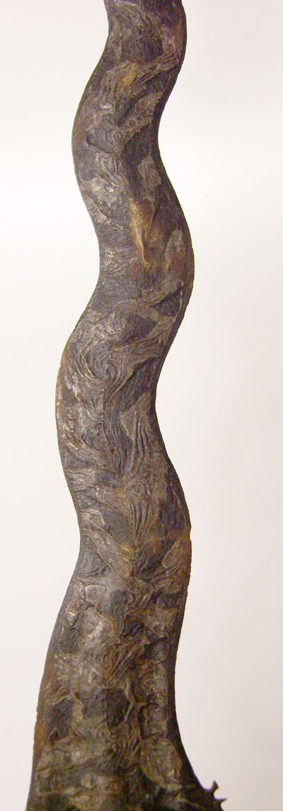

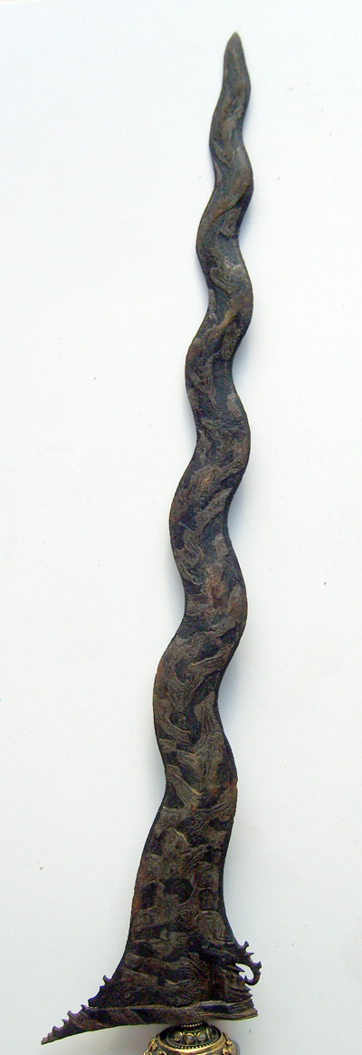

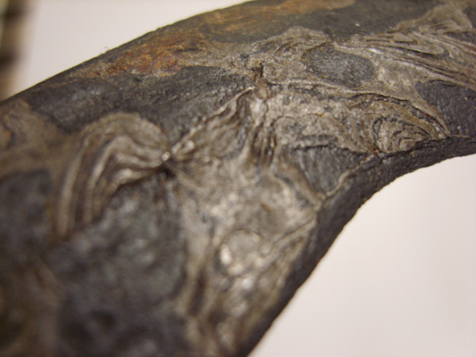

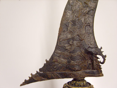

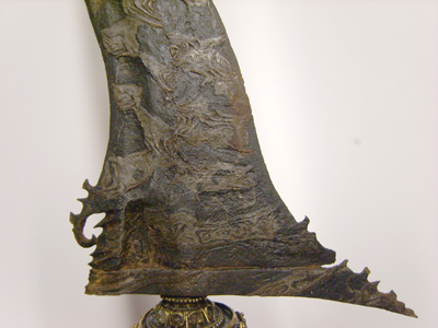

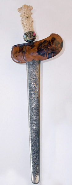

WHO CAN HELP ME TO IDENTIFY THIS PAMOR?
SOMEONE TOLD ME THAT THIS PAMOR COULD BE:
WALANG-SINUNDUK? BUT I’M NOT SURE ABOUT IT.
YOUR OPINION/ ANY COMMENTS WIL BE WELCOM,
I WOULD APPRECIATE IT VERY MUCH
THANKS IN ADVANCE

No idea about the pamor, nevertheless an exceptional blade. My compliments.
It should look even more beautiful after etching.

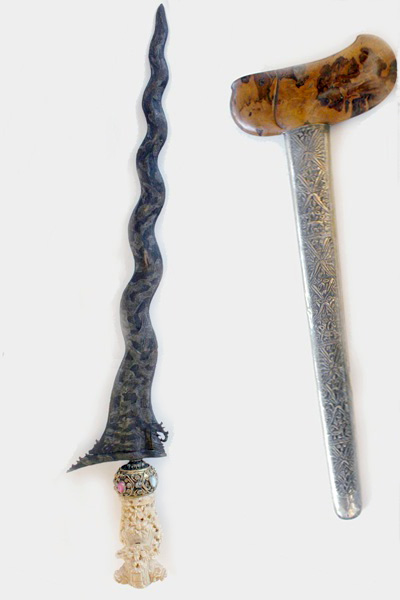

GIO, thanks for your compliments.

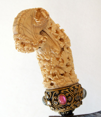

Here is a picture with his sarong.
further nobody who can tel me anything about it?

Very fine ensemble, congratulations!
Old 25th June 2011, 01:29 PM   #5

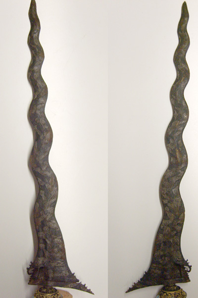

Very nice keris! Would sort this pamor in maybe to the family of lar gangsir or ron kendhuru!? The pamor seems washed out at some places.

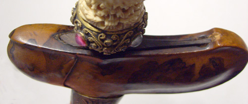

As to pamor I agree with Sajen: this could be a variation of ron genduru.
The hilt is obviously Maduran and the selut suggests me a Banjarmasin influence. In conclusion a great piece !

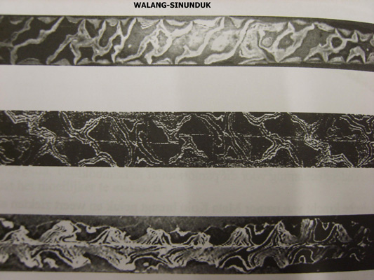

Thanks for your comment:
Quite possible, here and there the design is raised above the level of its background: “Like a carving in relief.”
One of the guess that it that it could be: walang-sinunduk comes from a Dutch book: "Pamoratlas” by: Ing.ean.Veenendaal.
Page 86 shows three drawings/pictures of: pamor walang –sinunduk
the middle one shows some similarity in appearance, but I found so far nothing else to compare.
So I am still open to any suggestions
sirek is offline   Reply With Quote

Nice keris
IMO: a kind of lar gansir. Also walang sinuduk possibile

Hello Sirek,
This blade has a very strong Madurese flavor and Walang Sinuduk is a Javanese pamor so is it applicable? The name game would say Alan?
Best regards

Old 25th June 2011, 11:27 PM   #10
Posts: 7,229
Alan would say:- dealer's montage, recent blade.
But a pleasant looking piece composed of nice individual components.

Mr. Maisey it is possible to explain why this blade is not old?
I know I ask you to do this through a photo, but I would appreciate your explanation.
Old 26th June 2011, 11:48 PM   #13
Posts: 7,229
Based upon what I can see on the computer monitor in front of me, this blade looks recent.
My opinion is based purely upon my experience and what I can see.
I am unable to provide a course in how to identify recent Madura blades, or blades from other origins, by way of the internet.
It becomes a matter of :- "if it looks like a cow, its a cow"
However, my opinion could change if I held it in my hand.

Where did you obtain this Keris ?
Is the blade a proper fit with the wrangka ?
Willem

The keris was owned by a Dutchman (I knew him not further)
But after he had passed away it came into my possession.
Later I tried to get some information such as:
- how and where the keris had come into his possession
- since when it's in the Netherlands
but unfortunately that information was no longer available
The fit is acceptable, only slightly worn out
(I do not think it’s adjusted to fit)
the pamor looks like pamor "ganggeng kanyut" ; ganggeng = algae, kanyut = drift in water
