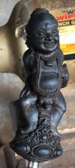

Default Balinese hulu identification
Demon, Deity?

Old 7th June 2022, 02:19 AM   #2
Posts: 6,436
Fangs?
I'd guess demon.

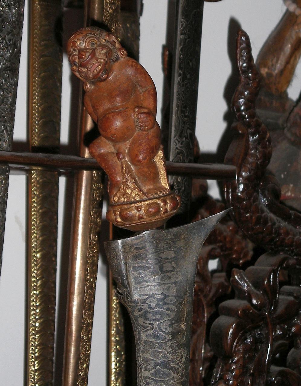

This little fellow below seems to be a relative of his.

Posts: 470
Fangs?
I'd guess demon.
Nice old Balinese keris you got there, Rick.
Btw, do you know the actual name and role of that demon in Hindu culture?

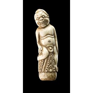

The Tropen Museum of Amsterdam has one in its collection too.
“..'Ivory kris hilt representing an evil spirit', 1800-1900, ivory, 10.2 cm height, accession number 809-219a, collection of the Tropenmuseum, Amsterdam...”
