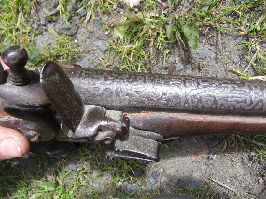

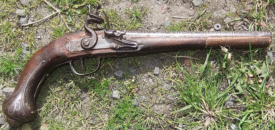

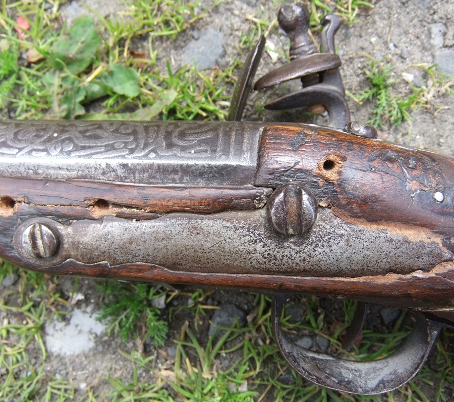

Hi all .. new to this form .. I collect and restore old English shotguns and collect old bottles and pottery .. so i set off on my usual run round the car boot sales and the last thing on my mind as i wandered around with not a item found at 6am .. then i spotted a dealer with what seamed like a "modern" Flint lock pistol screwed to a piece of floor board .. he said to the lady it was a modern copy which had been made to look old and was not worth here asking price .. when she would not budge on the price he put it back under the table .. i then picked it up and had a good look at it and it just felt right .. so a quick haggle and it was mine .. it was in a very bad state but once i had the board off it looked to me like it could date from 1840-50s if it was English .. but it was covered in an "Islamic" text .. so still not sure .. so i was wondering if someone hear can help me with the translation .. date .. and what it should look like as i am now going to strip and rebuild it .. would it be Blued or browned at this period

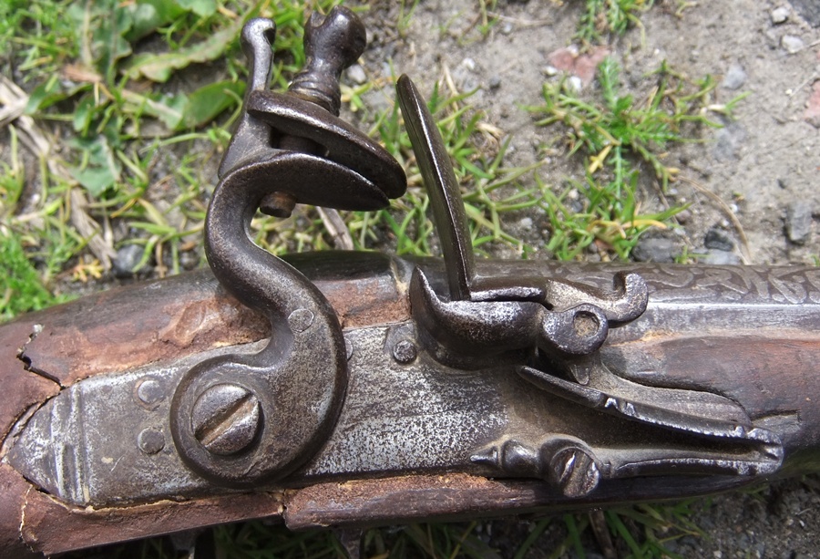

Fantastic! What a thing to find. I was just saying in the display thread about the terrible things people used to do to 'display' old weapons.
welcome to the forums BTW.
Just concertrate on the woodwork. Leave the metal with the nice aged look that it's got (IMHO).

Such a beauty, congratulations. Welcome to the forum :-)
Post some pictures of the inscription and I think we'll get it translated soon enough.
Thanks for the warm welcome
i have attached pictures of the text .. hope you can help

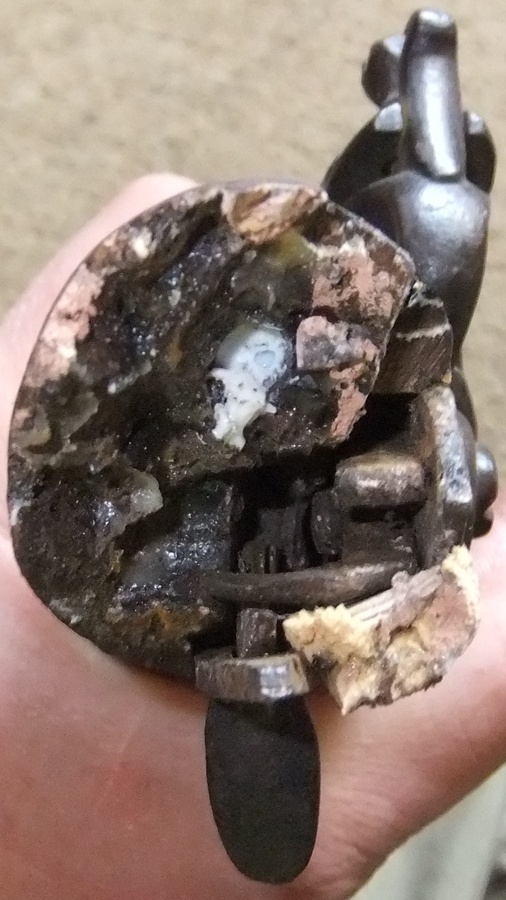

Whoops sorry .. had to be done when i saw the state of it inside ..
check out the state of the wood when i opened her up

More "yuck" photos
Hi Dooly
I know the damage is mostly modern, but often we see repairs and filled areas on these 'ethnic' guns. I would say that you have either the option of replacing the woodwork, or repairing it with infill and replaced areas.

Hi .. I do restore my guns .. but i try to be sensitive And the wood work on this one could not be saved .. almost fell to bits in my hands.

IMHO get rid of the "rainbow". Obviously done with heat. English locks of this age were not as far as I am aware "case coloured", so need to be browned to match the hammers. Similarly all other metal should be browned. Vintage looks about 1880.

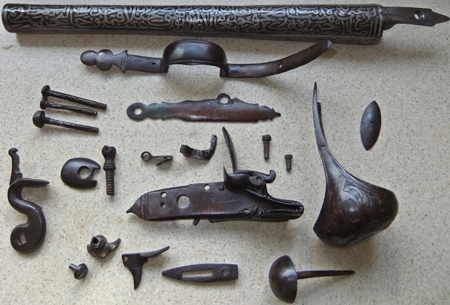

Now stripped and initial dip done

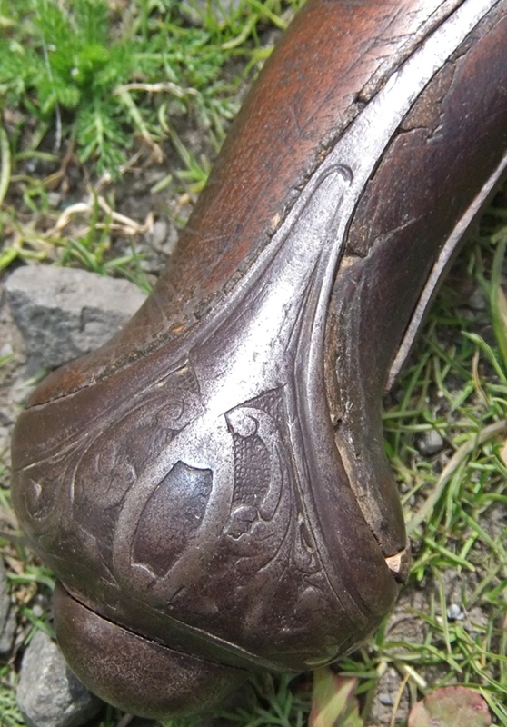

Well all done bar the barrel .. looks like the lettering was silvered or something .. will think about what to do with it ..
all barricaded now just let the oil soak in and next the stock .. still need to work out if i should make it with a ramrod holder .. what do you think

Hear you go .. a couple of shots of the hand bluing .. I think another 4 or so coats and it will be ready to buff it up

Old 31st May 2011, 08:31 PM   #13
rickystl
Join Date: Jul 2010
Location: St. Louis, MO area.
Posts: 1,633
Very cool !!! That barrel is beautiful. Thanks for the pic.

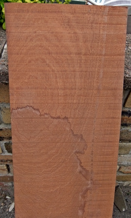

Hi Jim .. just a note on the arrow heads and tools i find .. hear in Northumberland .. all my finds are handed over to the finds leasion officer at the Hancock museum in Newcastle who records the site of the find (my metal ones as well) on a national data base .. so far i have found 9 unrecorded sites of neolithic activity and 6 Roman sites .. there is very little information from this high up in Northumberland and Rob is very happy when he sees stuff from up hear .. .. I have some videos on youtube if anyone is interested under doolybottleking .. why not have a lookin some time ..
PS all my digging and detecting is with the landowners permission !!!
Now back to the gun .. well my timber man did not let me down .. I have attached a couple of pictures of the bit (1 meter) of Cameroon Sapele i have chosen for the gun .. (the timber is FAS registered). I think this is as close as i can get to a appropriate re stocking timber for this gun ..
link to the tree
http://en.wikipedia.org/wiki/Sapele
Now the next hard bit .. pick the bit to cut out the new stock out .. !!!
