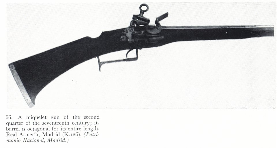

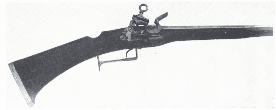

Lavin (ibid., cf. reference above) illustrates a fowler of very similar type and identical period, preserved in the Real Armería Madrid.
I tried to do my best reworking the scan.

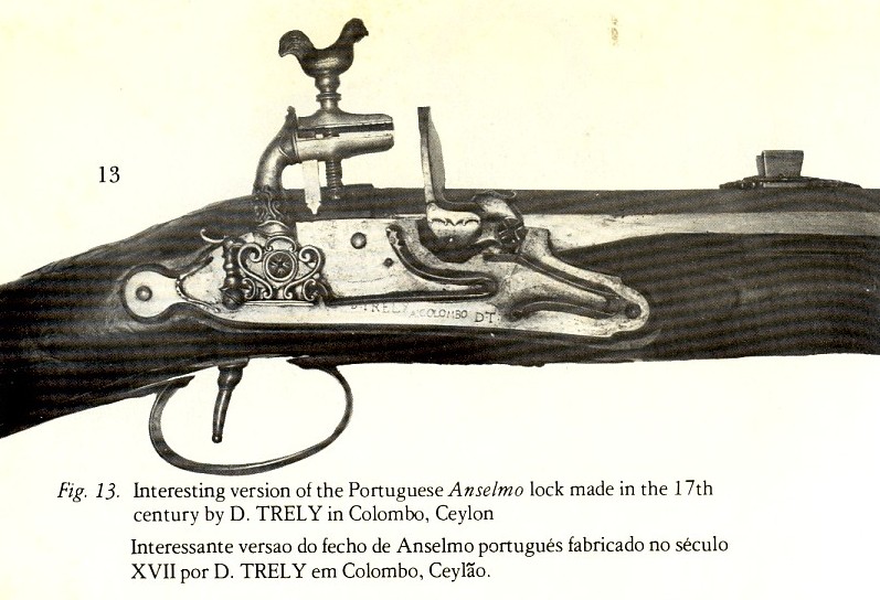

... This not meaning that Portuguese did not introduce in that period some of their own systems in Ceylon, namely the Anselmo lock with one position, with and without dog catch (back sear). Michl not minding, i show here an excelent specimen of such anselmo lock, made in Ceylon in the XVII century , signed D. TRELY.

Excellent additions, 'Nando,
Tanks a lot!
I have to admit that I am way from being an expert in flintlocks and their variations - the earlier stuff is my thing.
Michl
