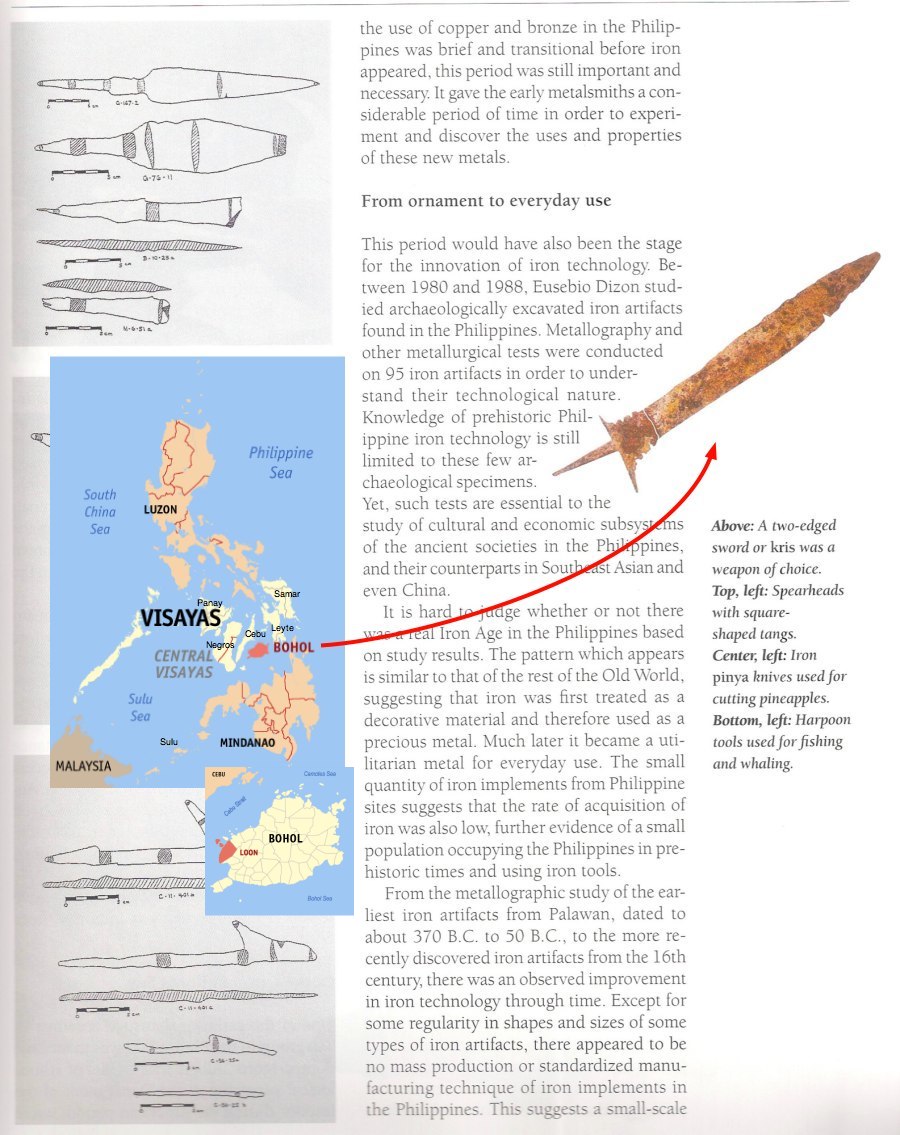

In vol. 2 of Reader's Digest's Kasaysayan: Story of the Filipino People, there's a pic (below) of a precolonial (pre-16th century) kris.
Later on, I found out that the artifact was excavated in the 1920s by an American archeologist [Carl Guthe, from the Univ. of Michigan], in the town of Loon in Bohol Island in the Visayan region of the Philippines.
This Visayan kris was estimated to be coming from the 10th to 15th century. The kris is still with the University of Michigan (Ann Arbor), at its University Museum of Archaeology and Anthropology.

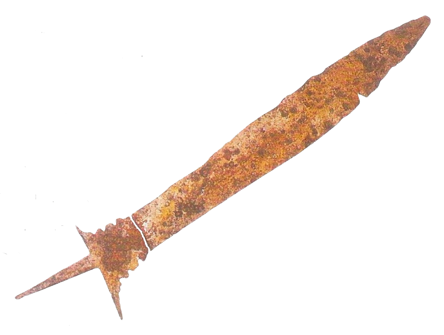

Here's a close-up of the said Visayan kris ...

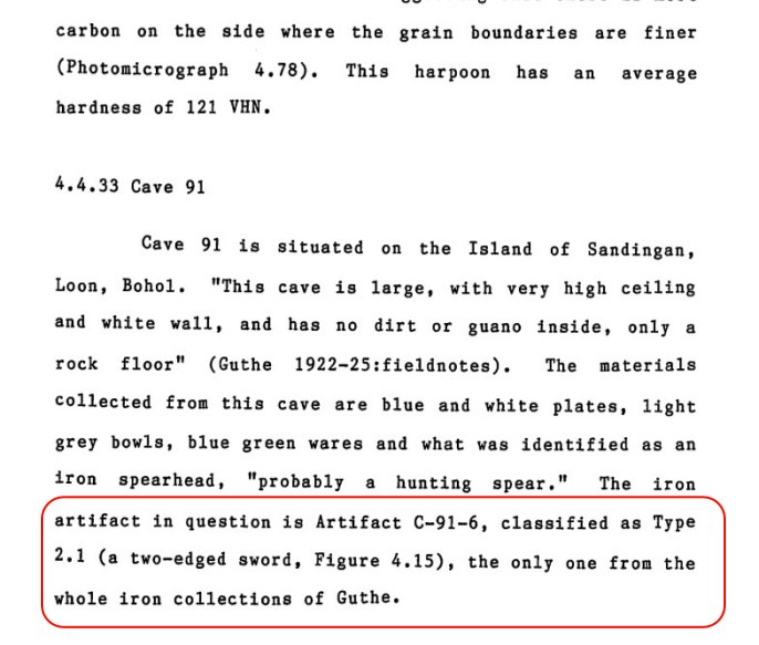

Incidentally, the dissertation covered 75 pieces from the Guthe-Michigan collection, plus another 10 artifacts from the Phil. national museum.
As to the basis of the age of the artifacts, I've just leafed through the paper (it's about 500 pages long). The 10th to 15th century dating can be found in the excerpt below.
I suppose they also used the associated Chinese ceramics excavated together with the metal artifacts. These Chinese ceramics provide a pretty accurate metric, and are used all the time ("Nacho" is an expert on this also).
