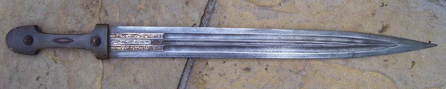

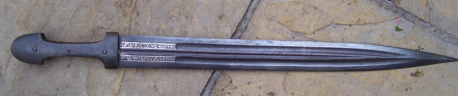

Hi,

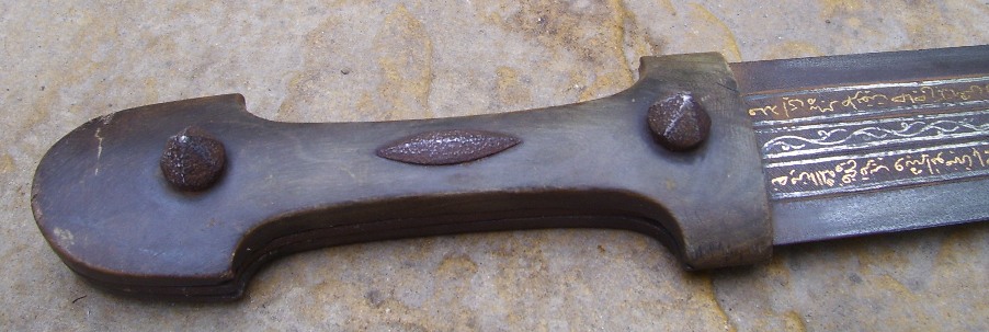

just received this very nice Kindgal (Qama ?). Lovely, nicely fullered blade with gold and silver koftgari. Horn handle with 'facetted' domed rivets. A big thank you to the formites that gave me some advice, Lew and Gene

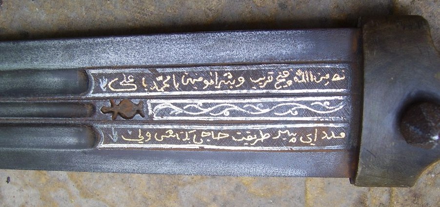

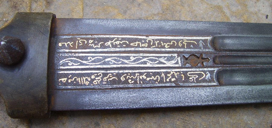

Dom, kindly translated the first line of the gold script, thanks again Dom
NASR MENE ALLAH WAFAT KARIB WA PACHERE AL MOMENINE, YA MOHAMED, YA ALI
MOHAMED, ALI, ANNOUNCE TO THE BELIEVERS THAT THE VICTORY OF GOD AND THE CONQUEST IS FOR SOON
The second line of script is not Arabic ....if anyone has any ideas to origins or a translation...I would be most grateful. The silver script on the opposite side of the blade is also not translated, as the silver was tarnished and the previous pictures were not clear enough. Please forgive me if the script is upside down.

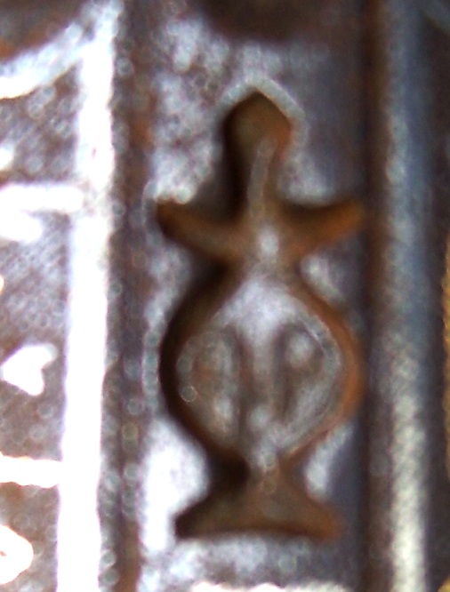

The well formed stamped marking has, what appears to be, a 'P' with a 'mirror image of a 'P' facing in the opposite direct. (the blurred picture below actually shows this more clearly than a focused pic )
Could anyone tell me its likely origins, age (I'm lead to believe mid 19thC) etc
oal 26" (67 cms)
Blade 20" (51 cms) length 45mm widest point.
All comments gratefully received

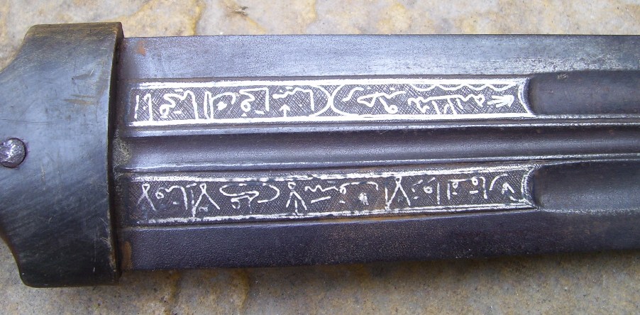

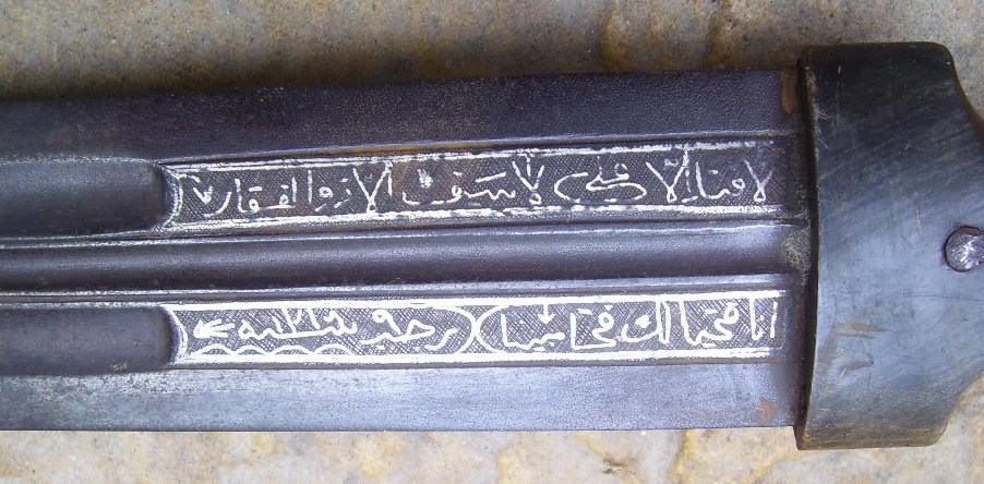

I copied the pictures and reversed them. I liked what i found; from Quranic verses, to Imam Ali praise and Sufi references!
- Translation:
First picture top inscription: Nasrun min Allah wa fat'hun qareeb wa bashir al mu'amineen. Ya Muhammad. Ya Ali. In english it is: Close Victory from Allah and close conquest, So give glad tidings to the Believers (This is a Quranic verse). O Muhammad. O Ali. <<<< is not part of the verse.
First picture bottom inscription: Madad e ---- Tarikat Haji ---- Wali. This is not arabic so I cannot translate. But looks to a sufi reference
2nd picture top inscription: La fata illa Ali, Walla saif illa Thul'Fiqar. In english it is: No Warrior equal to Ali, No sword equal to Thul'Fiqar.
2nd picture bottom inscription: Ina Fatahna laka fathan mubina. 9 Rajab Sannah 1218 or 1318. In english it is: We have given You a clear victory (Quranic verse). 9th of Rajab, Year 1218 (or 1318:P)

9th of Rajab, Year 1218 is (approx) Tuesday 25 October 1803 C.E.
9th of Rajab, Year 1318 is (approx) Friday 2 November 1900 C.E
The possible Sufi reference is very interesting ....with the mention of Iman Ali can I assume that this sword originated in a Shi'a muslim community/country ?

The stamp.....does anyone know whether this is a makers mark ? Could this blade be from Dagestan ? Most of the multi fullered blades like mine tend to be discribed as such.

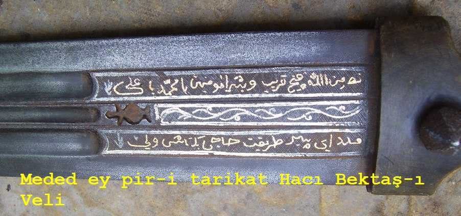

Hi,
The second line can be translated as follows:
Help us, the patron of our order (tarikat) Hacı Bektaş-ı Veli

Hi David,
The language in the second line is Ottoman Turkish. If we take the reference to the Bektashi order as an evidence, the origin might be either Anatolia or the Balkans. Also, I think the date is 1318 (1900/1901) rather than 1218.

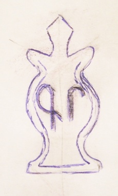

I have been able to clean out the stamped maker's mark (?) and have drawn it (pic below) It is not two 'P' 's afterall.
Can anyone help ID please, thank you
