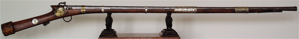

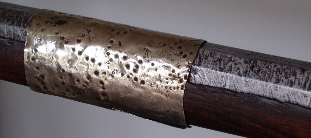

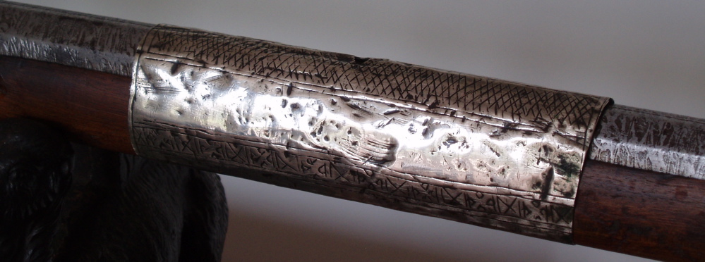

Hi,
Picked up a couple of these recently and really quite taken with them. Would really appreciate any and all info that you might have re these pieces, apart from what I've read on the Forum the net seems rather reticent about these guns. The barrel bands are of low grade silver apart from one which is brass, this one needs repaired hence the green string to keep it in place. There is, as you can see, a disc nailed on the butt with the initials B.W.G. and the number 12, any ideas? Many thanks in advance for any and all replies.
Norman.
P.S. Will post the other one asap.

Hi Norman,
Nice piece, with a nice barrel
But i will not say much, as you might get excited and try to shoot it .
Bands in low silver are an added value, i would say.

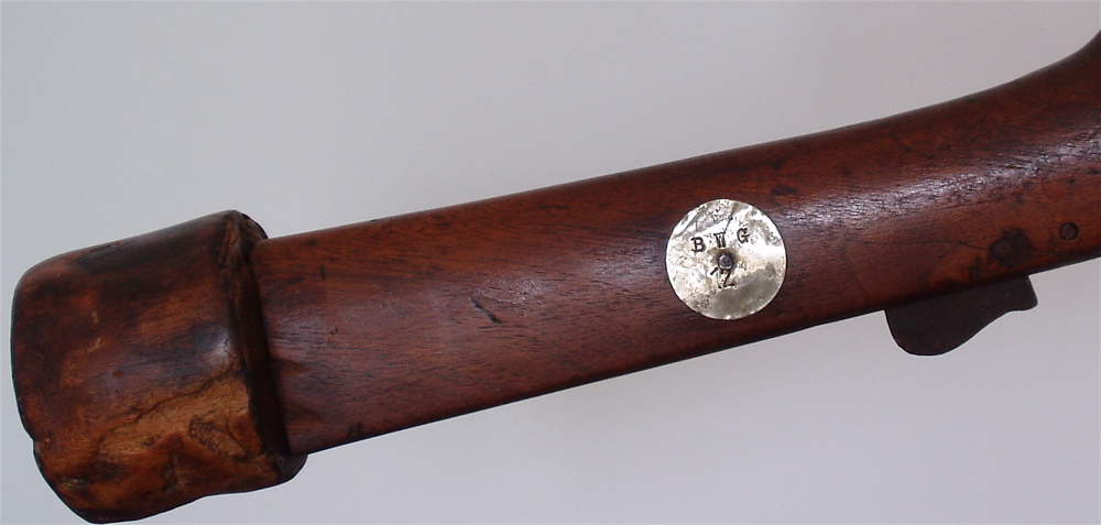

The brass disk with the marks is also a valuable detail; i love marks .
If you figure out what those initials and number mean ... arsenal, regimental or even (British) inventory, let us know.
Ward and other connoisseurs can have a say about this example .

Thanks for your input. The only rifles I tend to shoot these days are made by Messrs Anschutz and Co. and as much as I would love to give this one a try my sensible side, plus the wife, says absolutely not. The initialled and numbered disc is a bit of a mystery, I'm hoping some of the Forumites might have some ideas. I've been in touch with Ward and he reckons barrel is Hyderabad 18thC maybe early and the present stock/barrel combination dates from last quarter 19thC. Thanks again for your comments.

Nice one mate.
I'd say the silver 'dog tag' is an empire inventory. Just an unusual type.
I like these.
The phrase 'a lot of bang for your buck' seem to have been invented with these in mind.

Thanks for your interest. The inventory suggestion by yourself and Fernando seems to be a logical idea. I would agree that this type of item seems to be under-rated i.e. 'a lot of bang for your buck' I wouldn't mind it staying that way more for us 'odd folk' to collect . Thanks again.

A lot of Indian Toradors seem to have armoury/inventory numbers stamped into the stocks, initials and a number.

Hi,

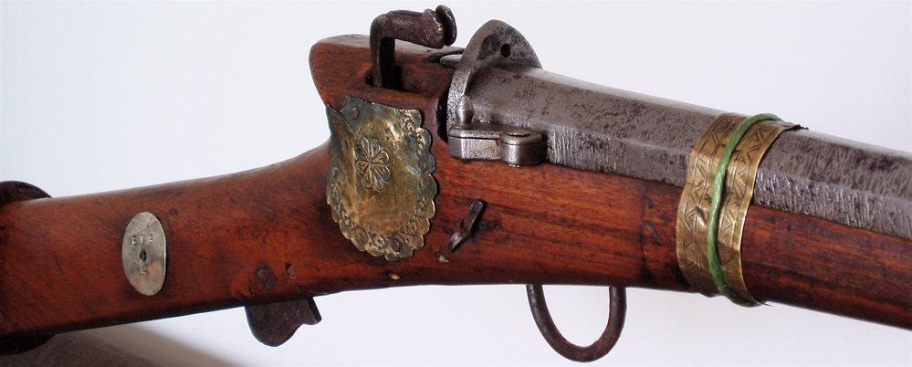

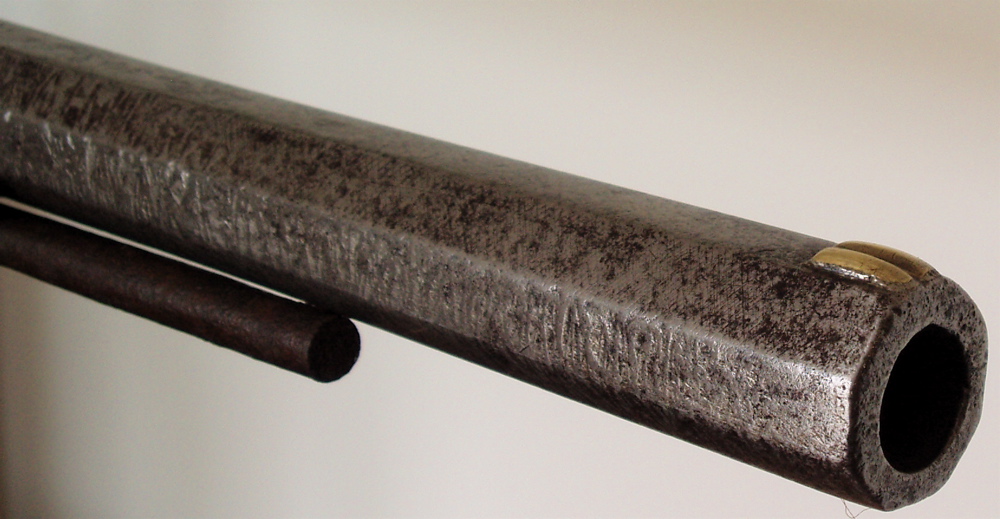

Anybody care to comment on the barrel on this one, it appears to be of better quality and manufacture than that on No2.
Norman.

Looks like it's been in cleaned with the barrel off recently, do the bands slip off? If so you can easily dismantle it and have a better look at the Barrel.

Hi Gene,
Guilty as charged, when I got these two the barrels were 'tubes of metal covered in rust'. I have had them both apart, cleaned them a bit more than I would normally have liked but to be frank 'needs must etc etc' or all I would have had were two sticks with a corroded looking tube bound to each with verdigris covered bands ( the low grade silver is copper rich). I'm not actually sure how this type of barrel was made and was looking for info re this process.
My Regards,
Norman.
P.S. I could dismount the barrel and photograph it if that would help.

You need Ward to come into this discussion. His collection is jaw-dropping.
The barrel is nice. the 'damascus twist' look is interesting, I'm not sure if it's etched into the steel or part of the construction.
Ward'll be able to tell ya I'm sure.
Any marks on the barrel?

Hi Gene,
I've been in touch with Ward and he reckons the barrel is ripe for etching. The problem I have now is that I have just moved, two weeks, into a brand spanking new apartment with all new fixtures and fittings and if I started messing around with any form of 'chemistry' the wife would have my 'manly bits' for a pendant. I have one particular friend with the necessary garage space for tinkering but he is in Norway at the moment, I'll grab him by the ear when he gets back. In the meantime any suggestions how to go about etching a 4ft+ barrel, plastic pipe I suppose? Thanks again for your interest.

plastic sewer pipe works great cement a cap on one end and just tape down the other end. works well with various acids or salts. this one might work with a slow etch. you have a lot of choices. if you want to go cheap use urine. any fruit juice or vinegar type will work make sure you plug the muzzzle and toch hole.

make sure the barrell is absolutly free of any oils of any sort. a quick ammonia rinse will work. soap will work just make sure it is very well rinsed. even windex will work. The differene in a fast etch or slow is in that a fast etch more gray will be brought out than black. It can also be deeper. Since the damascus can be made of so many different elements getting black is no guarentee and can only be hoped for. another etch you can try is using horse manure and urine. These are more traditional types and take longer but the results are often better.

this is where the fun begins. it depends on what was used to make the damascus and what the ph level of your acid are. viniger alone is sold in so many levels of acid and on top of that depends how much you dilute it. suggetion only yes this is your science project. leave it in for a day quick wash it with a hose leave it for 3 days check at 7 last at 14. fruit juices include pinaple, tomato,lime,orange, even ketshup tomato and vinegar. whostershire will even work. wine if you leave it out a day or so. tell wife to clean the cubbords since you just moved throw in blender and you are set. the fun gets to be if you ever want to reproduce the results or explain those dark stains or etch in the pots to the wife.

What is the purpose of the rib running along the top of the barrel, is it from the method of manufacture?

Hi Norman. Nice piece. I agree with others about the Inventory Tag. At least that would be my first guess. The barrel, Hmmmm. Maybe twisted steel? Maybe Damascus? The stock appears more Persian influenced in one respect, but somewhat Turkish in another? A nice piece to study and discuss. Yes those of us who collect (and in my case shoot) these guns are considered some what of odd balls in the shooting fraternaty.

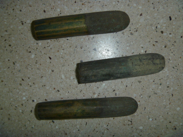

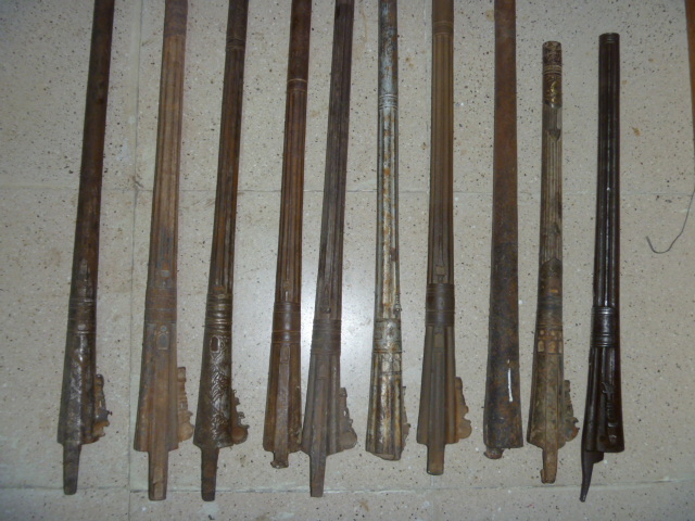

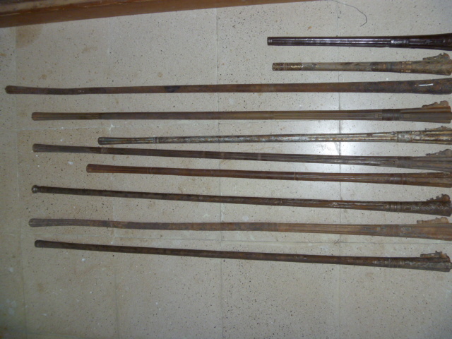

Great pictures of the Torador . I have a small collection of Indo-Arab "Abu Futtilla" (Father of the Match) barrels some in good condition others blown and missing much of their barrels having exploded at the first weld. One day I will get round to restoring them. Found in Oman. The brass cases are for ready made up charges and would be worn in a cross belt... nice and rare!

Hi Ibrahiim,
Thanks for your interest, it would be nice to see some of those barrels restored to their former glory.
