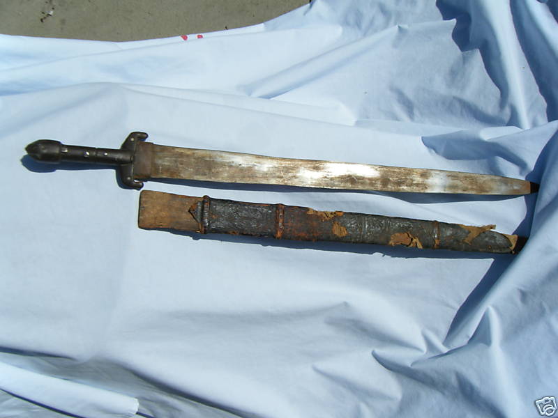

I followed the Sothebys item very closely... and I was also stunned to see the price. I must have handled half a dozen of these variants in my time . I had a good look at that one and discovered it was a wootz blade and had an inscription in the pommel which would have been the owner or the maker.No one has cracked this one yet. It just seems to have appeared sometime out of the blue! Similar relatives appear to be Persian perhaps from the Greek and or Roman short. For sure if it is as old as they now suspect... 10th century? then it is certain to be up the value scale. In terms of quantity left in Oman my estimate is their could be 10 left dotted around .. though I do know a collector with 24 ! and another with 18. I have to say the 2 that I have may not be wootz but I ve not cleaned the blades yet..
In my view they arent kattara since the blade is completely different with a predominant wing cross section and not flexible like the Omani Long Kattara. The hilt is totally different compared to the cylindrical Long. The technique for fighting is different altogether from the Long because the blade is short(a lot of the Shorts Ive seen are about 30 inch total length. Its a hacking weapon.. for up close work , like the Roman short...or like a 2 edged cutlass / short claymore.. and the shield therefor must also have been different to the Buckler(terrs) and must have been big... Heavy infantry as opposed to light speedy nip in slash and snick which is the technique for the Omani Kattara ... Therefor if the weapon is structured differently and used very differently its not a Kattara. I would suggest that this short variant came in early from Persia and was the weapon of choice for fortress or strong point guards up until the Omani conquest of Zanzibar (1652) which then became a conduit for African swords into Arabia. Thereafter I can envisage a tried and tested sword living on as a fortress weapon in Oman well into the 19th century..and other infantry employing the newer Kattara.
The question as to how the Kattara evolved is also interesting... Did it evolve from the Omani Short? Or did it evolve from the influence of African weapons ? Or Both ? OR~ Did it evolve entirely separately ?
May I just leave that as an open note and request forum input (so I dont bore everybody!)

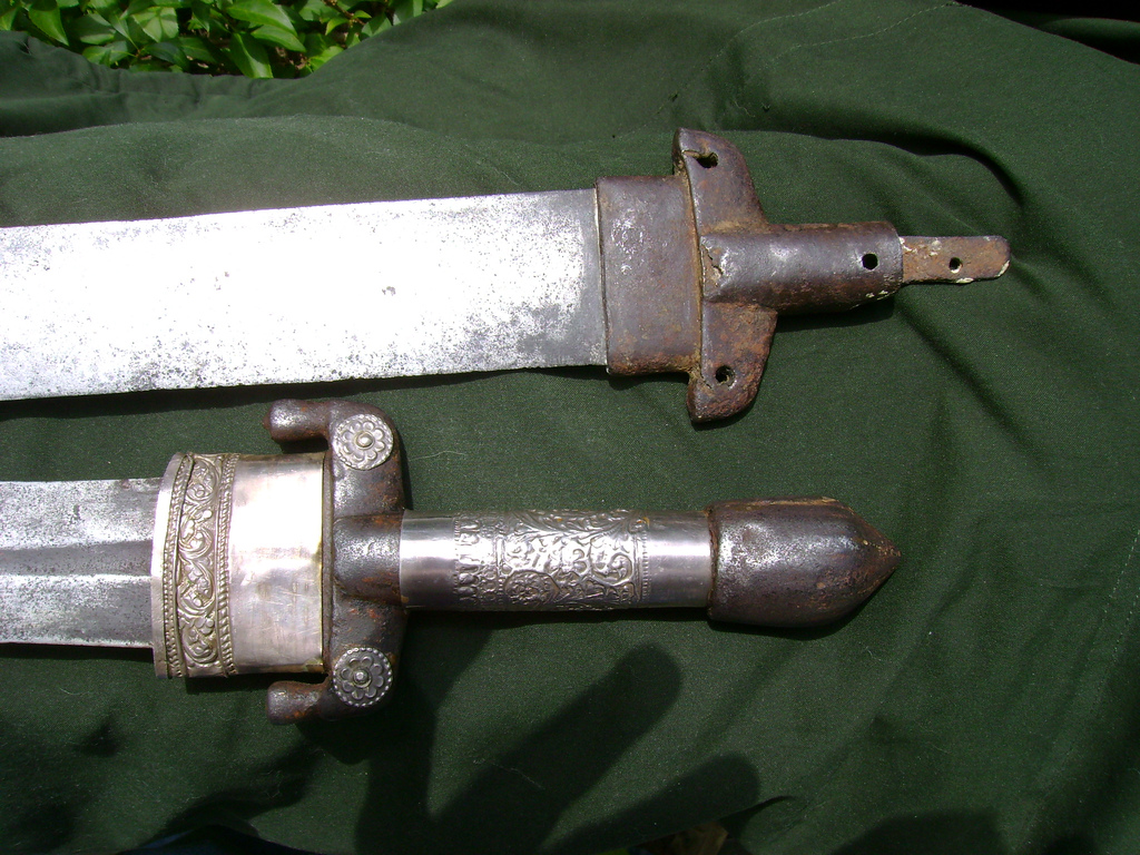

Smile Omani Short Battle Sword // Kattara.
It is my view that the Omani Short sword with turned down quillons and a spiked hilt with the rigid pointed blade does indeed relate to the Nasrid Dynasty 1232 to 1492. The fact that this sword has a short blade and seems related to Greek or Roman derivatives is in my opinion purely fluke. There is no evidence that the style originates in Persia. I believe it is simply parallel sword blade development in an unrelated region i.e. Spain.
One could further speculate that the passage of this sword to Oman was inspired by Ibn Battuta the famous explorer who was in Oman certainly in 1330 and who later travelled to Spain in about 1350 but who knew the Meditteranean since childhood as he was born in Morocco in 1304...
The Omani Short Sword, however, is so completely different to the Kattara that I suggest they are totally separate developments. They are different swords for different purposes and different styles of combat. It is difficult to see how one originated from the other as they are totally different.
I further argue that the Kattara originated via the African style(Sudan~Abyssinia) on or about 1652 when Oman seized Zanzibar and that both swords continued to be used by Omanis until the longer weapon slowly took over perhaps as late as the 19th / early 20th Century.
I hope this note may inspire further discussion.
