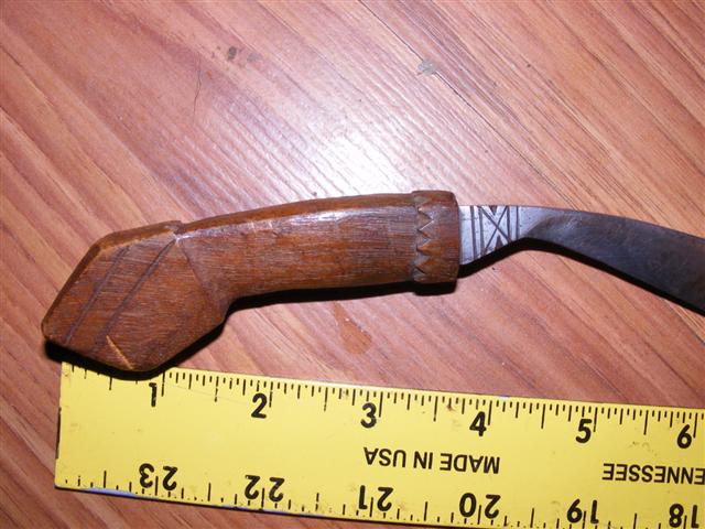

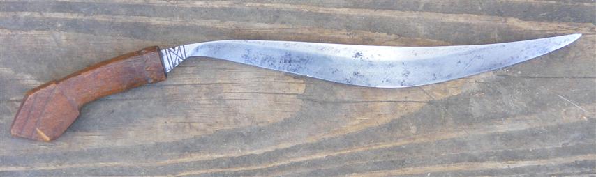

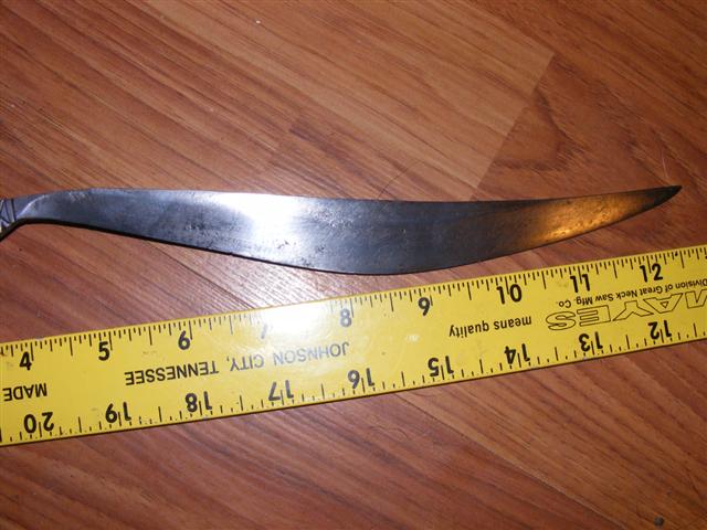

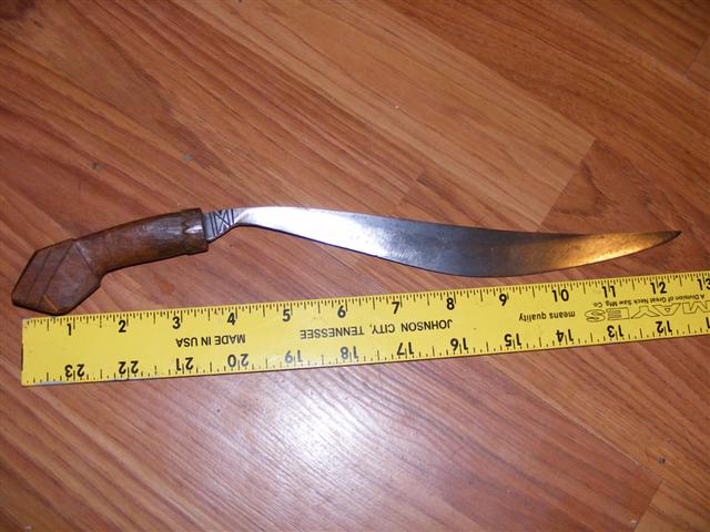

Here is a small talibong that I found. The scabbard is in pieces at the moment and being glued back together so I didn't include any pictures of it but will post them later if this is not just a tourist item. Maybe this was made for a child or maybe to be used in the preparation of food? The blade is very well made and is 1/4 inch thick at the hilt, very sharp and has nice decorations on the ricasso. Sorry about the pictures. They were taken inside with a flash as we have over 18 inches of snow and it is around 15 degrees outside. All comments and thoughts on this are welcomed.

It looks newer to me.

I'm come across talibongs that are a little smaller than Robert's and show some age... This particular example aside, what were the small talibongs used for?

Hello Jose and thank you for your comments. Just so you know, this picture and the ones above were taken after cleaning the rust from the blade and cleaning and waxing the hilt. The main reason that I posted this is the file work on the blade seemed uncommon.

Well, that helps Robert. The hilt and file marks appear newer to me. Yet the blade profile is older in design and certainly traditional.

dagger/knife sized talibons are common, and I suppose they'd be used as dagger/knives. This one looks pre-wwII to me and nice. Notice the blade which is both curved and narrow; bannana like; this is how the thumbrest "garab" ones are; newer blades tend more to have straightish spines. The base is thicke and wedge-shaped, no? Newer blades are thinner/flatter and even sometimes thicker at the front edge (a style I also enjoy). No thumb rest as such though, huh? the very narrow waist is a feature I consider older/more original. Looks like an older piece to me. I love the great variety in these.....

Any chance it has a scarf welded edge?

I have two similar-sized talibongs from WWII with kamagong handles and scabbards. BTW, the filemarking on the tang is found throughout the Philippines and is believed to be an ancient symbol that is put on blades to protect their owners. As with many Visayan blades, I believe talibongs are for general use as well as for use as weapons.

Tom, It actually does have a scarf welded edge. I guess it does not show too clearly in the pictures. It is a very well made blade.

I have mine in storage--I'd have to check. Pandays throughout the Philippines were taught to put similar markings on their blades, and many continue to do so without really knowing why. I've even seen them on balisongs! I thought they were just maker's marks until I came across a source that said they were talismanic. That might explain why similar markings are found on blades from completely different areas.

Yes, I too have seen this type of markings on quite a few Philippine edged weapons before, but this is the first talibong that I have seen marked in this way.
