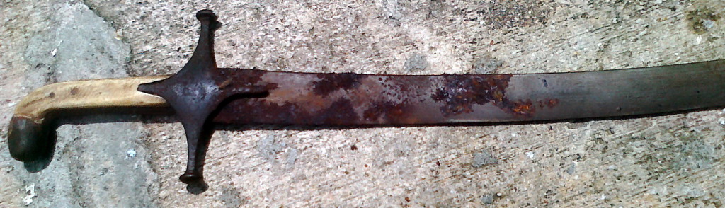

Please grace us all with a couple of images of the sword as it currently stands, it would be very interesting to note how it sat in a tomb.

Sure thing, click on the thumbs for a larger image

Thanks for the images Celtan
You have a job and a half ahead of you there. IMHO do not concern yourself too much with the scabbard, you have the sword as your objective and you have scabbard fittings too so modern marvels can be achieved.
Me, I'd be tempted to drill a few very small holes discreetly along the seam on the underside of the scabbard and use a fine dropper to fill with oil. There are bound to be places along the seam, that when pressed with your thumb will have points of give in them, this would be where I would start.
I'd be interest to see what others have to say and I certainly wish to see the sword once removed.

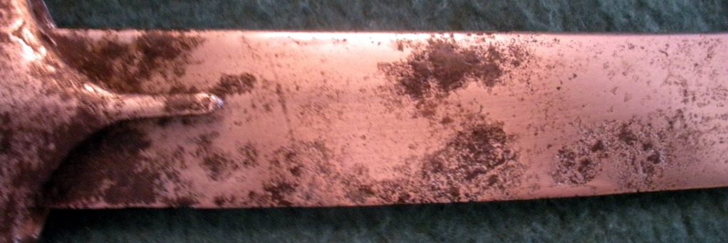

Used the mineral oil through breaks in the scabbard, let it soak for a couple hours, applied some judicious tapping to the crossguard, and voila!
Now, the condition of the blade as it is is troubling. The rust has grown to a concrescence in certain areas, as you can see. I was wondering how to deal with it. I have never had to work on such heavy rust. Naval Jelly? A Dremel Drill? Seems like an obscene fungus growth.
Any suggestions?
