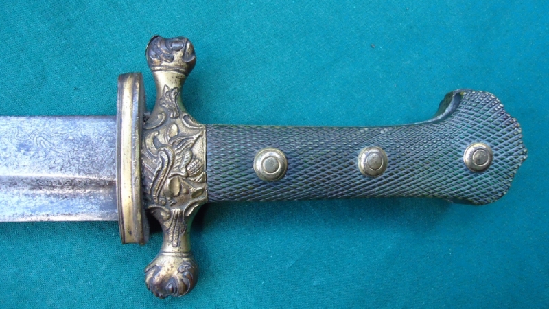

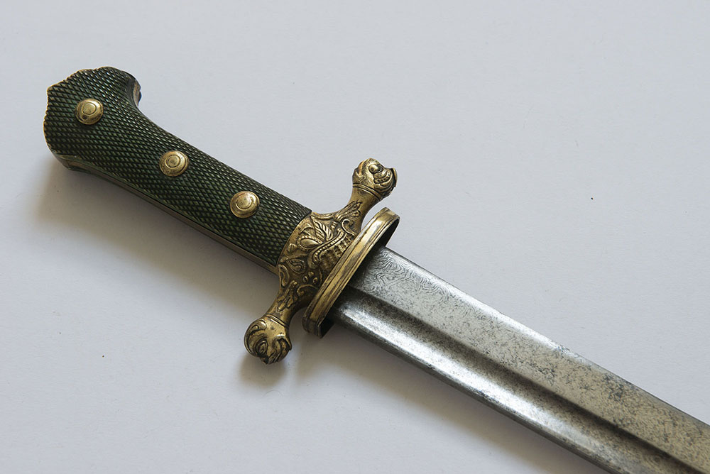

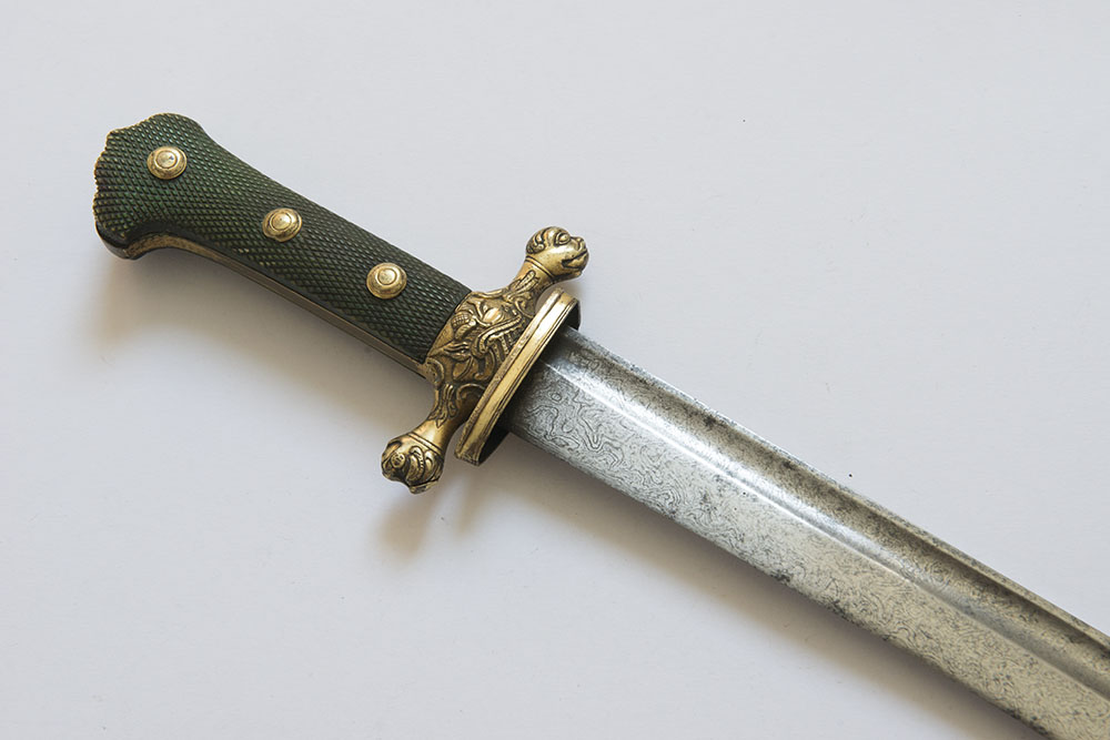

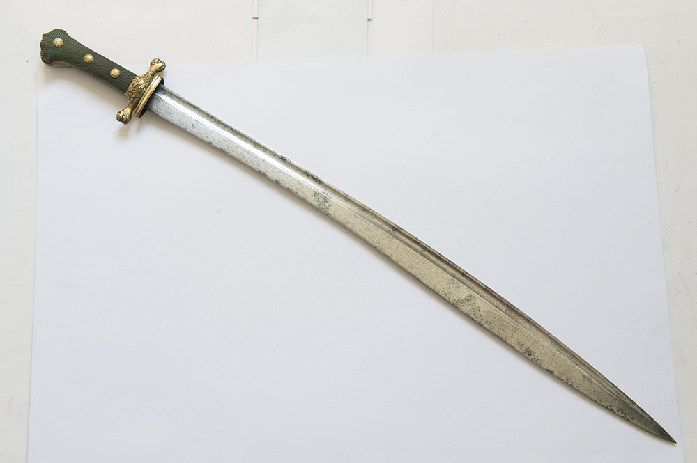

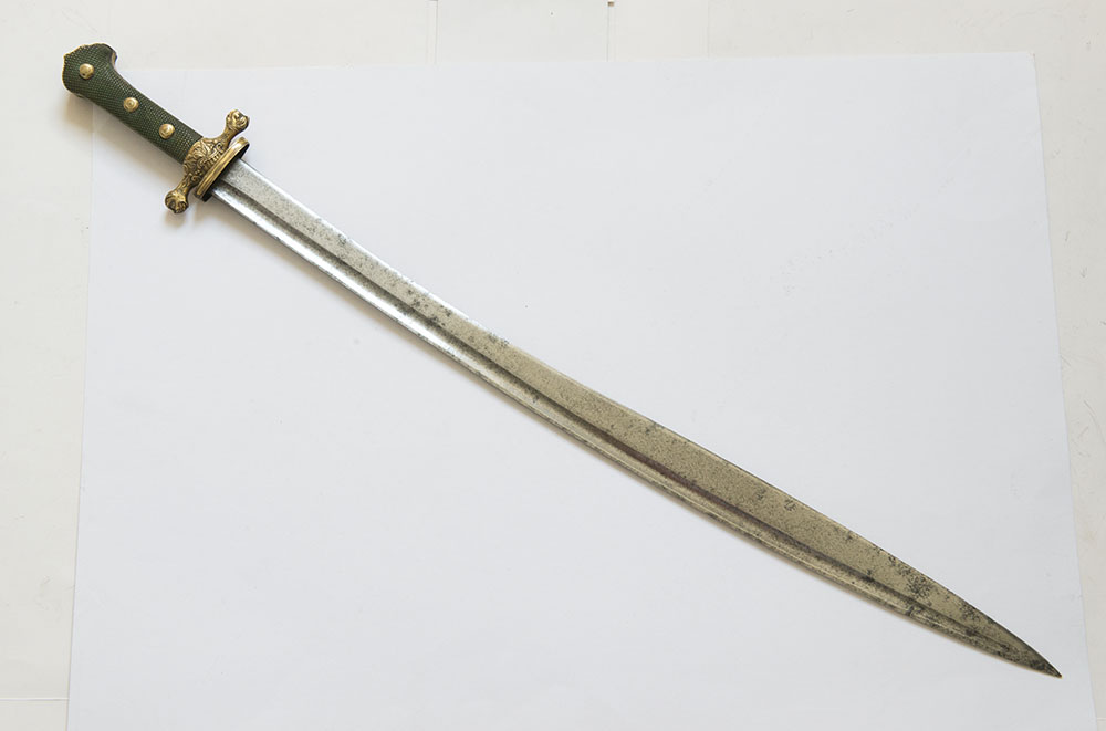

I normally do not buy European arms, but I couldn’t let go this huge yataghan-style blade forged from the fine Damascus steel! I believe it is a completely European-made sword. Maybe it is a Hungarian Pandur sword? The fittings also resemble French hunting swords from the 18th century?

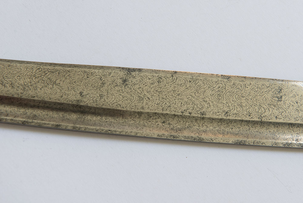

Very interesting sword (Karabella Yatagan), but for accuracy one needs to mention it is PATTERN WELDED Damascus and not true/oriental Damascus steel (aka WOOTZ).

This looks like patterned wootz to me (folded cast steel). Plain folded patterns are usually more homogenized steels worked together with few voids, rather than one cake of wootz being manipulated with a minimum of being beat on. There are grades of wootz/cast as well.

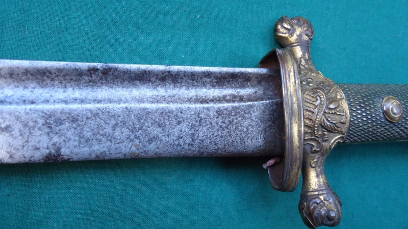

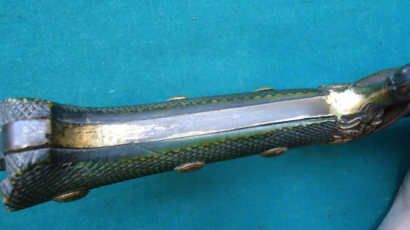

Of course you are right: the blade is made of twisted-core pattern-welded steel. In the place where I live it would be called Damast- or damaszener steel, that's why I used the word Damascus without further thinking - sorry for the misunderstanding!

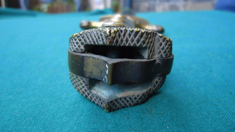

Still it would be interesting to know the origin of this sword. I believe it is not later than 18th century, having fire-gilt bronze mounts (please see the original pictures - I have cleaned later the fittings with Flitz) in a typical baroque style. The Karabela type hilt made of green painted bone (most probably ivory) and it points to the Eastern Europe, and the blade shape is yataghan inspired, although most probably European made. I wasn't able to find a similar sword in my books or online.
One of the heads on the guard have a small moving detail in his chin - I do not know it purpose, but it is not occasionally there :-)

Tatyana, I agree with your initial assessment. This is European hunting sword, I'd say German (based on the pattern) or French (based on handle design). Certainly at least 19thC. The blade is of Damascus mechanical pattern of course and resembles yataghan shape but is not of Turkish or Ottoman production.

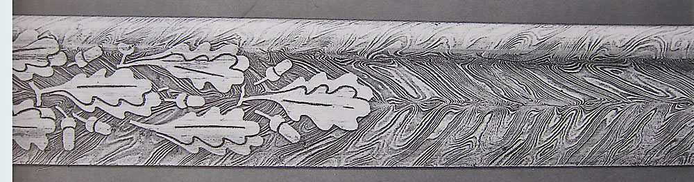

Tatyana, production of mechanical damascus was widespread and not at all uncommon in Britain and Western Europe from the 1500's through to the end of the 19th century. It was used for bladed weapons and for gun barrels. Some superb examples exist which in my opinion equal or exceed the beauty of mechanical damascus produced in other parts of the world.
Two excellent references are:-
Damaszener Stahl - Manfred Sachse, I have the English edition:- ISBN 3-514-00522-2
On Damascus Steel - Leo S. Figiel, ISBN 0-9628711-0-9 & ISBN 0-9628711-1-7
This particular sword that you have shown is outside my area of expertise, so I will not express an opinion on place of origin, however, it was not uncommon for sword smiths in Western Europe to copy Eastern styles.In fact, Germany has a long tradition of highly skilled damascus smiths, who continued into the era of WWII and after. One exceptionally skilled smith was Paul Muller who worked during the WWII period. An example of his work is shown below. As you will understand, this sword of yours does not need to be particularly old to be particularly beautiful and valuable.
