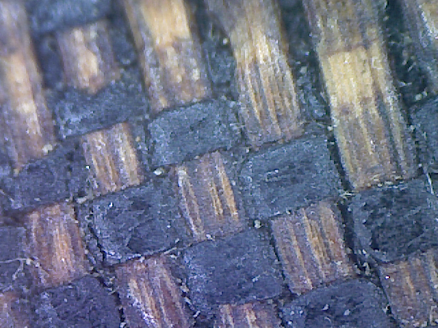

I recently purchased a USB Digital Microscope....with a mag of up to 200x . It is fantastic, allows you to take snap shots via the PC. I highly recommend one...and they are relatively cheap (around £60 ) When I get a chance I will add some images created with the microscope so that you can see the results

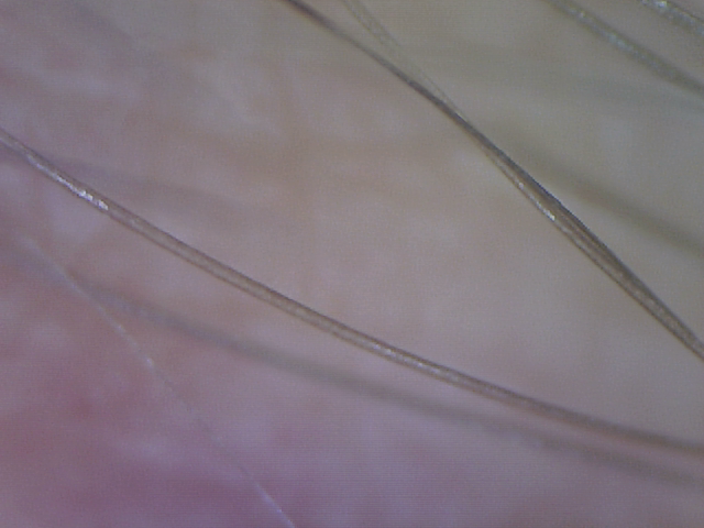

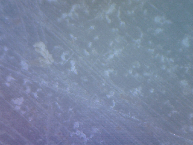

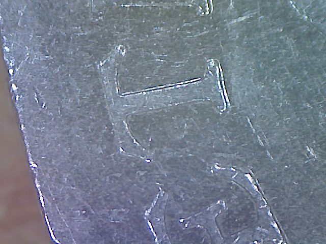

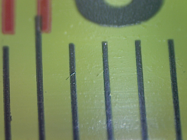

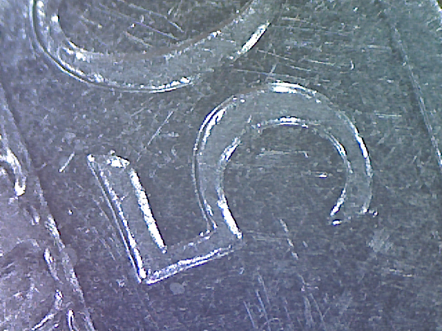

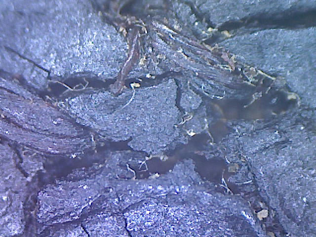

Hi Gav,
here are some quick images including a blade, stitching and woven reed pattern (reeding less than 0.75 mm in width) on an african scabbard, a British 50p piece, human hair and a metal tape measure (each graduation = 1mm)
I am suitably impressed
Regards David

USB microscopes can be really fun and may even be sufficient for the task at hand but everthing written on the box should be taken with a containership-load of salt.
Here is an article that explains some of the principal constraints http://www.msscweb.org/public/articl...nification.pdf
My guess the optical magnification of most inexpensive usb-microscopes is in the range of 20x-30x.
Another concern is the Depth of Field which is likely very small. Again, these things are fun might be sufficient for what Gav wants to achieve.
I personally own a Lomo MBS-10 microscope that i use regulary for hobby purposes. The thing is build like a tank and has good optical components. Still I don't get much more out of it than 100x. I wouldn't even dare to compare it to the modern scientific microscopes found at most universities.

katana
katana's Avatar
Location: Kent
Posts: 2,658
As Thilo has stated, the 200x mag seems a little exagerated (I never believed it would be that good) but, nevertheless certainly seems to be at least 30x. The pictures I have posted are not 'photoshopped' ....so there is further 'scope' to improve the pictures. The illumination is provided by LED's intergrated into the 'telescope' and seems to be sufficent without causing glare from shiny surfaces.
They certainly are 'fun' though and bought it to investigate some of my collection.
Regards David
