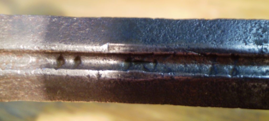

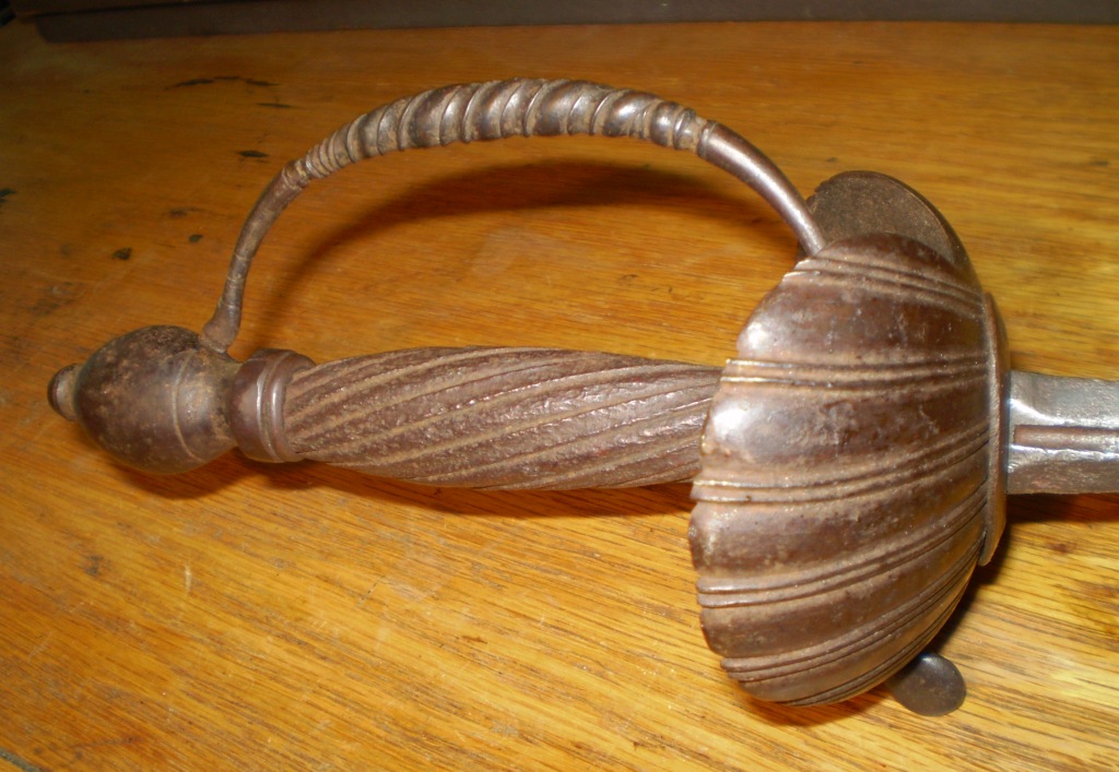

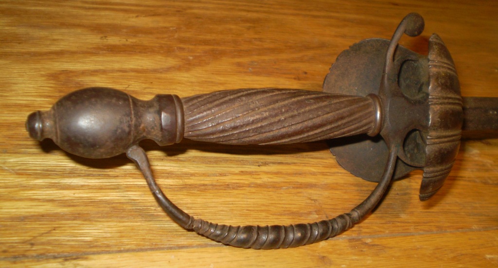

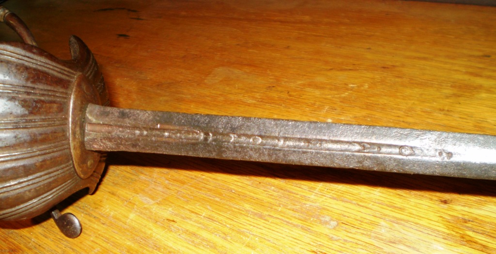

Need help with this one, I think it is Spanish. The guy I got it from about a year ago had some story about Cortes era explorer use. In pretty good condition, blade is 28" long. I took several pictures of the markings on the better side of the blade.

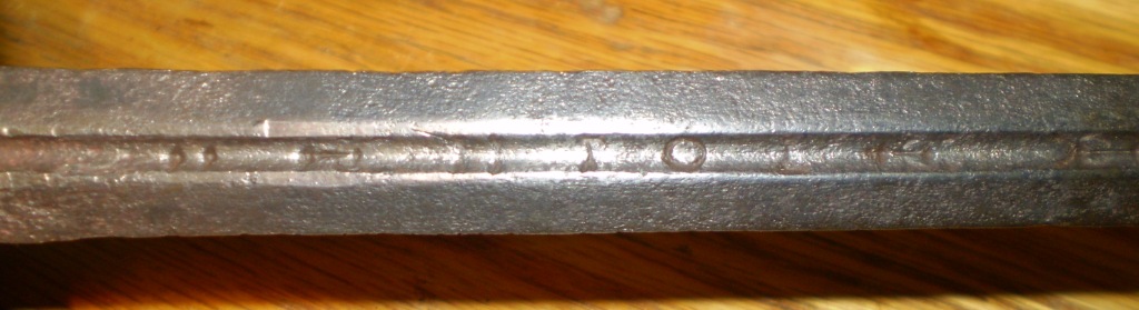

More pictures. One of the marks looks like an anchor, my wife thinks it is a little stick person thing. Letters look like a "T", "O", Maybe an "M" & "L" in there too.

I think the vestigial pas d'ane would indicate a time frame (18th C.) much later than Cortes (16th C.). The markings you describe sound like a familiar makers mark... Try searching under "maker's marks" in the European arms & armor forum - there's a thread that documents many of the marks of the period.
Speaking of which, you might want to request one of the mods move your thread to the European weapons forum...
ETA: In looking through another book, it would seem other style elements, e.g., the symmetrical clamshell guard, might date this as earlier - maybe mid-late 17th Century?

I have it on good authority from a friend who viewed your photos that the sword is most likely of 18th Century origin (as indicated by the striated clamshells and hilt/pommel style) and is indeed Spanish (though he is of the opinion the blade was likely produced in Solingen). In particular, he is of the rather certain this is of the Spanish Colonial style associated with the Spanish Main and which is often attributed to Brazil. In fact, he helped identify a group of forty of these from a shipwreck off the coast of Panama several decades ago. Hope this helps.

Yes, the anchor is an usual decor in Spanish (and not only) swords.
The T and the O seem to be followed by an L; these are usual initials for Toledo, a famous Spanish edged weapons center.

Might be a spanish blade married to a foreign hilt, or it could be completely Spanish. All that can be said for certain is it follows spanish style. It has a fully functional pas dáne, which places it from late 1670 t0 1770.
Heck, even the blade could be german made, as Solingen et al made good quality copies, including the now famous running-wolf mark from Maestre Perrillo, which paradoxically became Solingen's trademark.
The Toledo inscription is seen in various motifs, from Toledo Me Fecit, Toletum Me Fecit, En Toledo, En Toleto, En To, En Tol. The stop mark comes in all sizes and shapes, often a cross over a half circle or orb, and sometimes even a group of three crosses.
The clamshell small guard seems to say to me ~1720. The metallic grip may be a later replacement.
