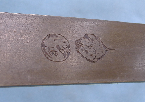

Guys, Hello, how are you? Hope everyone is well.
Could really use and will really apreciate some help on the translation of the inscription and the marks of this shamshir.
Very intriguing, I've seen "the lion" many times, in different poses, sizes, and the way mark is rendered, but never seen it with a possbile inlaid inscription inside. Thank you in advance guys. Alex

Aleksey,
That is a beautiful sword with absolutely georgeous wootz! Thanks for sharing. I recall another example that had the lion cartouche with inscription on the lion. As I recall, that inscription was "Assad Allah" and this marking looks similar but I wouldn't bank on it just yet.

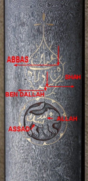

Hi Alex
your sword is "Persian" it's a "Shamsheer"
the hilt is in "Baddawi" style
the shape of the blade, classifed your sword as "Qara Toban" (a variety of Persian Johar)
seems be 18th Century
the pic identify the blacksmith, the famous "Assad Allah", and a mention about "Abbas Shah"
the long mention on the blade, is a poem written in old Arabic,
unfortunatly my translator don't have the necessary knowledge to offer a translation of it
all the best

hello all,
this is my first contribution here so i hope its a helpful one. the 2nd picture showing the poem is upside down so i had to copy the image in order to reverse it (blade up). i can confirm that the poem is arabic, but so far i cannot connect it to any poet.
here is the translation (it may not make sense, so please forgive me) starting from right to left:
1- ujebti عجبت: it is written as if spoken to a female and it means: (you are surprised or liking)
2- Min من: it means (from).
3- alsawarema الصوارم: it means (swords).
4- wa alqana والقنا: which means (and spears).
5- yuhdana يحضنا: it means (embraced).
6- fe في: means (in)
7- aydi ايدي: means (hands).
8- alqawm القوم: means (the people. but it could also mean anything from army to a gathering of people).
9- wa huna وهنا: means (and here).
10- thukur ذكور: means (males or men. but may even mean, memory).
11- wa ajab و عجب: means ( and was surprised )
12- minha منها: means (from it)
13- be anaha بأنها: means ( as or as if)
14- be altafahum بالتفهم: means (with understanding or collectiveness)
15- tu ajeju تأججو: means (to increase or to fuel)
16- naran نارا: means (fire)
17- wa le akuf ولأكف: means (and to cease)
18- buhur بحور: means (seas)
19- wa ujabu واعجب: means (to be surprised or i am surprised)
20- min من: means (from)
21- this word i cannot understand so will confirm it soon.
22- ya suda يصد: means (to block)
23- alashad الاشد: means (the hardest)
24- wa hum rukud وهم ركود: means (while they are lazy or docile)
from what i can tell, the poem is made of 3 verses.
this is the best i can do so far, so sorry if its not helpful. will try to show the blade to a more experienced person (experienced with poetry that is) and hopefully i can get the poet and the meaning of the poem.

i havent yet shown it to my friend, but my father says that it could be a mish mash of multiple verses from different poems and am begining to support that. at first, i thought its a persian poem translated by a persian to arabic (due to the existence of vowels and parts that simply doesnt make sense) if its translation, its weak translation.
i must say though, it is an amazing blade. congratulations.

Another example of 'writing on the lion', which reads: "Amel Assad"/"Made by Assad". I think you may have mentioned this one, Rsword:-). I do not think it means anything significant, as Assad means Lion, this could be decoration related.
Alex, this is absolutely wonderful sword and looks fantastic. I saw it before, in uncleaned condition, and now it is simply flawless. Congratulations on owning it!!!
