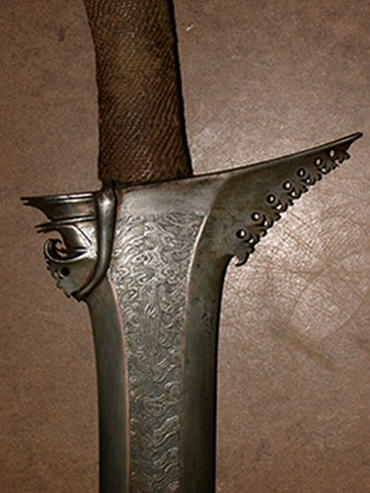

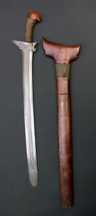

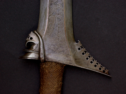

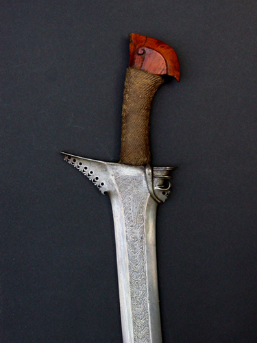

Hello all. I've been reading the forum for some time now and decided to post a few photos of a Moro Kris I have that has a center section of twist core. The knowledge that has gathered here is a source that is unquestionably invaluable. Any information pertaining to the origin of this type of sword would be greatly appreciated.
The details are:
Overall Length: 26 1/2 ”
Blade Length: 21 5/8 ”
Blade Width: 1 1/8 “
Blade Thickness @ gangya: 1/2 “
Scabbard Length: 23 7/8 “
As quoted by a good friend:

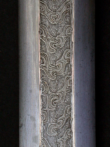

"The straight double edged blade forged with a peripheral “mantle” of hard, lamellar steel flanking two rows of twisted cores in a very regular and controlled pattern. The cores are deeply etched to create a visual effect governed more by topography than by color contrast. The junction between the edge mantle and the central cores is defined by an inlay of copper/silver alloy, the design terminating in a stylized “serpent head” motif near the tip."
Thanks for any help.

Old 26th September 2005, 10:20 AM   #3
Thumbs up Gorgeous!
Great start for coming out of lurking mode, George - welcome among the k(e)risofanatics!
That's a museum quality piece with apparently original fittings...
Following Cato this would be a Maranao piece, of course.
I really like these small kakatua pommels! I'm not sure if the topographical etch is really original but it's nice and I certainly wouldn't mess with it. Could you please post pics of the reverse side? I'm especially curious wether that arrow-like pattern design at the base of the blade is intentional (I'd guess so).

I must say that is a very nice kris The core is actually made up of two twisted rods forged welded together. We were discussing this type of blade construction at Ashokan this year. I saw a pic of a Moro kris last year that was a seven bar composite blade. These types of complex multi-bar composite kris were forged only by the most skilled bladesmiths. I wonder if these smiths were trained or apprenticed somewhere other than the Philippines or maybe picked up the technique from a Chinese smith working in the region? We saw a few Chinese dao sabers with the same construction at the seminar this month so it is possible that these kris could have been made by chinese smiths living in the Philippines?

That is a lovely Maranao kris, perhaps early 20th C. from its overall size and style. The central portion with twisted rod construction is particularly well done. The treatment of the edges and tip is similar to a large sword for which I posted pictures recently.

George, thank you for posting this puppy. Though not unheard of, it is seldom that you see twist core in Moro, especially double twist core like yours. Amazing. You see more of this in earlier pieces than later.
Regarding the panday training, I'm not sure that is had to be some one Chinese. I have a double twist core Bagobo piece and there are not many (if any) Chinese living in that area.
I also like the silver inlay.

Old 27th September 2005, 12:44 AM   #10
George
Join Date: Sep 2005
Posts: 6

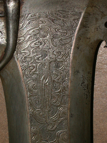

Kai,
Here is a quick shot of the other side of the blade. It has the arrow-like pattern you speak of but with a slightly different shape to it; a bit less pronunciation which I attribute to hammering.
My experience with Chinese swords is that twist core of this creation (control in pattern, uniformity, etc.) is found in older pieces (pre-20th century at minimum). But the material on the scabbard reminds me of what is found in WWII frogs, etc.
Thanks for the comments.
George

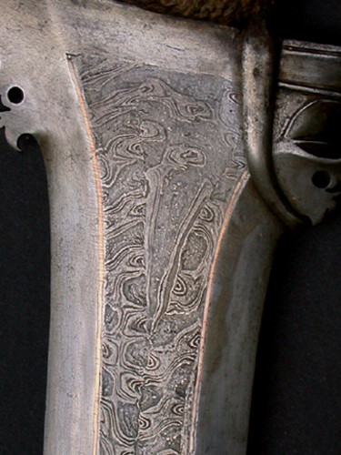

Old 28th September 2005, 03:01 PM   #11
Thanks, George! That are 2 additional twist cores to account for the broadening of the blade! I'd posit that actually the pattern on the right side is what the panday had in mind, and that it happened to work out less perfectly on the left side...
There certainly were Chinese steel blades being exported to the Philippines as evinced by Barong blades with Chinese marks. However, considering the long history of twist core Moro kris blades, I'd assume that this ranti was locally forged by a Moro panday.
I believe the scabbard to be older than that - it seems more likely to me that fittings were added later or just got replaced...

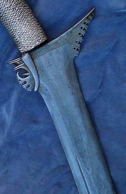

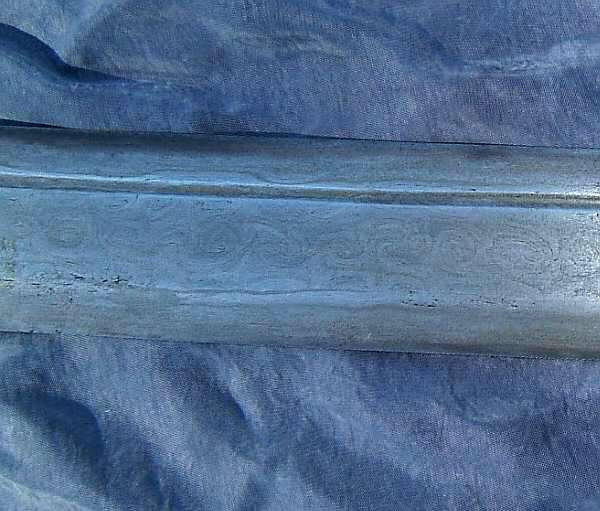

Old 28th September 2005, 03:36 PM   #12
Posts: 6,441
Talking Another Maranao Twist

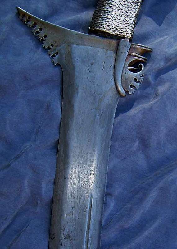

Hi George here are some detail pictures of another Maranao twist core kris .
This blade has a wide shallow fuller incorporating the single twist ; you can also see a longer less distinctive 'arrow' feature on each side of the blade . In the case of this particular example I cannot help but wonder if this feature helps to incorporate the applied edges with the core for extra strength .
Pardon the much manipulated pictures as this blade is not topographically etched and the details are very hard to bring out .

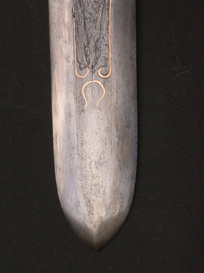

Old 27th September 2005, 12:51 AM   #13
George
Join Date: Sep 2005
Posts: 6
Hi All,
I noticed my last photo submittal was a bit out of focus after uploading it. Here is, I hope, a better shot.
George

Hi George, very nice Moro keris you got there. I personally sell Moro swords for some time now and haven't seen something like it. May I ask where did you get this beauty?
Charles
