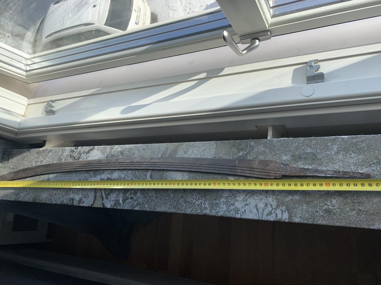

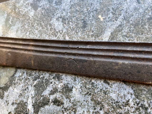

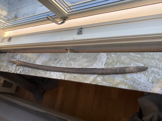

Hello everyone . Please need your opinion about this blade.

Interesting blade, it looks old, mid to late 17th Century in my opinion, how long is it from shoulder to tip?
Andrea Ferrara was a 16th Century blade maker that exported a significant number of swords to the British Isles. They had a reputation for quality, especially in Scotland.
In the time honoured tradition they were subsequently widely faked with the Andrea Ferrara name appearing on blades made well into the mid-18th Century. My suspicion is that your blade was made outside of Italy, most likely in Solingen, for the English or Scottish market.

Hello,tnx for answer . Total 96 cm
That’s with the tang? If it’s just the blade that’s very interesting. Thats the kind of length you’d expect of a cavalry sabre. In which case you’d be looking more towards Eastern Europe than the British Isles.

Posts: 314
Although you do find these blades on East European sabres, usually they have short tangs and 2 holes because since they have riveted handle contruction, not peened. This one looks like it had a peened construction handle. The tang is also kind of long ~14-13cm. Hungarian and Polish, 16th century ones also tend to have big yelmans like this one http://www.vikingsword.com/vb/showpo...5&postcount=27. So not likely 1500s to 1700s East European in my opinion.

Another thing is the double shoulder where the tang meets the blade. Could give an indication of what kind of hilt it had.

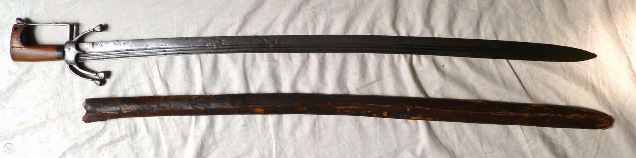

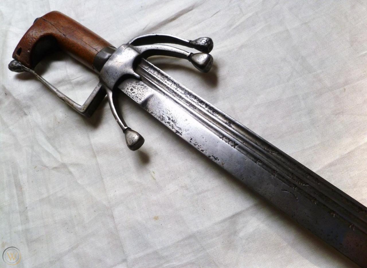

Could have been a wide variety of hilts... even a Moroccan saif/nimcha hilt. I know of at least one nimcha currently being sold with the same profile and the "Andrea Ferara" markings (including the single r misspelling), although with my limited experience I can't tell if the mounts are original to the blade (the hilt looks possibly recent to me but since it's on sale I can't post pictures).
EDIT: Found one that was already sold with Ferara markings (though slightly different ones), pic added. Although again the grip may be a replacement judging by how it doesn't quite fit the guard.

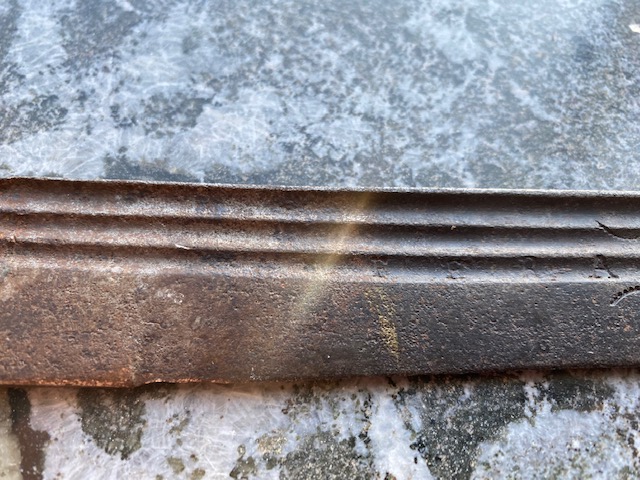

A very similar blade appears on an Italian Storta in Ivan Kovac’s book ”Ubojite Ostrice” (Gornja Stubica, 2003). This is the sword #49 in the picture below from the same book. This picture was previously uploaded in post #2 in a previous thread: http://www.vikingsword.com/vb/showthread.php?t=28557.
The description states it’s a late 16thC Italian Storta, with an overall length of 76cm and a jelman shortened to 5-6cm. Mark of serrated arches whose tops are surrounded by three points. [Translated from Croatian using Google translate.]

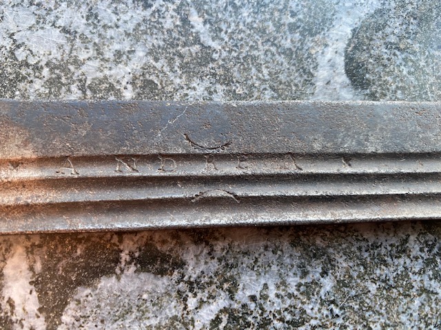

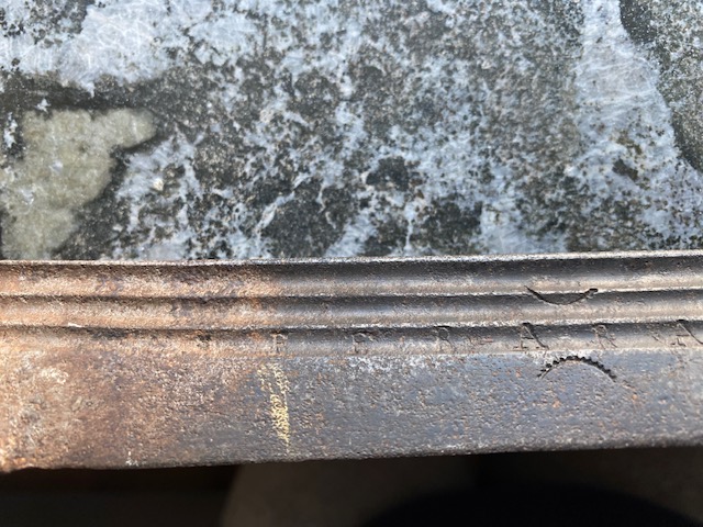

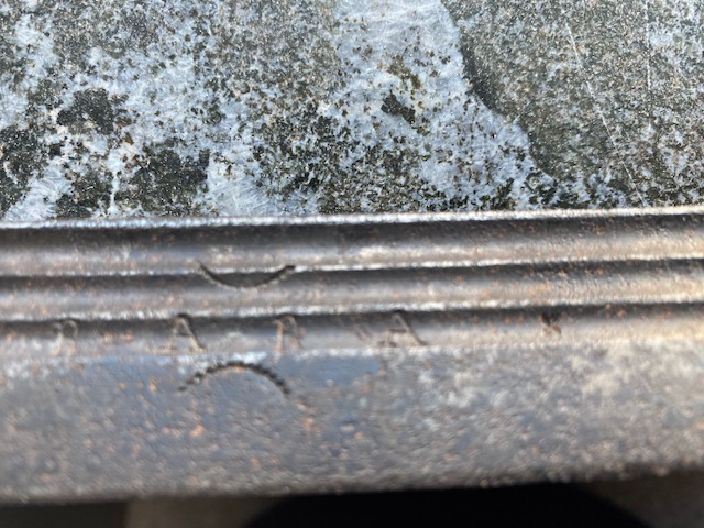

Aspalathos, has your blade been chemically cleaned from rust? Typically marks and inscriptions appear as black on an antique blade. Maybe it’s just the light in the photo?

As others have noted here, the length of this blade is notably longer than the Italian 'storta', which were shorter heavy bladed swords typically.
As has been noted here, this is most certainly a cavalry saber blade, most likely late 17th c into early 18th and East European.
The comparisons to similar multiple back fullers how how prevalent the Italian blade conventions were in continuing blade manufacture in major European centers. In my opinion this blade is probably from one of the Styrian centers, as they typically supplied East European, especially Hungarian sword makers.
The use of the Genoan 'sickle' marks were often applied with other names etc. and added as quality inducements, a convention of course most well known with German examples particularly Solingen.
This same idea in Solingen with the use of ANDREA FERARA was of course almost a standard in producing broadsword blades for the Scots primarily in the mid to latter 17th century. While this name was indeed that of a famed Italian maker of the 16th c. whose fame ironically came primarily from being ubiquitous on the trade blades using his name later, it does not seem that he actually made blades for Scotland himself. This 'legend' is complex as it has been well traveled since being described by earlier arms writers but there is no evidence the true Andrea Ferara (or his brother) ever went to Scotland, or Spain as has been suggested as well.
It has become somewhat accepted that the Scots were drawn to the name for its implications from Latin, (ferara =iron; andrea= good, true, and the patron saint of Scotland St.Andrew). This notion was cleverly employed by the Solingen makers as a sort of 'brand' favored by the Scots. It is in my view not usual to see it on Styrian or East European blades, but again, these conventions were not confined geographically.
It is of course not as usual to see ANDREA FERARA on curved blades, but of course was not as prevalent as on straight blades. The Scots did have occasion for curved blades on basket hilts (called 'turcael') but notably an exception.
The 'yelman' was a blade feature well known on early Oriental sabers which traveled to the Middle East, and was widely favored on East European blades.
Though in many cases dramatically notable, it became more subtle as with this one, where it is simply a widened distal end of the blade, as with its purpose the add weight to the cut.
As noted in the discussion, ANDREA FERARA trade blades often turn up in native context in various spheres with cases in India; North Africa and on 'nimchas' as shown.

No, I didn't touch blade
