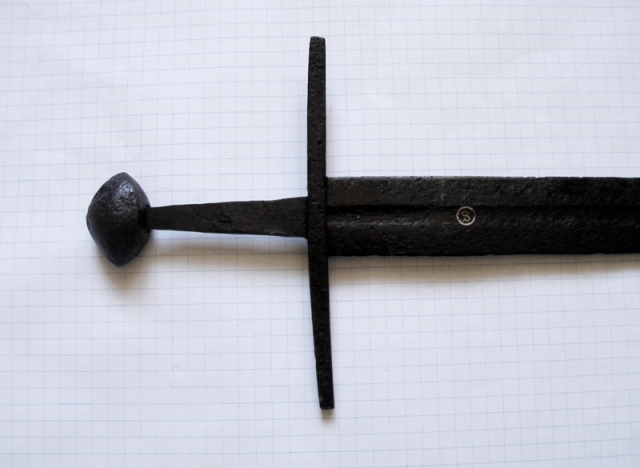

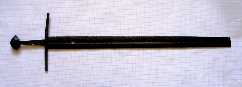

Sottopongo agli amici del forum questa spada con la lama rotta.
Ha due marchi in argento, uno per lato.

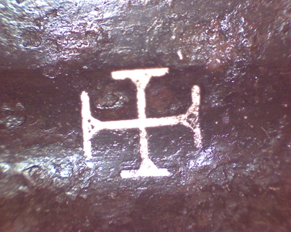

Il primo è una croce con bracci uguali. Secondo Musciarelli, nel suo libro "dizionario delle armi", è il marchio di uno spadaio svizzero del 13° secolo (vedi foto - marchio n° 39).

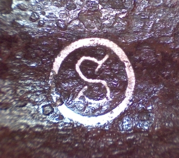

Il secondo, una "S" in un cerchio è per me sconosciuto.
Qualcuno è in grado di aiutarmi ad identificarlo?
Molte grazie
a presto
Cesare
Hello everyone
I submit to the friends of this forum a sword with broken blade.
It has two silver marks, one on each side
The first is a cross with equal arms. According to Musciarelli, in his book "Dictionary of arms," is the mark of a Swiss swordsmith of 13th century (see photo - mark No. 39).
The second, an "S" in a circle is unknown to me.
Someone can help me to identify it?
Many thanks
Soon
Cesare

If i look at the pictures it seems to me the marks are in a remarkable good condition. Too good in my opinion for a sword with that age.
I hope with this two cents opinion from me the more knowledgeable members will jump in.
Is the tip really broken? If so, some good close ups of the break could give some more information. Or is the tip not broken but is this an executioner sword?

This seems like an Oakeshott Xa, brazil nut pommel mid 10th into late 11th century. The brazil nut more common in Central and Eastern Europe.
While Gyngell and clearly others (as noted here by Cesare) have associated this 'cross potent' (kruckenkruez, crutch cross) with suggestion of a Swiss maker c.1200, this cross was in my opinion, not a makers mark, nor restricted to Switzerland nor that time period.
These crosses were applied to sword blades, often with inscriptions, and typically invocations intended to offer talismanic protection. The practice of placing crosses on sword blades and scabbards dates much farther back.
The 'S' is another thing entirely, and may indeed be a production related mark, while quite possibly another religiously associated symbolic. The use of silver seems quite unusual, as usually these marks were inlain with iron or latten, and as noted the condition of the silver does not seem commensurate with the well aged sword overall. Perhaps the existing marks were inlaid with silver later?

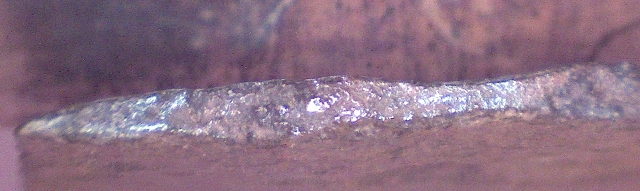

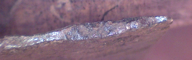

Originally Posted by Henk
Cesare,
Ecco le foto al microscopio digitale. è realmente una frattura avvenuta all'epoca. Infatti, le superfici di frattura hanno lo stesso livello di corrosione della lama.
Here are the photos to digital microscope. Is really a fracture and occurred at the time. In fact, the fracture surfaces have the same level of corrosion of the blade.
