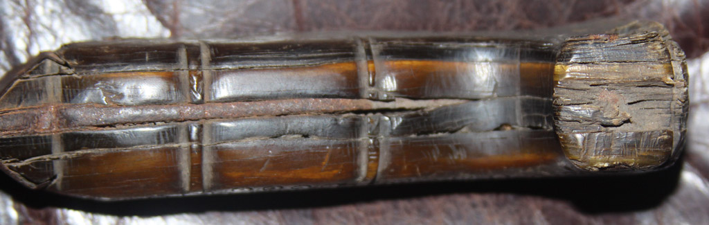

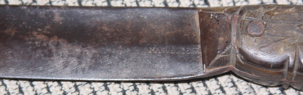

Question For comment: Possibly a 'Berber saber'
Received from EF:
I found your website while trying to research a sword I found last year. I found it in an antique store in Gettysburg Pa. It wasnt Civil War related and they just wanted to get rid of it. I gave them $45.00 for it because I thought it looked cool. I am trying to find out what it is, how old, where from ect. The blade is curved and fullered like a cavalry sabre. the tip is strange like it may have been broken and reground. The handle is made of horn with iron rivets. It is decorated on one side with small circles. There is no guard on the grip. The only markings are the name Manuel Deja on the blade near the handle. Any information you have on this would be greatly appreciated.
Old 24th September 2010, 11:47 AM   #2

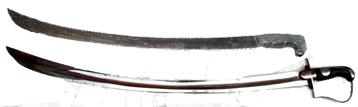

blade looks a lot like a british 1796 light cavalry sabre hatchet point blade that napoleons troops feared so much they tried to have it outlawed, because of the fearsome cuts it made. many other countries emulated the style. (the point is supposed to look like that)
a lot of 1796 sabres were given to the portuguese by wellington. maybe manuel was portuguese? part of the inscription seems to go under the grip bolster/scales & the full tang construction may mean it was cut down from the pommel end.
(the brits themselves feared the sabres of the indian troops they faced in later years, only to find they were recycled (like your one?) 1796 LC sabres, the main difference being the indians sharpened theirs where the brits by then were indifferently sharpened & dulled in their metal scabbards by drawing/reinserting alot.)
north africa seems to be home to a lot of re-handled european blades.
as always, dimensions, blade/hand grip lengths, widths, thickness, weight will help. see attached. comparison only valid if dimensions fit 1796 blade=32.5-33 inches.
heck, it could even be mexican/spanish colonial with a european trade blade - See This Linky to another thread here
1796 LC sabre photoshopped comparison:

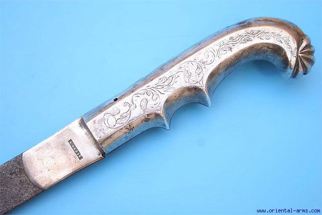

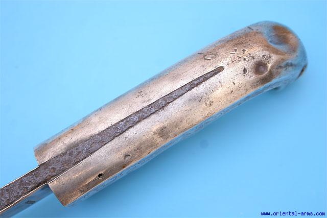

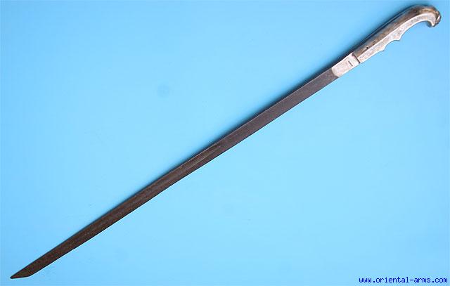

Not quite the same.....but Artzi had this sword ....a spanish bladed berber sword.
http://www.oriental-arms.co.il/item.php?id=91
Regards David

... 'Manuel' may either be Portuguese or Spanish, but the name 'Deja' or started by 'Deja...' can not be Portuguese; so its Spanish by exclusion...
Even for Spanish is a bit of a bizarre composition .
Could it be that a space should be considered between 'DE' and 'JA', so as to be 'MANUEL DE JA ...' ?
Thia would open the door to a few more plausible names ... still Spanish, i would say .

I fatfingered the name its manuel deje not deja. It is almost identical to the sword on this link.

Another sword on Artzi's site with a description relevent to the thread...
".......Spanish Colonial sword is the common name for these rare and unusual swords, however, where they were used is not very clear. It was attributed to Spanish troops serving in Spanish Morocco, and/or Philippines and/or Cuba and other Central America countries....."
Although the hilt is of different material there are slight similarities...also the idea of a sword 'travelling' to the US ...from North Africa via South/central America seems remotely possible.

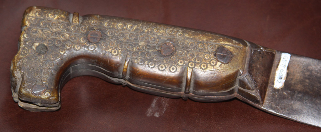

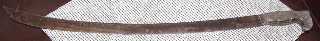

Old 25th September 2010, 04:46 PM   #15
carlos
Posts: 755

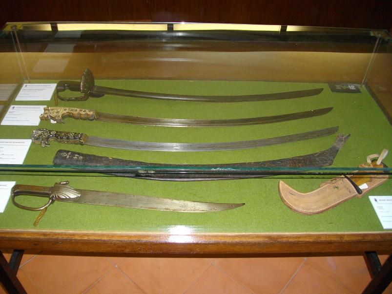

I think this type of blades are from Spanish aerea, In the military museum of Montjuich, Barcelona ( now closed ) there are similar examples, with a example of espada ancha and a chile corvo Knife.
Best regards
Carlos

Muy bien Carlos .
This is it.
I have been here before the museum closed. Great collection; i took pictures of that espada ancha, but they came out very poor.
I wonder what the labels say about the two sabres similar to the one posted; you mention Spanish area, but is it peninsular Spanish, Colonial Spanish, Spanish with Moorish influence?!
What do you think?
Hello Fernando!!
I think is spanish but with moorish influence, I cant remember labels at the museum, but I think moorish.

In #15 by Carlos, the excellent grouping here includes the top sword with full shellguard, which we discovered about 3 years ago to be a Brazilian form of espada, and a type established with provenanced examples. These also are known with British blades.
Items 2 and 3 are of course the 'Berber' type and as noted, these guardless hilts are often reflective of 'Moorish' influence either from Morocco or in some cases other Spanish colonial regions carrying Andalusian style. Many of these hilts have the eyelet pierced presumably for lanyard or sword knot, and many are in much cruder even wooden handles, probably reflecting local variation.
