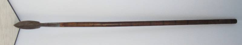

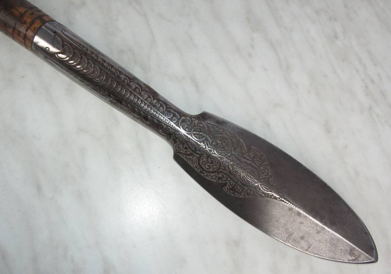

Hi,
this just finished on eBay.....unfortunately not mine...my larger bid failed to register .

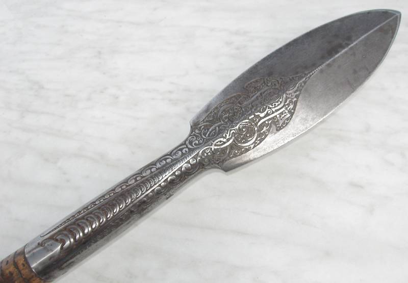

A very nice, chiselled decorated spear which appears to be wootz ...a vague pattern seems evident. I would be extremely interested in other opinions, I feel it sold well under price. Any ideas as to age, use (seller suggested Elephant spear) etc would be greatly appreciated. If a formite bought this and wants to start their own thread please let me know.
http://cgi.ebay.co.uk/ws/eBayISAPI.d...=STRK:MEWAX:IT
Kind Regards David

Looks European to me. 1890s onward.

Possible boar spear with bars removed?

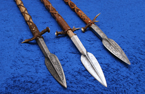

Hello i also think this is a boar spear.
If you search for "Saufeder" (that's the german term) you will find a lot of examples.
btw. the typical Saufeder has no metal bars but a piece of antler fixated with a leather wrap just below the metal fitting.
At this position the wood of the presented spear seem to be roughened as to provide better grip for such a leather wrap.

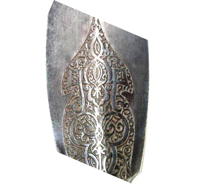

The chiselled designs originally, for me, appeared Indo-Persian ..or British Raj ....the trisula motif for instance. The scales on the socket could have been a reference to the Naga ....with the blade as its tongue. However, I see now that the trisula could also be seen as a 'fleur de lys'. But the overall arch shapes etc still have an Eastern or Arabic feel.
As I said it may be wootz as there were faint patterning marks.....if wootz it was still 'pointing' ( ) to Indo-Persian (or Middle East origins).
The blade profile suggested, perhaps, a hunting use. (wide, sharp edged head used acurately, would 'cut' vital arteries easily).
I had considered a boar spear, and tiger and....but the lack of 'wings' / toggle didn't make sense. Incidently boar hunting was very popular in India....

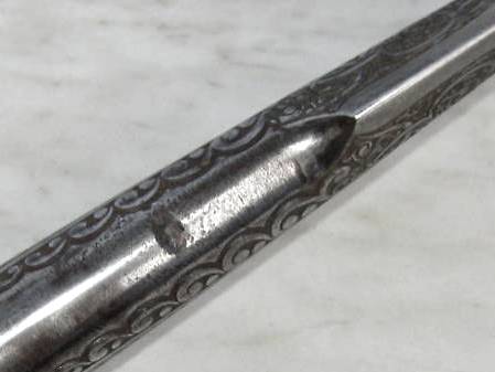

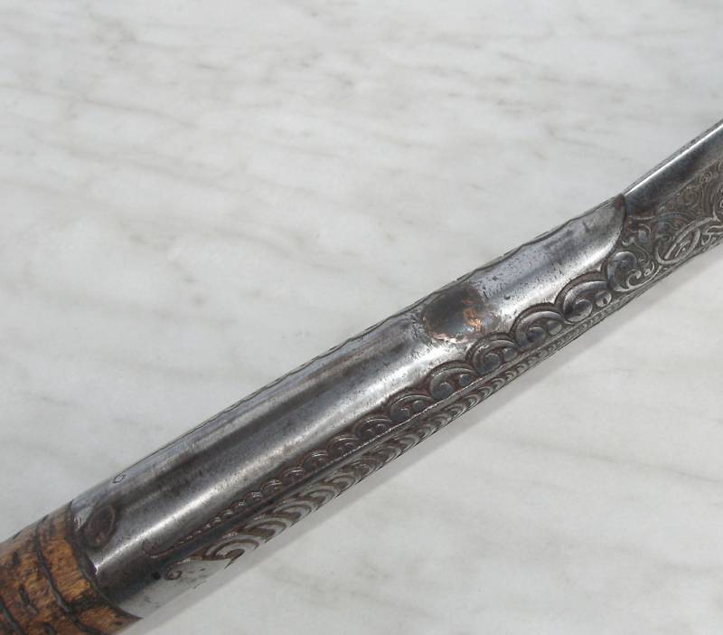

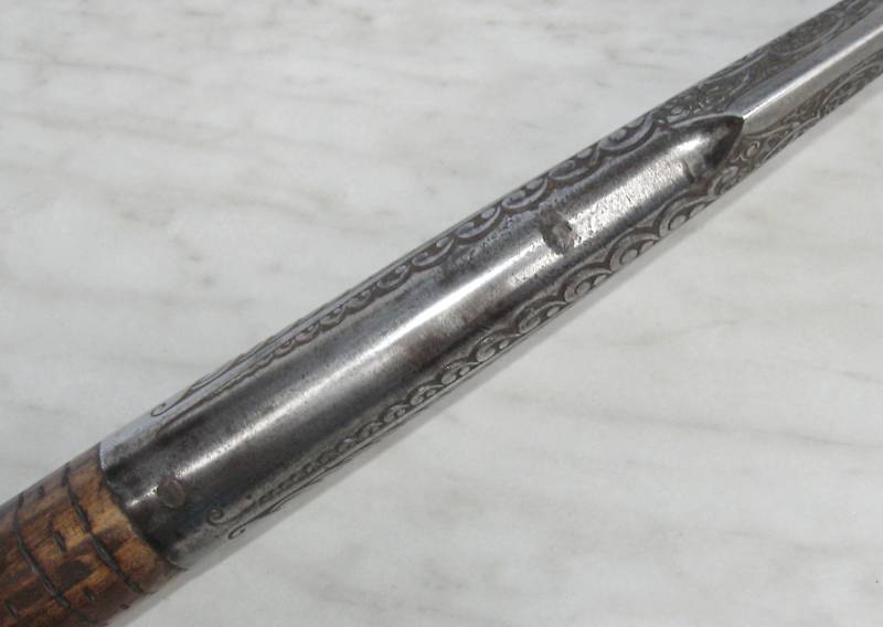

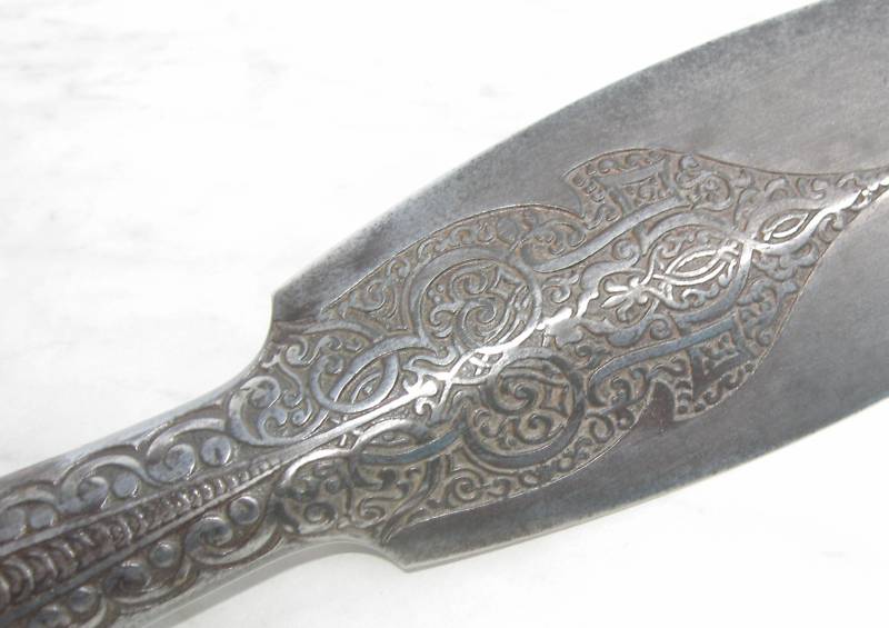

PS Gene I did wonder whether the 'heat' marks on the side of the socket where the remains of 'bars' ....but had concluded that these were rivets heated and peened over, and then finished 'level' with the socket , but obviously I could easily be wrong.
I hope the pictures below show the patterning in the metal's surface that I first saw..

One thing though, I did also look at the filled holes on the upper part of the socket.
I did think that they are possibly the remains of some kind of projection.
Were they to secure the shaft, they seem rather close to what must be the end of the wood (inside the socket) and I would also have expected them to match the lower ones in shape and size.
Boar spears can have bars or flanges as we all know, perhaps these marks are from removal of something?
