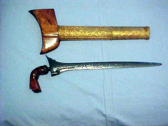

Here is what I understand is a sultan's Bugis keris that once belonged to Rsword:

I know that a lot of gold is royalty, like the keris above, but what about, say, a couple of bands of gold on the scabbard, or not as much gold on the piece?

gold dress on keris, esp Malay, no matter how little or small amount, is forbidden to commoners.
BTW, the keris blade in the pic looks very Jawanese to me.
