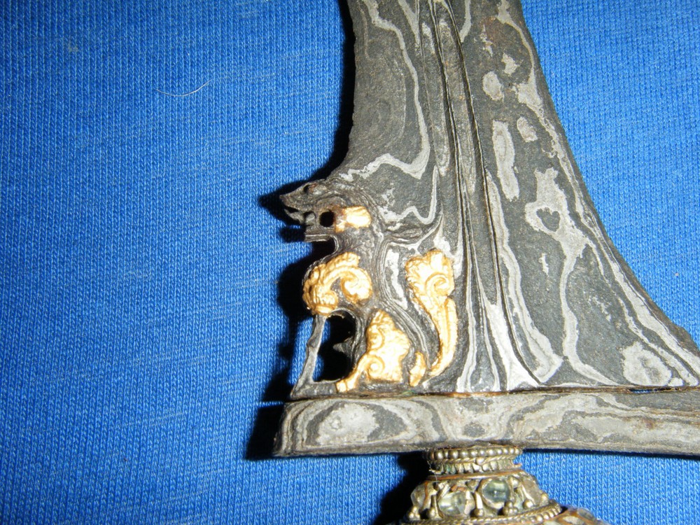

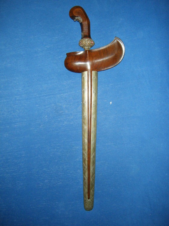

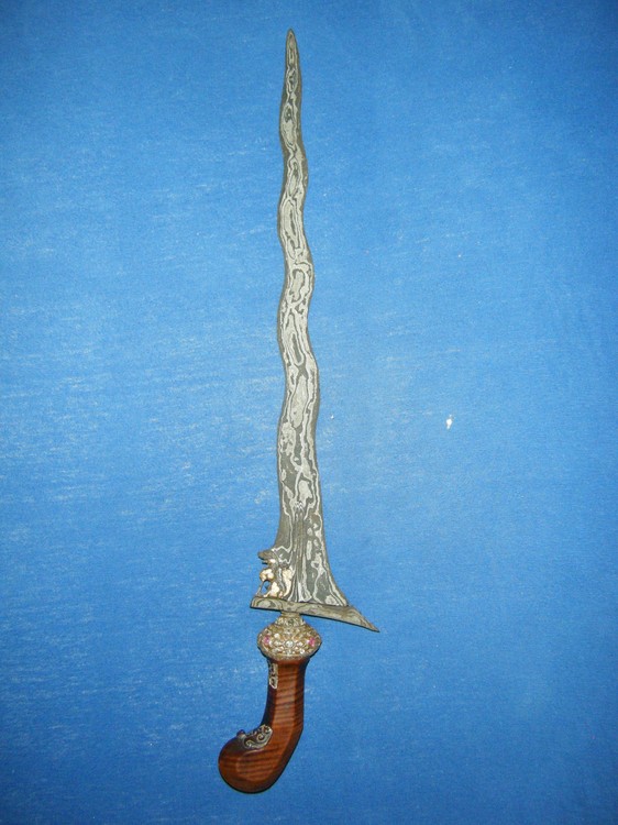

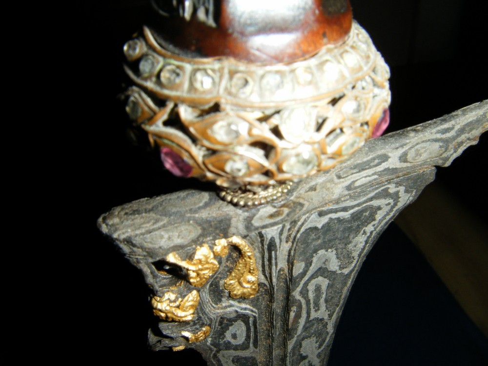

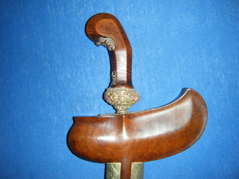

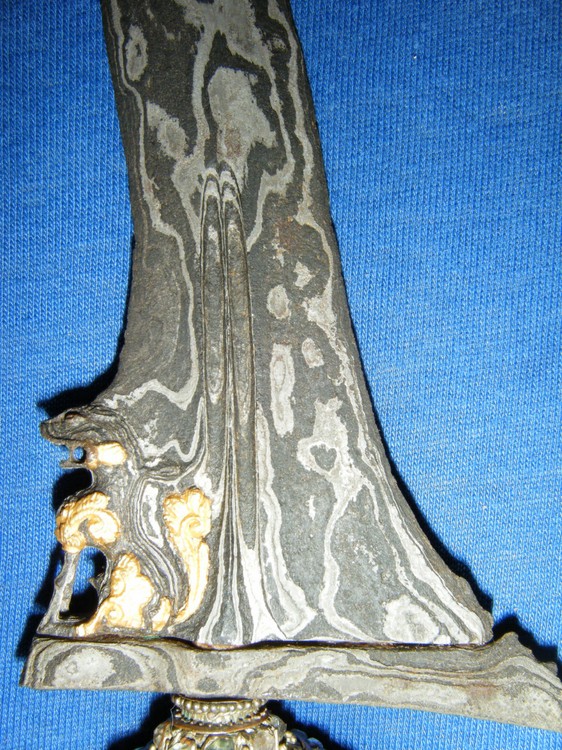

this keris is already long in my possession. I have got it with this sheath which isn't apparently the original one but I changed the pendok blewah and handle inclusive selut and mendak to better ones because both have been simple. I like to read your estimation if the blade is old with the singa barong or if you think that the singa is a later addition or if you think that the complete blade is recent and artificially altered to look old since I am very unsure about this. I byself can't see any indication that the singa is a later addition.

I like a lot your keris (also sarong, rings, pendok and hilt). IMO the blade is OLD ....and singa too. Maybe gold work has been done in a second time
Hello Marco,
thank you! This is my assumption as well that the gold is renewed.

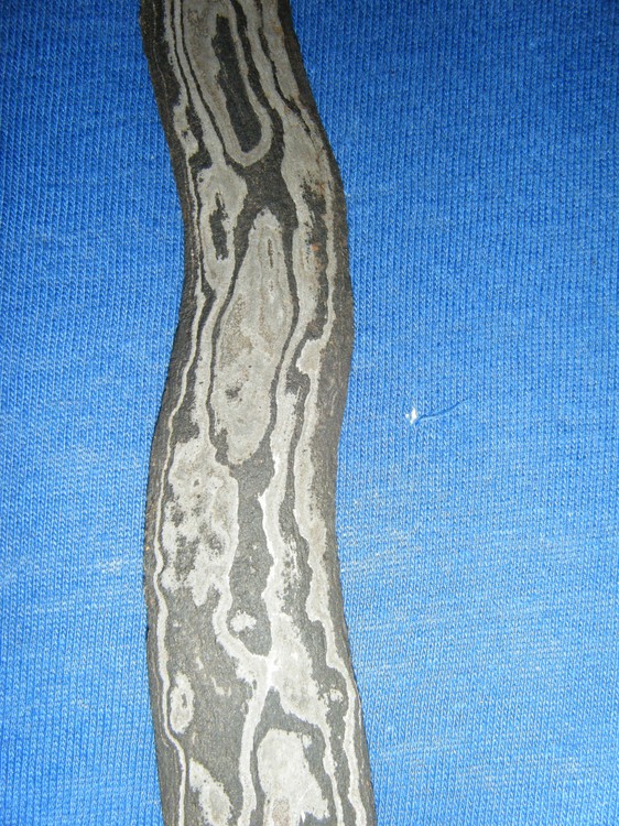

To me the blade seems old, pamor looks like Madurese. Suspicious probably: the blade itself has 6 layers, singa 12 or more. Maybe (or surely) I am wrong. The layers seem to continue in the body of singa.
Actually we should expect a singa probably only on a special, high quality blade? Yet all seems possible in Madura.
Thank you Gustav for comment. I think too that the blade is from Madura or East Java, it was purchased in Surabaya.

IMHO the blade looks Madurese and old from the rough pamor style and carved details (greneng) especially but I have some doubts about the Singa Barong even if it looks original at first glance. Although it is difficult to give a definite opinion from the (good) pictures, there seems to be a lack of continuity of the pamor lines at the Singa head for instance, the pamor lines look denser in the Singa area than on the blade itself, and the colour looks slightly different. By the way can anybody show us another old Madurese blade with an original singa?
