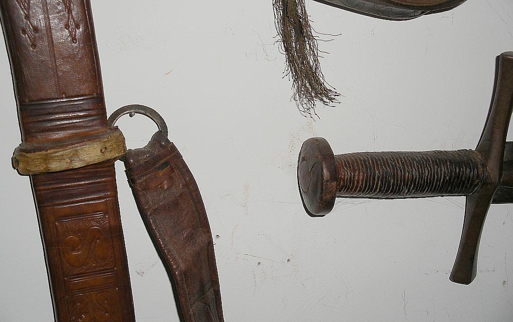

Hi Wallace ,
Here's a detailed picture with both hilt and suspension ring shown .
I believe the scabbard mounts may be thicker leather with a different, lighter hide band tacked over it .

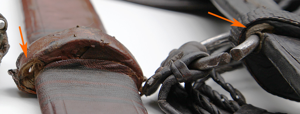

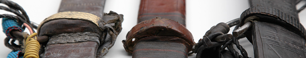

Fortunately - for your purposes - some of my kaskara scabbards are in poor repair. Interestingly, on two of these scabbards it may be seen that the bulk of the suspension mount is made of layers of fabric. The fabric is then overlain by the overall outer covering leather layer and then a further applied decorative leather layer may be added on top of this.

WOW! Rick and Lee those help a lot. I feel like Leeuwenhoek looking through a microscope for the first time.
The fabric wrapping looks interesting. I wonder if it was not only cheap, but acted like plywood? The several layers making a stronger loop.
Rick, on your scabbard, does it look as if the mount is over wrapped by the main leather covering (under the lighter band), or does the main covering abut the mount, similar to how Lee‘s middle scabbard looks?
I’m still not sure about the pommel though. What’s under the plug on the end? Or is that the end of the handle? The disc appears to be leather wrapped?

The leather sheath cover overlaps the thicker suspension ring band .
I would damage it if I pulled it back .
The suspension rings on this scabbard are triangular in cross section and probably German Silver , decorated and welded or soldered .
I'm as confused as you about the hilt construction; the pommel does seem a ring most likely wood . How they wrapped and capped it on the hilt I just cannot figure out; but, at least you have a picture .

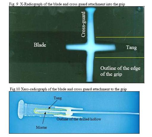

Hi Wallace,
you'll find this picture (xray) quite useful Originally posted by Stephen Wood......

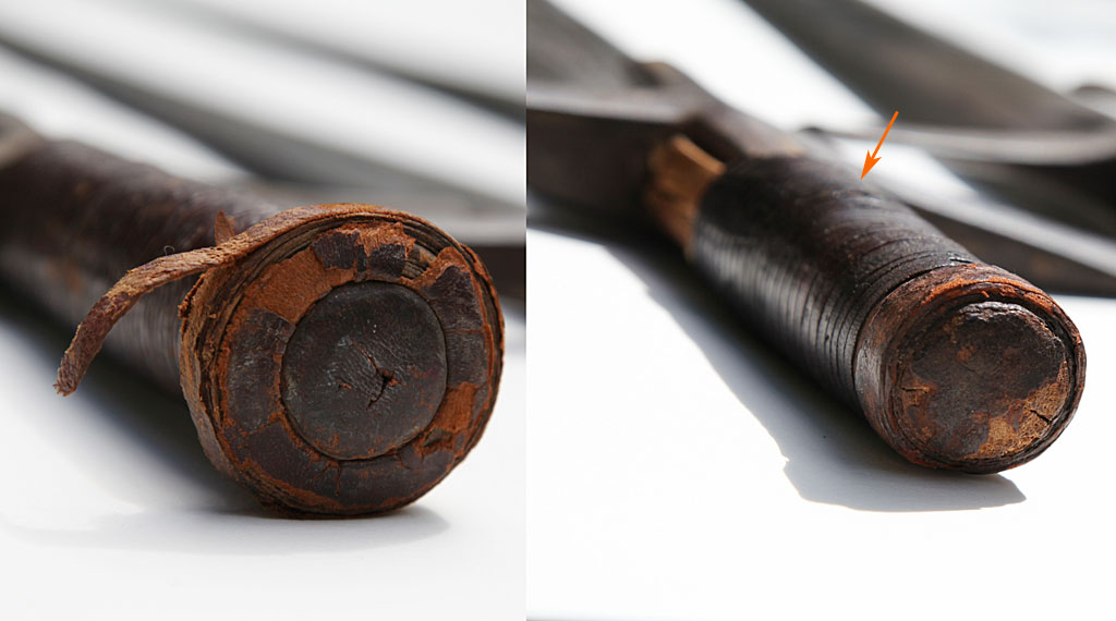

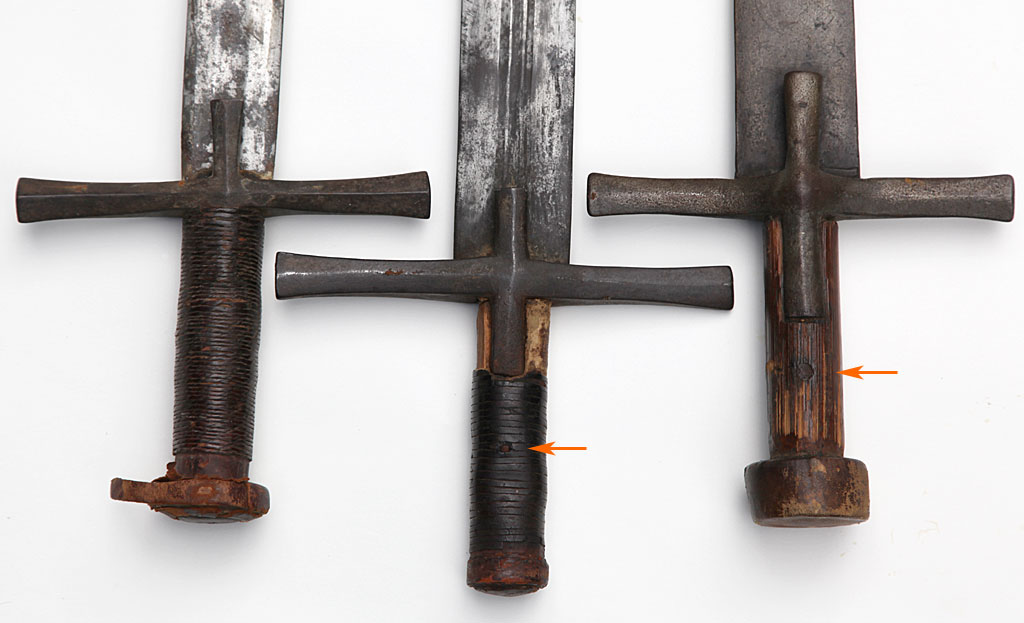

I have found obvious cross-pins securing the hilt on two kaskara hilts (seen in the top picture below); another which has lost its leather covering and is bare wood (not shown) has no evidence of one.
The bottom picture shows two hilts where the pommel appears to be made up of layers of wound leather.

One last question: is the pommel build up of leather (spiral wrapping with a leather washer on top), or is it wood?

Fearn, the pommel in my picture above on the left is indeed a concentric buildup of wrapped thin leather - and I suspect the one on the right was of this same construction.
