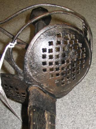

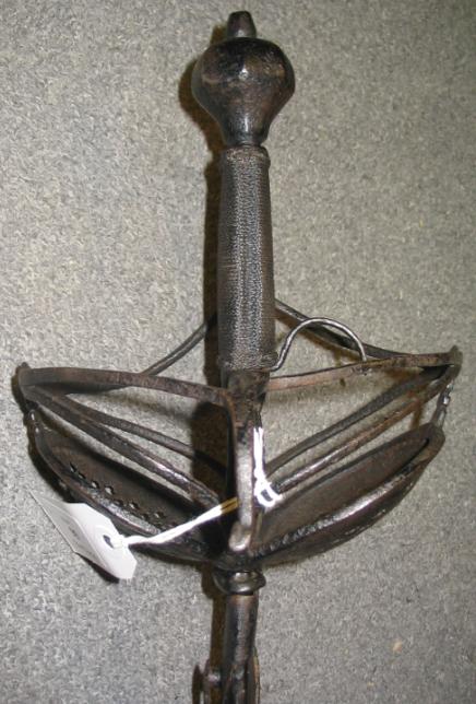

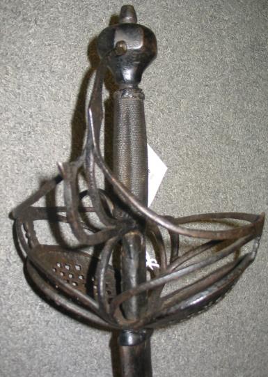

I'll let the pictures speak for themselves.
Opinions are welcomed of course. As would be info and dating Looks early to me.
Blade seems like it might clean up to a reasonable level.
Old 8th June 2010, 07:41 PM   #2
Hi Gene,
Lovely relic; is it yours?
Don't you have Norman's book?
Let's ask Jim if he agrees this has a pommel #60 ... or the likes of it?
A hilt not distant to #84?
Definitely a sword from the first half XVII century?
As if i knew something about these things
Anyway, if you struggle a bit, i can accept it as gift .
Fernando

Hello Buddy.
Yes its mine, bought it today.
Don't have access to my limited books at the moment
But I don't have 'Normans'
Where to start on the conservation/cleaning?
Old 8th June 2010, 08:03 PM   #4
Originally Posted by Atlantia
... Where to start on the conservation/cleaning?...
No where .
Maybe (maybe) some inocuous conservation stuff; something innocent like olive oil?
Let's see other member's opinion .
Old 8th June 2010, 10:36 PM   #5
Posts: 10,871
Thank you Fernando!!!
Nicely done Gene! This appears to be closest to hilt #55, which is a cuphilt rapier with alternating quillons probably Continental, N. European c. 1625-40
("The Rapier & the Smallsword 1460-1820", A.V.B.Norman, N.Y. 1980).
It appears that similar hilts were also produced in Toledo about the same period notably by Tomas Aiala. There is great similarity in hilts in these periods following popular fashion, so often it is hard to categorize with definition.
I would proceed with great care and reservation in conserving this piece, and most important is stabilizing any active rust. The patination is pretty solid and trying to work into it would not only compromise the integrity of the sword, but its value, potential damage notwithstanding.

Yep, early 17th C. The pommel seems intended to really balance the weapon, thus its the Real McCoy.
Olive Oil works, yet will darken metal.

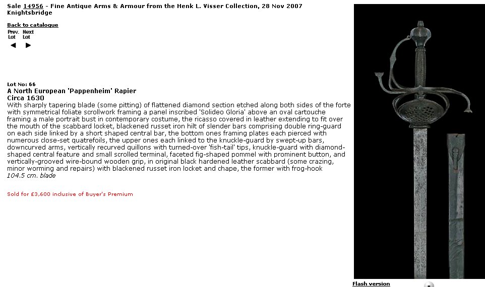

Hi Gene,
This is a German type so-called Pappenheimer Rapier, Thirty Years War, ca. 1630; there are examples known that are dated 1632 on the blade.
A very similiar in perfect condition and retaining its original sheath was sold from the famous Henk L. Visser collection, Bonhams, London, 27 Nov 2007, and now is in the collection of a friend of mine. Please see attachments.

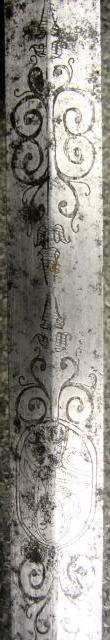

When cleaning the very delicate blade please note that there must be a fine central ridge visible all the way down almost to the tip.
For a start, please use olive oil together with 240 grain sandpaper and work your way down to 600 or 800 grains for the final finish, always with a thick layer of olive oil between the iron and the paper.
Please also note that the pommel and hilt were originally blackened; I would therefore suggest to confine your cleaning action to the blade and just blacken the hilt and pommel by tannin which you should get in any drug store; leave it to dry for two or three days, then put a thick layer of olive oil on both the blackened parts and the cleaned blade and let the whole dry for ca. 6 weeks. You will then get a best possibly recovered and patinated surface, and a conserved one as well; the dried olive oil will stay there and prevent the fingers from getting thru onto the iron surface.
I, and I am sure I am not the only one here, would love to see some pics of the result!
Michael

Thanks for the research, it kinda confirms my thoughts. Well, I thought 1620-30, but a few years later is still fine really.
Manolo,
Thanks
To be honest I think the pommel is my favourite bit! Its such a beauty!
Michael,
Thank you for your research. To be honest (and without looking through my books which I don't have access to at the moment) I didn't think it was 'quite' a pappenheimer, so thats a most pleasant suprise!
The 'Bonhams' sword is an absolute beauty! Would that I could happen across one of that quality

Default Slight correction of dating
After discussing Gene's Pappenheimer with my sword collecting friend I must ask whether the blade is one edged. If that is so, and telling by the hilt, it seems that ca. 1645 (late Thirty Years War) would be a more accurate date.
Michael
