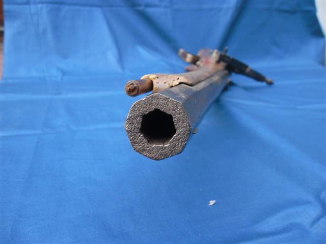

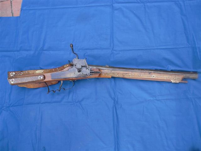

Hello everybody, my first post in this section and it has been some time since my last post on Ethnographic Weapons, but reading often.
I have come across this wheellock musket that i want to share and learn about it since i don't know much on the subject. Specs are as follow
German stock ? decorated with inlay and engraved bone, pronounced cheek piece and trigger guard shaped grip
Total lenght 88.5 cm
Octagonal barrel lenght 56 cm
Outside diameter of barrel (flat side) 3 cm
Bore diameter 1.5 cm
V-shaped cockspring and trigger mecanism inside lockplate
No marks anywhere
I hope for coments on date, period, area of provenance and any other info anyone can share to help identify or document this firearm.

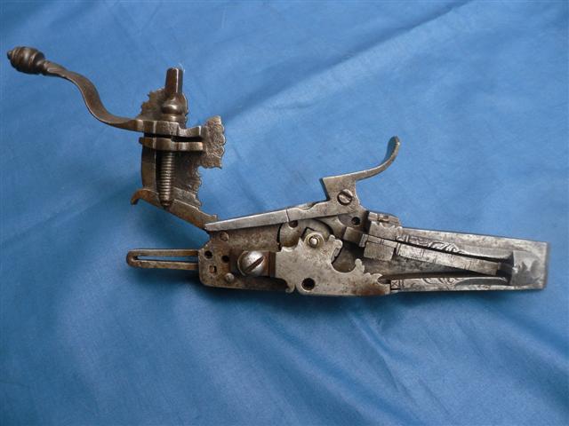

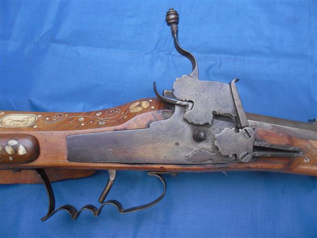

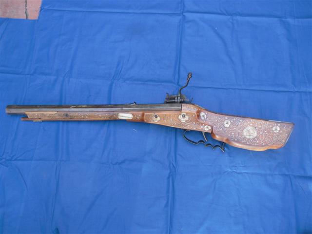

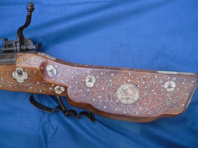

Hi Cylord,
This is not a military musket but the remnants of a ca. 1760 East German or Polish wheel-lock short hunting rifle (German Stutzen); the horn inlay in the stock might be original, then it's Silesian. Most probably though it's a 19th century 'embellishing' work.
The lock is of the plainest and latest form, with some elements missing from the left inside - see screw holes! The trigger is a crude replacement. As it is a rifle, it must have had a set trigger which is also missing now. The fore end is broken off, and so is the ramrod finial.
I would not even touch it, to be honest, but then, my fellow forum members know that my standards are strict and uncompromising. This does not have to be true for everybody - to each his own!

Michael, certainly it is a hunting rifle, i could figure it out for the animals engraved on the inlay. What i don't know is if the term musket is use only for military and rifle for hunting ?. . Is there something to look for or a way to know if inlay is original or later embellisment please let me know. As for the holes on the left side of the lock, one is for the screw to attach lock to stock, the other one i don't know what it stand for, but not for a transmission chain as this is not a self spanning wheellock. The trigger is not a trigger, it is a piece o small diameter rod flatten on one end and screw it through a hole to the inside of the stock. The broken fore end has been smooth out but up to a point as to not to interfere with inlay work (later embellisment work?). There are other broken parts like both ramrod holder, one is almost completely missing and the fore end one is only half (both were done using same material as inlay, bone), it has also some stock repairs. Can you tell what does the sliding piece of the stock and its compartement/hole is for. My compliments to your knowledge and following strict standards is the way to go, thanks.
Fernando K, michael is correct the rifle is short but heavy and the stock is too big for a boy's hand to properly reach and pull the trigger, saludos.
