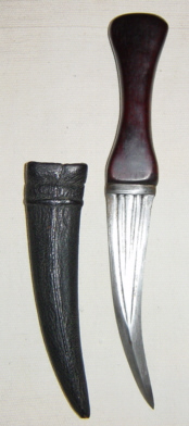

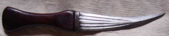

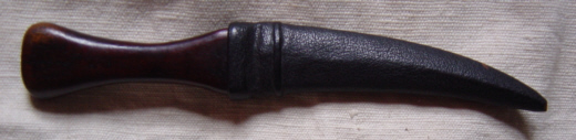

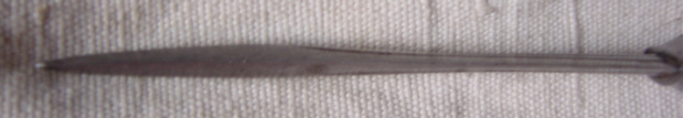

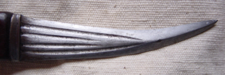

Just aquired this morning,things like this are most often over my budget but this being plain might limit its appeal.Some of you are keen collectors of this area,can you tell me more about it.I had suspitions about the leather,after checking with an eye glass it seems okay.OA length 265mm, blade135mm,armour piercing part 9mm thick.Many thanks for any help Tim.
Old 20th March 2005, 03:09 PM   #2
tom hyle
Location: Houston, TX, USA
Posts: 1,254
Interesting. Looks like a decent old blade. The lack of a sharply defined central line to the base of the blade may have struck some as a modern feature, but I'm not sure they'd be correct. In conjunction with the continual curve, rather than the more common 2 stage curve, I wonder if this is the tip from a larger blade.
Old 20th March 2005, 04:25 PM   #3
Jens Nordlunde
Jens Nordlunde's Avatar
Location: Europe
Posts: 2,718
Yes Tom, I got the same feeling, especially when looking at the second picture from the top. I also had another feeling - or wild guess if you will - that the blade could be from a katar.

It's got somewhat of that look; it's the curve that throws me, of course. The curved katars I've seen were the rivetted blade kind, and thus likely made from the remains of obsolete swords their own selves? Whereas the ones with the groove/panel base and the thickened point are usually of the integral/welded blade type? I'm probably speculating based on too few examples here; I definitely see what you mean about resembling a katar blade......if nothing else this may suggest regional origin.
Old 20th March 2005, 05:07 PM   #5
Posts: 6,000
I was sarting to think that,so I have looked again with my jewellers loop and the blade is forged from a reserve of metal rectangular in section with no sign of grinding.After the perusal of a few publications there is the distinct possiblity that it is Afghan/Indian where the metal pieces either side and riveted through the blade is a common form of construction and may help explain the deviation from a more classic or conventional form and also why I could afford it.Tim

Posts: 2,718
I still think that something is wrong with the proportions. I you, in your imagination, makes the blade as long as the tang is, or maybe a bit longer, then I think the proportions will fit.

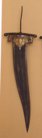

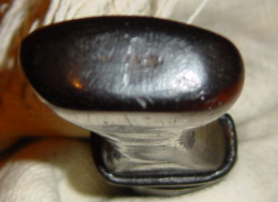

I hope I am not labouring a point,but I like illustrate what I am discussing.These photos are not very good but the best I can manage.They show the filling of a cavity, giving evidence to a tang of some length and that the blade is not just attached to a piece of wood.Tim
Old 12th September 2005, 08:54 PM   #10
Posts: 6,000

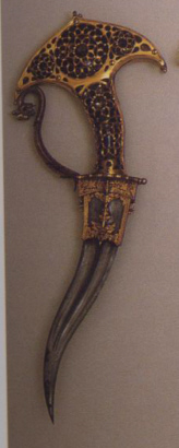

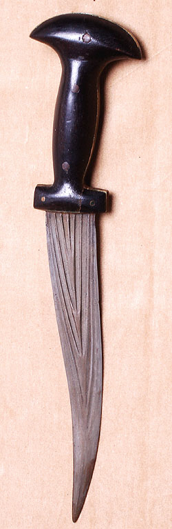

I have finally got a copy of Elgoods book Hindu Arms And Ritual if a triffle late, how very splendid it is. One thing it has brought to mind is what a good book Tirri published is, althought a little light on discussion, it does work as a general reference and gives most collectors the opportunity to say " I have one much better than that! " While on the subject of Elgood, now tell me the proportions and construction is " not right" Tim

The two daggers you compare with are different, and with different length of blades, as you dagger is quite another type you can’t compare them. Maybe your dagger was made like it is now, and maybe the blade was a bit longer from the start, we will never know – but it is a nice dagger all the same.

i do agree with jens' theory. the two daggers in elgoods book are of a specific type and both recurve. the blade in tims dagger is different. the two deccani daggers are similar in shape, and have a very slight armour piercing tip (hardly at all), and not thickened to the extent of tims. also, the hilt is not southern in form. this was typical of rthis style, and not inherant in just these two examples.
i think it is a re-used blade, and could possible be the shortened katar that jens mentioned. its a little odd that the fullers just start, although this could be misleading.

I am aware that the pictures are of different daggers. I was trying to illustrate that knives and knife dimensions do not follow a strict rule book and would vary according to the competance of the many manufacturers and wealth of thier customers. Even in Elgoods book which is only highlighting some of the best production the variation of similar fullered knives is a good many. With these weapons to assume one type is the law is a little simplistic. We are not talking bayonets for a 303. Tim

I would also like to point out that the fullers on this dagger do not come from within the handle. The knife has a base which the bolster pieces are riveted to.It is outside of this on the blade that the fullers are forged and I can only assume the tang is similar to the dagger with the tang showing from Elgoods book. I am making a bit of a fuss but it is all to easy to brush things aside. Tim

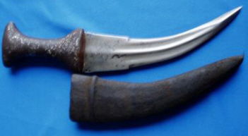

This has recently finished on ebay. It is just a little similar in style. Tim
