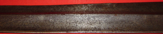

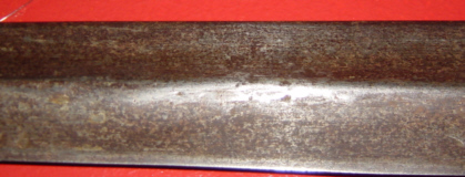

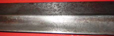

I found this knife yesterday at a big antique market in Brugge (Belgium). The man who sold it to me knew very little about this weapon. He was told it came from Africa. He sold it together with a spear blade which was in fact a keris blade. So I don't think his information is very accurate.
The knife is forged in the same way as many African knives are forged. There is no actual middlerib. The blade seems to consist of two halves put together. In fact, it's made in one piece, but it looks that way. A lot of African blade are made in this fashion.
This could mean it's from Africa. What tribe or what region, I don't know. Probably a region where there was a big Arabic influence. Could even be Congo...?
On the other hand, as it was found together with a keris blade, it could also be Indonesian in origin. I know that jambiya type knives were found in Sumatra.
If someone has any suggestion, that would be great.
The knife measures 37 cm. The handle is 9,5 cm long and made of wood. It has some carved decoration. At the top of the handle, the 'butt' consists of a small roll of metal.
The size of the handle is too small to fit comfortably in my (European) hand. The blade is sharp on both sides.

It doesn't look at all like an Indonesian Jambiya to me anyway.
Michael
Old 26th September 2005, 12:51 PM   #3
I'd second that - hilt doesn't look SE Asian at all.

It could be very well a beladau. The sumatran or kalimantan jambiya. It is my first thought when I saw this one.
I'm not very good in the african region,but my feeling tells me that it hasn't the african look.
And when it came with a keris blade..... It could be the remains of a bring back collection of a deceased relative.

Looks African to me. The handle reminds me of many congo knives. The forge work looks very much like that of Massi spears. It could have influences from the eastern congo and west from Arab east Africa like Mombasa. I really like the decoration on the handle. Tim

Thanks for all the input, guys. But the knife's origin still isn't clear to me. Judging from the way the blade is constructed, I still feel inclined to think it's from Africa. But I'm really not sure.
Here's another pic of the hilt. I noticed that I showed the back of the handle. The front has some more decoration.
Someone suggested Kuba, because of the geometrical decoration.
Old 27th September 2005, 05:58 PM   #10
Posts: 6,031
Interesting picture, there is a superficial similarity of metalwork on the blade. I would say that the handle form and decoration, particularly in its simplicity was African. Tim
