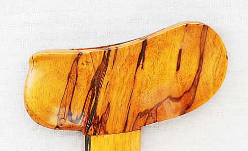

Only rarely do I let things slip from my hand .
Then they have to be fixed; this was a badly shattered wrongko.
Learn by doing ......

Hi David,
Carpenter's wood glue; it dried a bit darker than I thought it would.
That end of the wrongko is all end grain carved thin so when this area hit the floor the piece literally shattered; almost impossible to get the edges lined up perfectly and miniscule pieces were just plain missing. I had to reshape the wrongko a slight amount to get it anywhere near decent looking.
The repaired area was finished with 3 pound cut orange shellac; lots of coats, lots of sanding in between.
I hope to never do such a thing again in my lifetime.

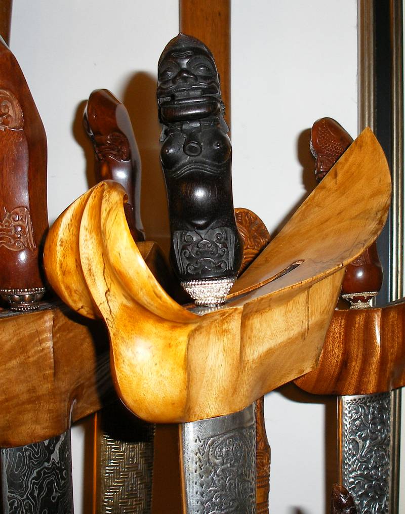

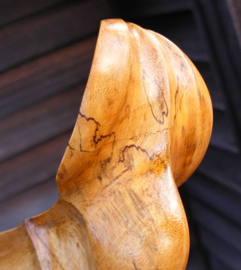

Sometimes you can get big holes in a gandar, or dry rot in old atasan. The best thing to fill these holes is plastic putty---I've used some stuff called "Plastibond". Again, you tint it with artist's colour. Over-fill, polish back. With a gandar you need to fix some sort of support for the filler inside the hole ; a thin piece of bambu is good for this, just epoxy it in place on the inside, and then you can fill to your hearts content.
I've put up pics of this wrongko before, but its a good example of what you can do with epoxy and colour. I did this repair many years ago, but the when I got this wrongko, the top part was in pieces, and the gandar had big holes in it. The dark brown patches you see on the left hand side of the gandar are patches of Plastibond. Some of the brown graining in the top part of the wrongko is tinted five minute epoxy . The finish is Birchwood Casey Trueoil.
I reckon that it is possible to fix just about anything that might be damaged in a keris, or its wrongko.
Old 23rd December 2006, 09:46 PM   #6
Posts: 6,441

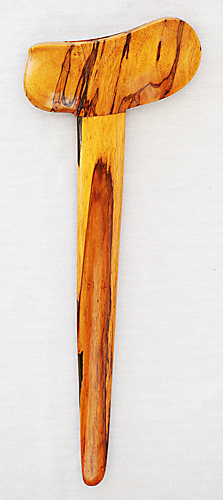

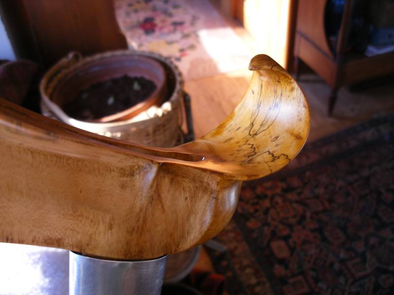

Hi Alan,
The first picture is the completed project; the other two close ups are in-progress photos.
The first few coats of shellac were wiped on then the last coat or two was applied with a brush and wooled then hand rubbed.
Brushmarks?
Me?
Never!
I'm very picky about final finish.
I hope the glue holds up.

Hi Rick,
Even with flash and at such close distance, the damage is not very obvious. I think you did a great job!

Posts: 1,248
Rick, excellent work. Nice finishing touch, hardly noticeable.
Wood pattern does help.
