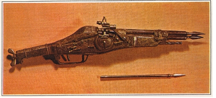

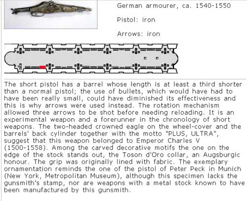

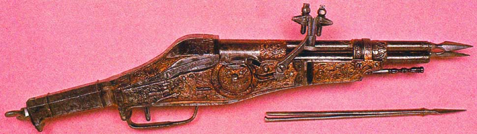

Default Unusual wheel lock triple barrel pistol

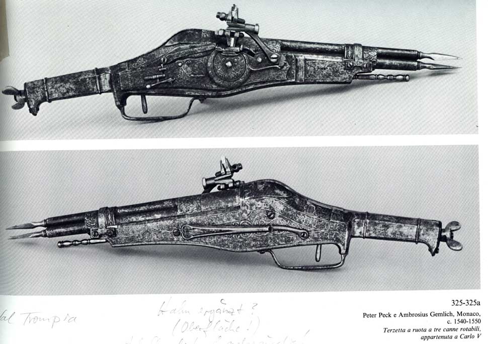

I wouldn't be surprised if our expert forumites know this thing inside out.
This pistol resembles the exemplar that belonged to Emperor Carlos V; is of the same type and dates back to the first half XVI century. Carlos V was of great support to gunmakers dreams.
This specimen shown here is of the wheel lock system and was used for shooting darts with the propulsion developed by gunpowder gases. Its three rotating barrels were alternated by a cog mechanism.
This picture was scanned from a 1978 thematic agenda.

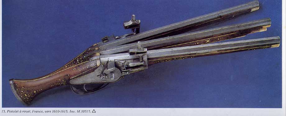

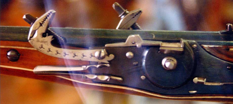

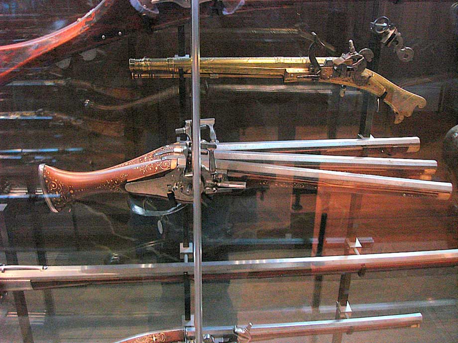

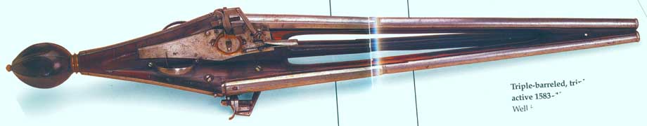

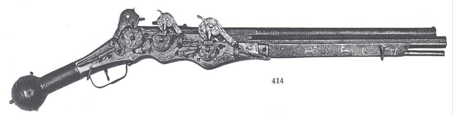

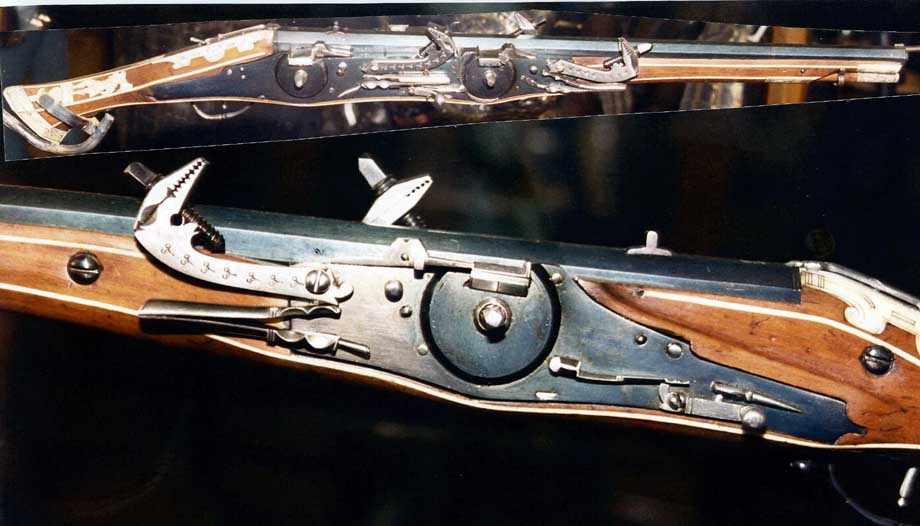

Default More multishot wheel-locks
The "duck's foot" pistol in the Musée de l'Armée, Paris, ca. 1625-30 (the dating "ca. 1615" given by the museum is too early)
The others, from top:
Hofburg, Vienna, ca. 1560
T.W. Dexter scrapbooks, 1950's, ca. 1580
The Art Institute of Chicago, ca. 1610

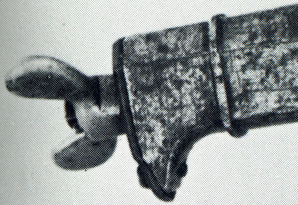

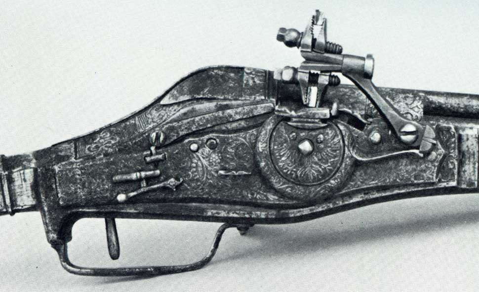

Some more details of this arrow firing specimen. Unfortunately this is all I could find in my comprehensive library (ca. 3,000 books and catalogs on European A&A).
As Fernando has pointed out, it was made by Peter Peck, Munich, who furnished several firearms for the Holy Roman Emperor Charles V (including this one), in ca. 1550 and etched and gilt by Ambrosius Gemlich, also Munich.
The wheel cover is etched with the Roman Imperial Eagle; a highly unusual feature is the dog with its swiveling reserve pyrites' head and jaws.
The sickle shaped dog spring running around the wheel cover is a characteristic technical feature of the 1st half to the mid 16th century.
The measurements are:
overall length: 41.5 cm
barrel length: 20.5 cm
caliber: 7.2 mm smoothbore
weight: 1.810 kg

Edit: And by the way, what a piece! I'm surprised to see a wheel-lock still clinging to the archaic approach of propelling darts, however; could anyone enlighten me as to why that approach should still have been taken so late in the day, so to speak?

Looking at a text in post # 5, a certain explanation is given for such atypical situation, although one wonders if such is the real reason.
OTOH, we can read that Carlos V was the personification of gunsmith's dreams and, his love for fine arms was so great that he supported the development of a great school of gunsmiths in Spain.
Can we say that imagination and creativity may be applied in specimens not necessarily provided with the latest projectile invention. They become even more rare and exotic, worthfull of Emperors with exquisite tastes.

As to dart/arrow firing firearms: this curious idea, after the early 14th century times when it was taken over from the crossbow/bow, has been renewed again at again at times from the 16th to the 19th century - most probably mainly for curiosity and the will to build something quite astounding.
