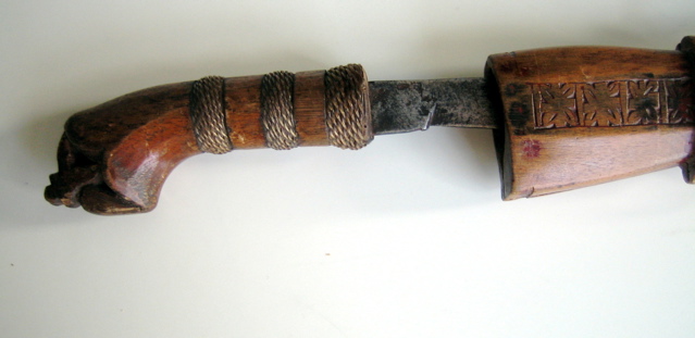

I'd be interested in seeing close-ups of the hilt. The pommel looks very Visayan in flavor...Cebuano in particular .

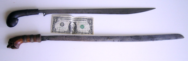

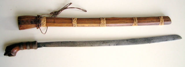

The Moro/Sumatran/Visayan/Peninsular sword has arrived.
Unfortunately it's dark here now but I hope that the enclosed pictures could be of some use.
I am still puzzled on what it could be.
I haven't had time yet to check all references but what's significant is the narrow blade.
For Ian, as well as a comparison, I have put it next to a regular sized Batak Kalasan as well as an US dollar bill.
Considering the size and weight it feels closer to a Kalasan than a Visayan or Moro sword?
Please look at the blade close to the hilt. That part reminds me of a Visayan feature?
I have a very thin Tenegre in my collection but it's still much heavier than this sword.
And the seller described it as a bringback from a "WW2 Pacific Theater Veteran" (=Philippines?).
So is it Visayan (a slim binangon?), a Batak Katungung or something else???
Michael

It looks like it s from borneo from the muruts the scabbard looks like it s made
in Sarawak not Sumatra

Thanks B,
Actually W also thought the hilt looked Borneo.
But why is it so light and small (compared to f.i. a Pakayun)?
And isn't the Muruts living in Sabah?
Michael
