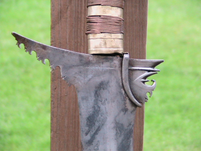

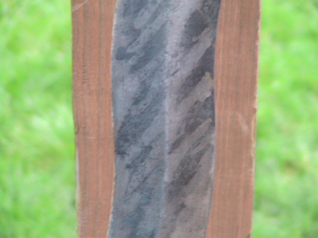

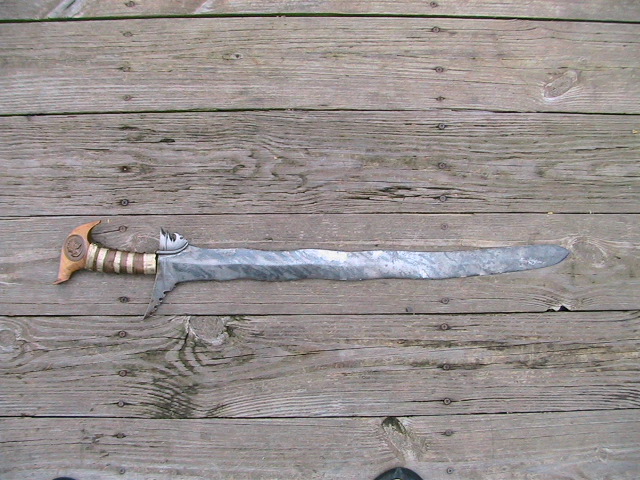

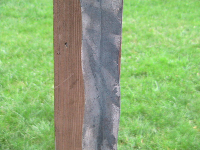

i believe these were blood splatters that was left to dry on this kris. the angles of the etch are very consistent with a slash. one the other side, about 9 inches to the point is black, which appears to be this side was facing the ground (therefore no spray mark). again, IMO, this kris was left out in the open for a while before it was picked up. by this time the blood already etched thru the blade. just my opinion

Spunjer, i remember when you showed this blade the first time. It seems unlikely to me that blood would lay so equally along the entire length of the blade like that. It was my impression that this patterning was some kind of forging technique.

the blackened area are actually pitted in the blade, giving it a rough texture, making me think otherwise. again, just my opinion...

I have to agree with nechesh ,the kris looks like its just showing its lamination,{I have a Moro spearhead with similar although much more faint lamination},left on the battle field or not,I think it would take hours and hours of soaking in blood before you might possibly have a permanant stain.

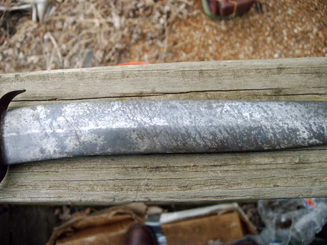

A Philippine dagger with what looks like the same staining. I believe these stains were made by someone who wraped the knife for storage or shipping and the cloth or paper it was wrapped with got wet. After being this way for an extended period of time the pattern you see is the result. Leaving a blade in a wet leather scabbard for a long period of time can do the same because of the acids used in tanning the leather. IMHO Blood being left on a blade would have to stay damp without being washed away for quite a few days if not weeks or even longer to cause this type of staining to a blade.
