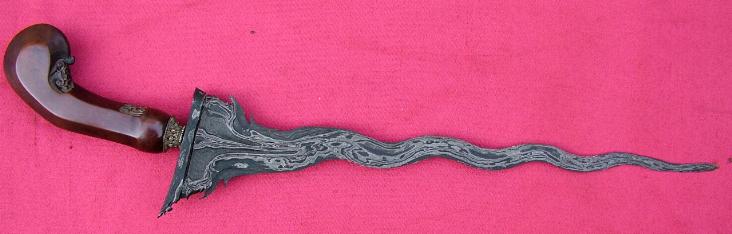

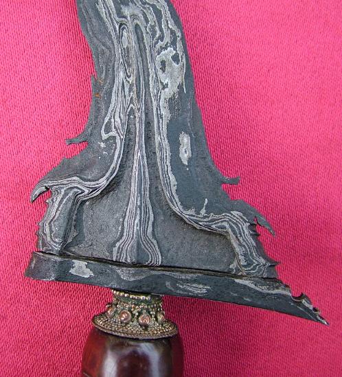

keris from solo
whit karna tinandung
regards semar

Default LUK 9 OR 11?
Just my humble opinion, Semar, your keris could be a 11 luks keris of carita keprabon (with sekar kacang, one jenggot and two lambe gajah) but "tinanding" (two sekar kacang), and not 9 luks. You may look at the tip of the blade -- it looks like too long, enough for one more short luk. (Please I apologize, if I'm mistaken...)

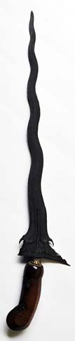

You may compare with my 11 luks (picture below) with two sekar kacangs too..

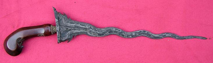

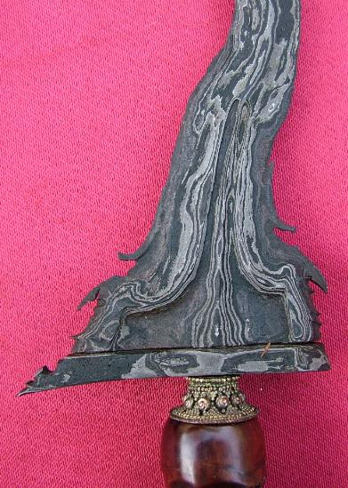

Looking at this keris of Semar's, there are a couple of things that strike my eye:- the distance from final luk to point, the apparent nature of the pamor, the odd little projections above the kembang kacangs, the method of workmanship.

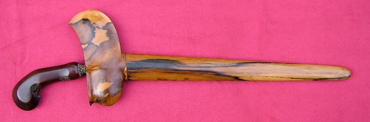

Then there is the mendak and the wrongko.
Where do you think this keris might be from?
