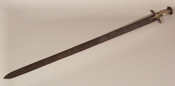

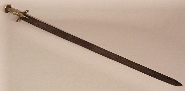

Here is an interesting sword. I think it is not indian, but a sudanese interpretation of a kirach.
ebay number: 310212690643

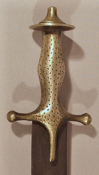

Very interesting anomaly, but I do not think this weapon has anything to do with the kirach. The hilt seems to be a relatively modern interpretation of the tulwar hilt, which remains largely indiginous to the Indian subcontinent. The style of the tulwar hilt itself did of course travel to SE as the piso podang, and the Deccani style hilt similar to the tulwar with drooping quillons went as far north as Afghanistan as the paluoar. Aside from these, the hilt was not adopted elsewhere except perhaps in one off novelty situations.
Naturally that is what is suggested here, and of course it is possible that an Indian hilt might have been joined with a Sudanese blade, as seems the case, but for tribal use in Sudan, for me very doubtful.
I have seen these Indian tulwar hilts joined with kaskara blades on one, possibly two occasions, and as I recall, in somewhat questionable context.
The optimistic version would be that an innovative Sudanese armourer might have assembled this, but more likely a later marraige of components.

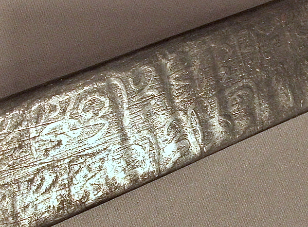

The distinctly Sudanese style blade with thuluth calligraphy is very much in the style of the Mahdist period, ending with Omdurman in 1898, and for a time afterwards there was a degree of production for the mounting number of British colonial market. These blades, nor the actual Mahdist blades, were not produced for export, so the thought the blade could have ended up in India via trade seems also unlikely.
An interesting item, and as always, look forward to the views of others with interest in this particular field of collecting.

Most of this is simply trying to determine whether a tulwar hilt sword with thuluth covered blade might have been present in Sudan during the Mahdiyah. In looking at this particular example, which is far more modern than that period, I think it is possible to be an interpretative production presuming that they were.
The brass tulwar hilt seems to have prevailed more to the sultanates in the Deccan and in the south of India and likely into the 18th century. The use of gold metal whether or not brass seems to align with Hindu beliefs, as described in Robert Elgood's "Hindu Arms and Ritual", although they are certainly not unknown elsewhere.

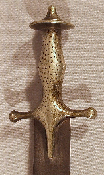

This example has a crudely cast brass hilt which is largely an impression of the hilt form with the random stamping overrall intended to recall some of the diaper patterns seen on tulwars in earlier times. There were cast brass tulwar hilts produced in some degree for Native regiments in India I believe, but I dont believe like this in style.

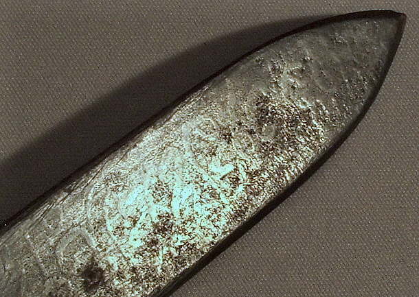

The blade seems simply sheet steel blank with beveled rather than sharp edges, and in profile similar to the kaskara blades. I do hope I have not overlooked any fullering, but to me there are none apparant.
