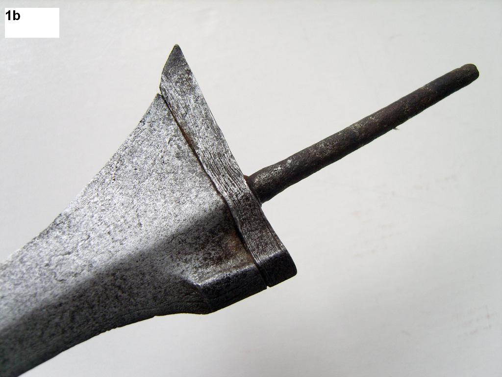

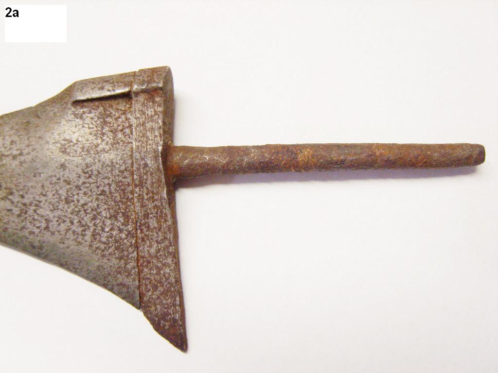

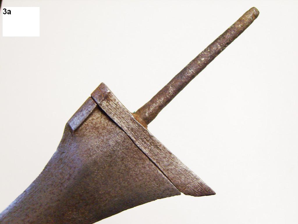

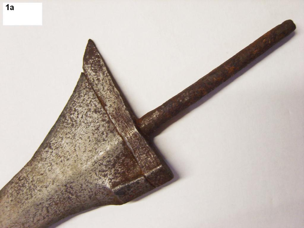

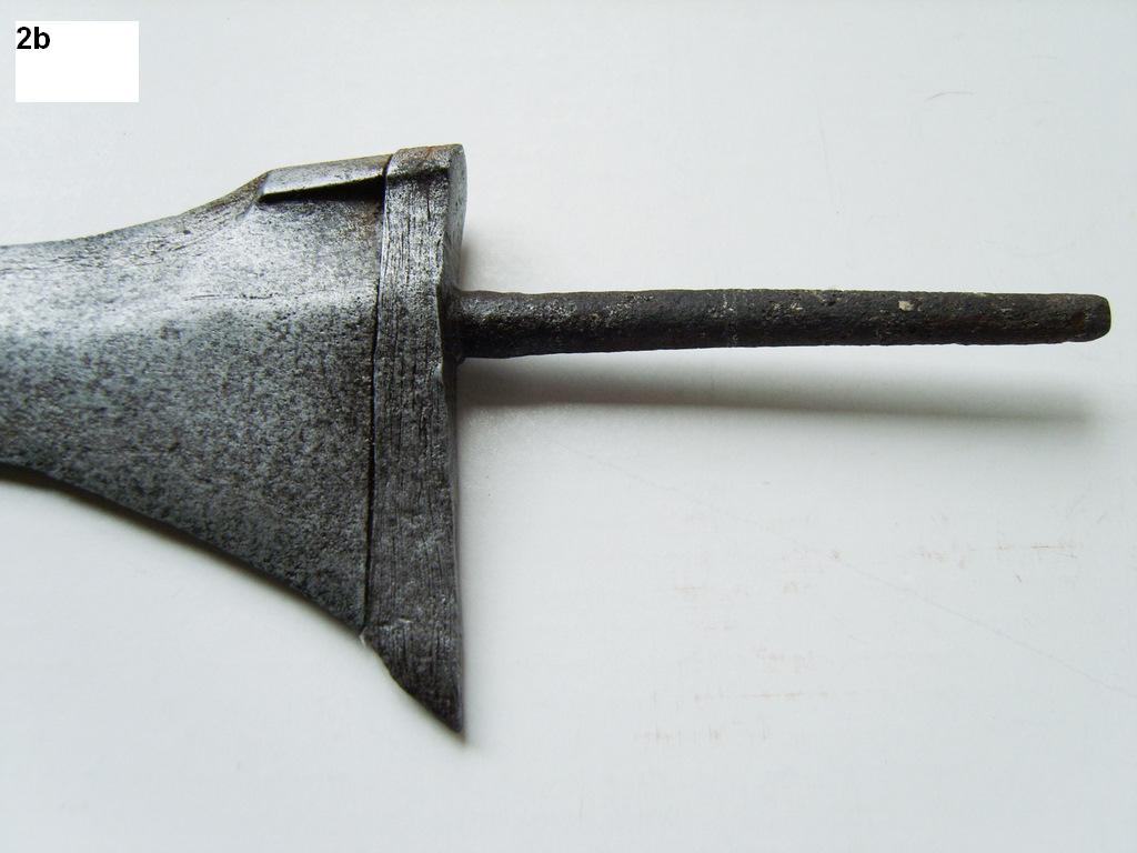

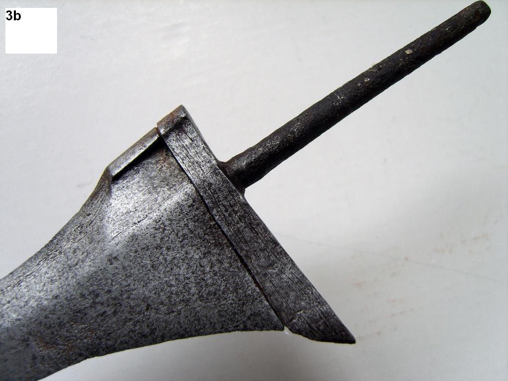

So today a container adapted for the job, and I have hung a rusty blade
for about 8 hours in the container.
And the result is very good the rust is gone, but this is not easy to see in the pictures.
This way, only the rust comes off without sanding or brushing and it affects the blade in no way no discoloration or whatever
Also the solution is not toxic (only the gases released are explosive so only use in a ventilated area!!)
These are the pictures of the first results,
(and any comments on the blade are welkom.)

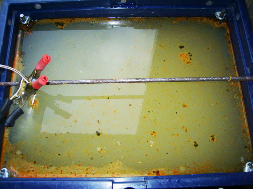

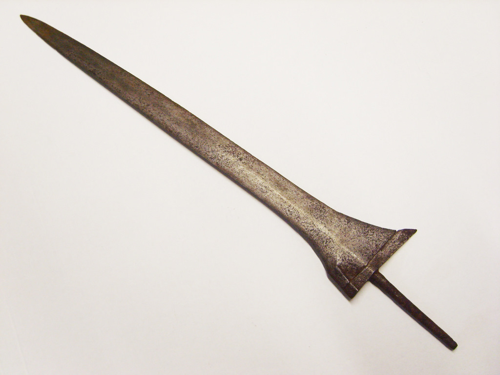

Posts: 172

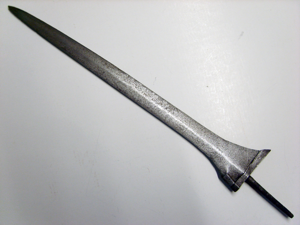

Arrow
and a picture of the whole blade,
and the container with the blade after a few hours
