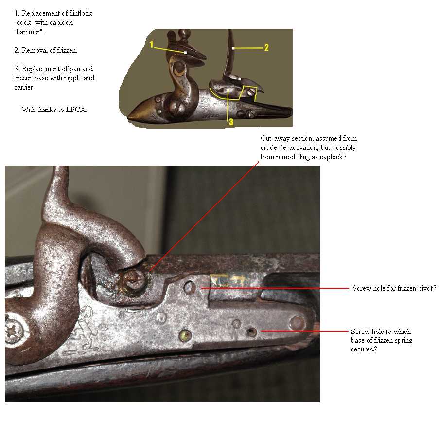

The gun bears all the characteristics a pig-ignorant civvie such as I (whose interest in weaponry is great, but whose experience is minimal) would expect of a jezail; long, eight-groove rifled barrel (43.25in, give or take a whisker, from where I think the breech plug probably ends to the muzzle) with flared muzzle, what appears to be a fairly old lock (at first sight), salvaged from a British military musket or rifle, and of course the highly individual, curious curved stock and oddly-positioned butt which seems to define these guns. Nonetheless, I wouldn't be at all surprised if it turned out to be completely different from my assessment.
The gun's condition is, frankly, pretty dire. The barrel and lock are both extensively rusted (seemingly fairly active, rather orange rust at that), and just forward of what was, once, the nipple of the caplock mechanism, it exhibits blue-greenish corrosion which I would associate with copper or its alloys (brass?). The lock sits very poorly in the furniture; I'd conjecture that either the lock was crudely inserted by an amateur gunsmith, or alternatively that the wood has swelled and cracked over the years. The gun is, as mentioned, a caplock; the lock plate bears a crudely-stamped date of 1817 in sans-serif numerals (the eight appearing to have been applied upside-down!), and a what seems to be an attempt to replicate the East India Company's post-1816 (?) "rampant lion" emblem, with dubious results. The lion faces left and seems to be holding something round; a helmet or similar? I don't know. The lock is the right sort of shape (that characteristic double-pointed banana) but has no border around its edge. Nor can I find any kind of proof marks or similar, though they might be buried beneath the tonnage of rust. The trigger is slack but still held in place by something; my guess is that, if the mechanism is still intact by some miracle, it seized up long ago.

The pic of the lock is not clear enough to tell if it is native made or production. Even if it is production large quantities of these locks were sold in the area into the 20th century. The piece is pretty much run of the mill. If it were my piece I would pull the barrel pour a few inches of water into and push a long rod with a worm or screw on it into it to remove any shot or ball and powder. Afterwards I would pour oil into it and soak the barrell and lock for a couple of weeks. Clean off all active rust and then wax the pieces. After the oil soak the lock will almost always unfreeze there are only 2 screws holding it in on the other side.

To respond, I had my misgivings about what is left of the lock from the outset. The sans-serif numerals certainly didn't seem right; no specimen of British lock I've ever seen (in my, I should add, very limited experience) from that period had sans-serif numbers or letters, and this page here gave my suspicions a boost. Likewise, the lack of a border around the lockplate (which as I understand it was pretty much de rigeur on British locks) and absence of any visible proof markings seem indicative of a fake. I've very gently removed some of the lockplate rust with a soft cloth and WD40, and apart from another "8", stamped just below the former location of the nipple, can see nothing more than what I've described above. On better examination, the lion seems what I can only call ragged; it doesn't quite match up to illustrations and photographs I have seen of the EIC lion, and seems more crudely inscribed.
Regarding provenance, I had a quick phone conversation with the donor on Friday and gleaned that he had good reason to believe it to be genuine, and that its condition was probably the result of spending some time in his garage; the British climate has struck again. It's rather unfortunate, but what little he could tell me led me to the same conclusion as you - that this particular piece was produced in a location such as Darra, perhaps as a functional weapon, but not as long ago as the lockplate rather optimistically claims. He also said that the weapon has been in this country for between 10 and 15 years, at least. I'm afraid I can't give any more detail than that.
My own particular theory - if you'll excuse my boldness - is that this gun, perhaps, was assembled relatively recently; certainly within the last century or so. I'm going to go out on a limb, and suggest that the barrel may be rather older than the lock. The lock itself, I'd guess, was either made to fool a foreign buyer into thinking it had been captured from a converted European flintlock (e.g. a Pattern III Brown Bess), or perhaps stamped with these markings at a later date than its original manufacture, for the same purpose. Would an Afghan/Khyber gunsmith bother with such things if he were selling the weapon to one of his own kind? I understand the Darra chaps still put so much store by the stamp "V.R" that, on occasion, one can find guns stamped with the V.R. cypher that also say they were made in 1952!

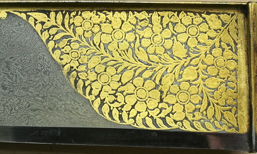

Watering or wootz you can see on the blade at the right side of the picture, the blade to the left is mechanical damask, but very skilfully done, it can be seen much cruder.
A steel blade keeps the edge very well, but it can be brittle and break, an iron blade is soft, bends easily but seldom breaks, and to this comes that it does not keep an edge very well – so to get a mixture of these two metals was important.
The last picture is from a Khyber knife, here the wootz is clear and you can even see how the koftgari was made.

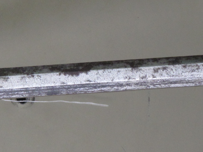

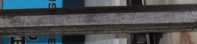

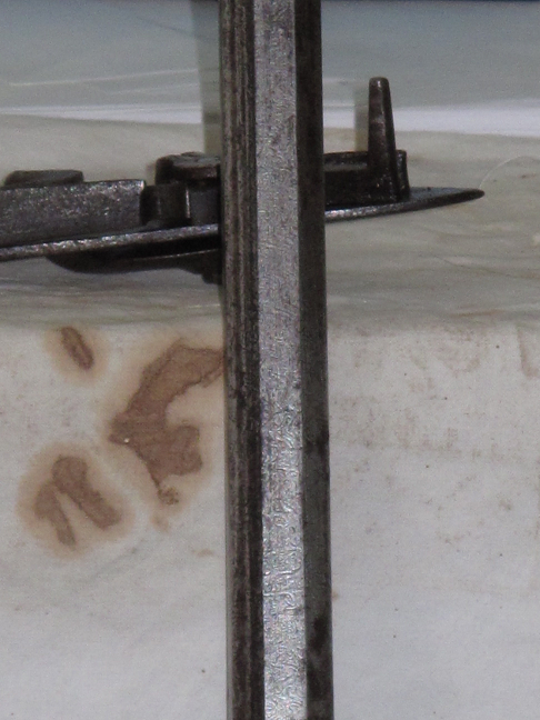

Well, I finally did it; I've dismantled the gun. No real surprises, I should imagine; the "ramrod" turns out to be a piece of painted dowel, inserted to keep the fore stock together, and the lock came away easily enough and seems, happily, to be in working order; at least, it certainly does a damned good impression of it! Having determined it was at the half-cock, I decided to cock it fully and fire, thereby releasing the tension on the mainspring. With the aid of a little WD40, it worked like a charm. My compliments to the maker!
The biggest surprise, however, is that the barrel steel does show a pattern! It might be damascus, I suppose, but then again it could just as well be faked damascus patterning. I'm trying to get a good photograph but this damned camera is still defeating my efforts; however, some select pictures can be seen below.

ok I see pattern. A quick and dirty way to see if it might come out take the strongest vinegar you have put in microwave and apply to the underside of the barrel. when you are finished use hot water or baking soda solution. It will not do anything bad to the outside appearence as long as you are reasonable carefull. If you see the watering that I expect I can talk you thru a better watering technique

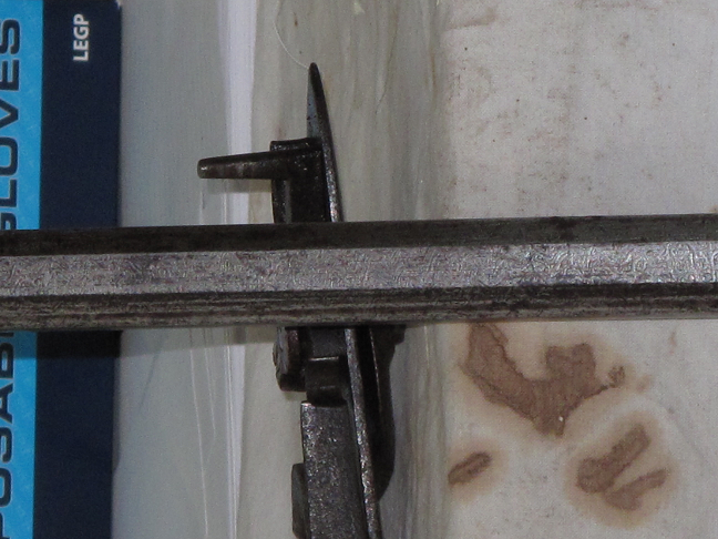

Right, I've done the vinegar-and-water acid etch trick. I can certainly see a difference; the pattern is very distinct, with many swirls and whorls, and even appears to have a tiny bit of a texture to it - though I can't feel anything through latex gloves. I've taken five pics and I hope they've come out all right, but if not, I'll work on getting some more done.
Incidentally, any tips and tricks on rust removal? I've not yet really embarked on de-rusting the barrel, since it seemed pointless when I was about to apply acid and water to it anyway, but hopefully I can now move onto that stage. So far I've tried a small area, using some reasonably fine glass paper, which seemed to produce results. With the lock, I've restricted myself to 3-in-1 oil and a soft cloth, removing as much excess oil as possible and leaving only a small amount as a film to inhibit further corrosion.

A small update. I spent a fair portion of Saturday working on the underside of the barrel, getting off as much corrosion as I could; gun cleaning oil, a good cloth and a great deal of patience have produced some result, with one patch of rust now down to the black, inactive stuff beneath. This area still has a film of oil upon it, so for now it's protected.
However, I really do need some advice on de-rusting wootz/Damascus; if it is indeed either metal, I don't want to destroy the pattern by over-enthusiastic attempts at rust removal. Furthermore, I'd ideally like to remove even the inactive rust. It strikes me as a shame to leave the beautiful metal beneath obscured by great black blotches. There is also a time factor at work here, in that the piece should ideally be ready for display by early May, and I'm away all of next week on a Curatorial course in London, so advice and assistance will be most gratefully received.

You may want to stop at this point removing heavy black pitting can be made better by using brass dental style picks along with oil.It is time consuming. To correctly acid etch a full barrell you need to submerge the whole barrel. You can get various other results using a quick ferricc chloride etch. If you are feeling brave you can do it with a full hydracloric bath but I would suggest you may want a chemist or a similar type of person with you to do it. It is a little dicey
