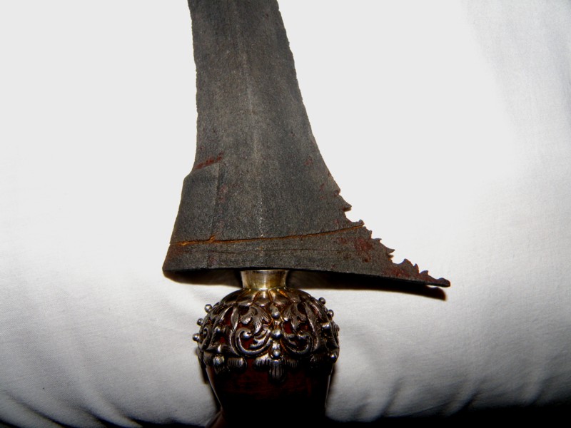

Hi guys,
I think this keris could be Pattani's pandai saras, in damar murub form.
What do you think?

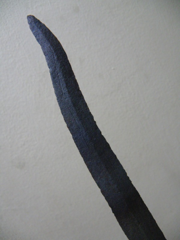

very very rare form indeed for a Pattani blade..... Could you please provide a clearer close up at the pucukan especially at the first luk. Thks.

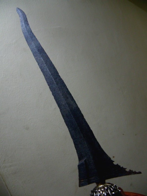

some more pix.
I've change the pix's orientation, initial pix surely get your neck twisted...sorry.

based on the pics... I dare say this is a true blue Pattani blade.... let me know if you are bored with it......

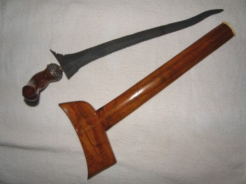

Pardon my knowledge in this region of keris, PenansangII, but what is the main classification of pattani blade?
Spoken of general characteristic of a patani blade, I know normally the diamond section that runs from the base of the sorsoran straight up to the edge is the easiest ticket to be claimed as a pattani piece, but is that the only characteristic?
Secondly, could we call this blade a pandai saras? Is the gandik form conforms to pandai saras?
I've also read about patani vs kelantan blade, but sadly I could not distinguish which is which. Is it possible that this blade could be a kelantanese piece as well?
Third, the dress. Is the hilt + sheath + pendokok also pattani style? Or was it north peninsula, or kelantanese?
By looking at the sheath fitments, I would say it was not the original sheath for the blade. Do you think it should be properly dressed like any given tajong would be?
Thanks in advance for any info that you could share with me. I still not bored with the blade but it could be bored with me instead

Anyway, was the hilt and sheath is also pattani?
