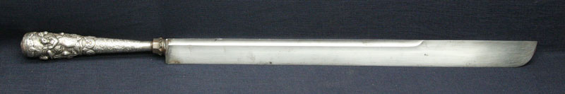

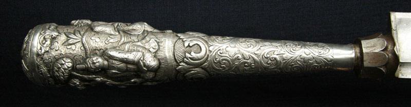

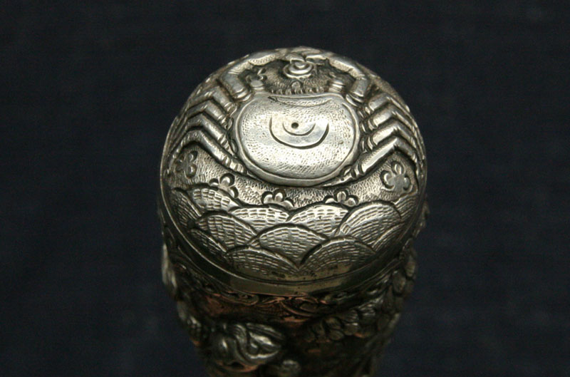

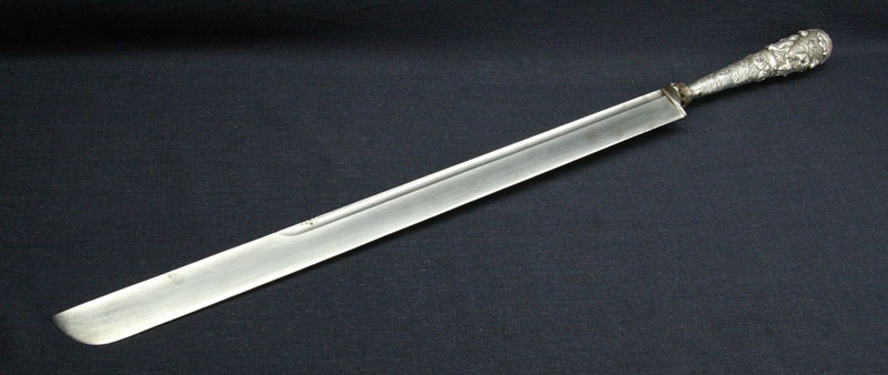

Hello, fellow collectors!
I have a question regarding the attribution of this piece.
The blade is in the style of the aceh sikin swords, but the hilt is quite different different. What are your thoughts on this piece?
Thanks!
Old 17th March 2010, 10:29 PM   #2
asomotif
asomotif's Avatar
Join Date: Nov 2006
Posts: 2,238
Nice sikin blade.
The handle has nothing to do with the blade and was attached later.
Considering the shape i would guess that the handle belongs on a fancy dinning table attached to a meat carving knife or fork
Old 17th March 2010, 11:30 PM   #3
Dmitry
Dmitry's Avatar
Join Date: Jul 2009
Posts: 612
My own theory is might be a handle is from a very high end umbrella. It is very good quality silver, of superb workmanship.
Old 18th March 2010, 12:20 PM   #4
a very similar sword was posted a while back, LINKY .
one conclusion was someone fitted a burmese silver parasol handle to a sikin blade....
Old 18th March 2010, 12:51 PM   #5
Dmitry
Dmitry's Avatar
Join Date: Jul 2009
Posts: 612
It's the same sword! ..Small world!
Thanks for the link!!!
