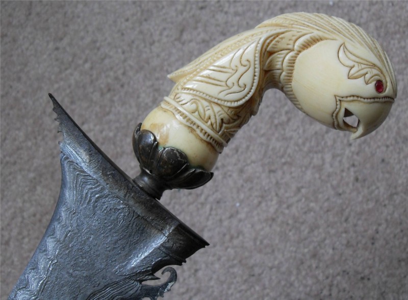

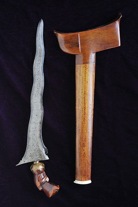

Dear All,

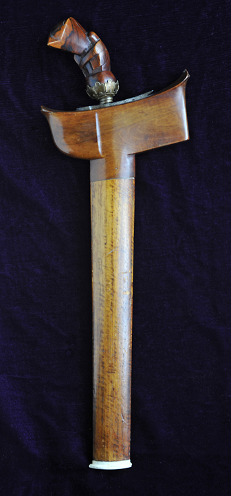

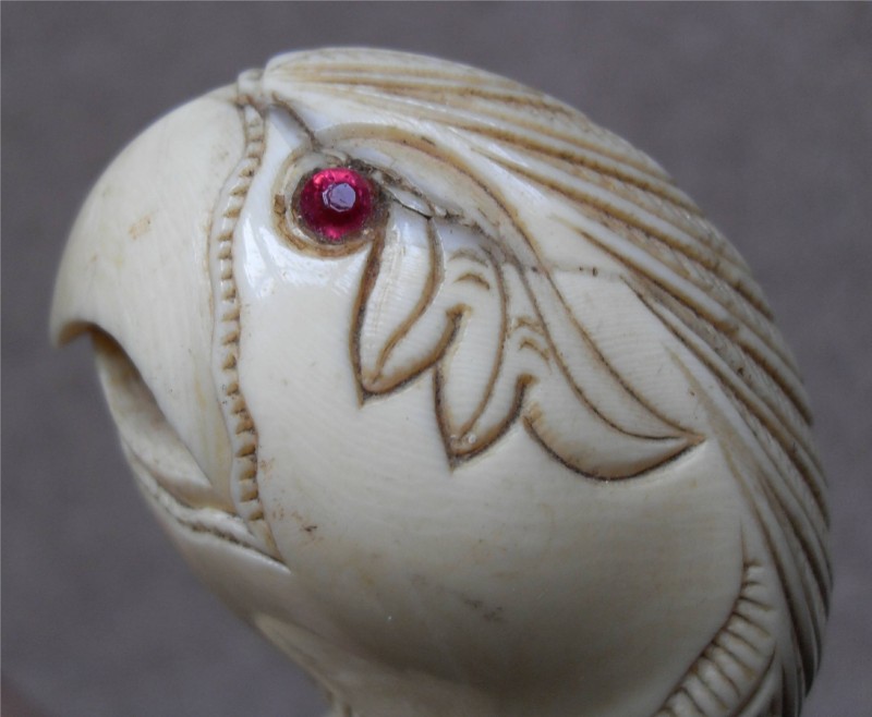

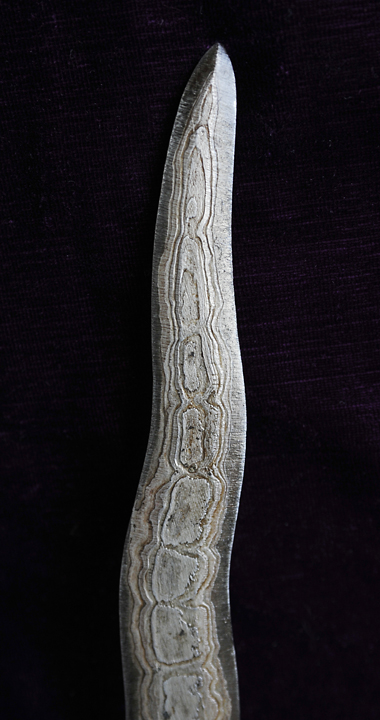

this one just ended on Ebay. It interested me, becouse I have never seen a Malay(?) sandang walikat sheet. Also the hilt form (Hulu Burung Serindit (?)) is not often seen.

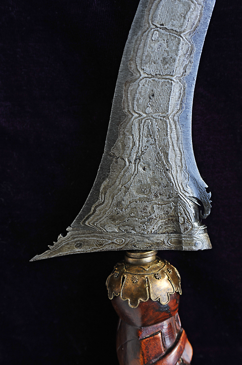

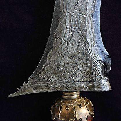

The blade seems to be in very good condition (if it is old).

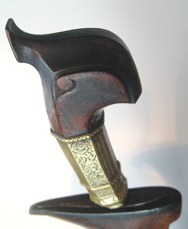

Old 11th March 2010, 09:55 PM   #2
Gustav
Join Date: Jun 2009
Posts: 1,346

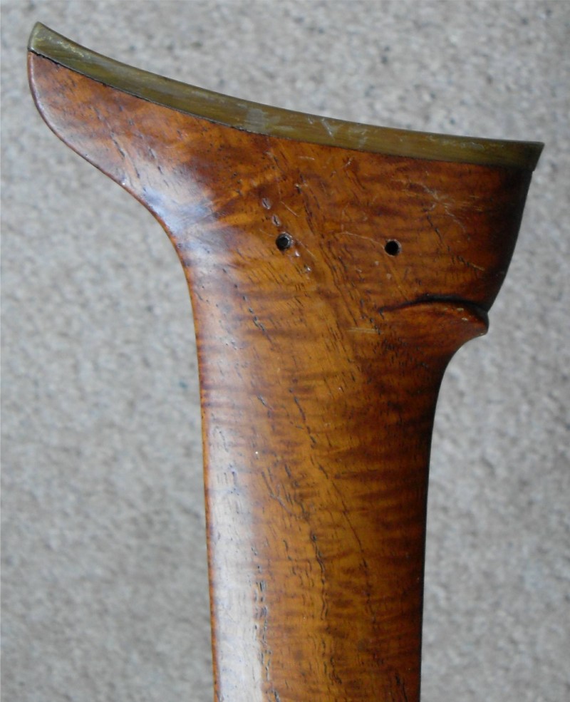

The hilt and sheath (Not so much patina?).

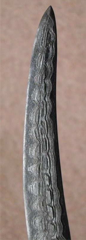

very good...i like a lot the hit, but also sarong and the blade seem nice (pamor tritik?)

I could be much more certain of my following comments were I to have this keris in my hand, however, here are my immediate impressions:-
1)--- blade is very recent Madura
2)--- hilt is recent Madura production
3)--- scabbard is an old one that has been reshaped to a sandang walikat form, and the piece of horn added to the top to allow perfect fitting of a blade that does not belong with this scabbard.
This appears to be a recent, high class and deliberate attempt to decieve.

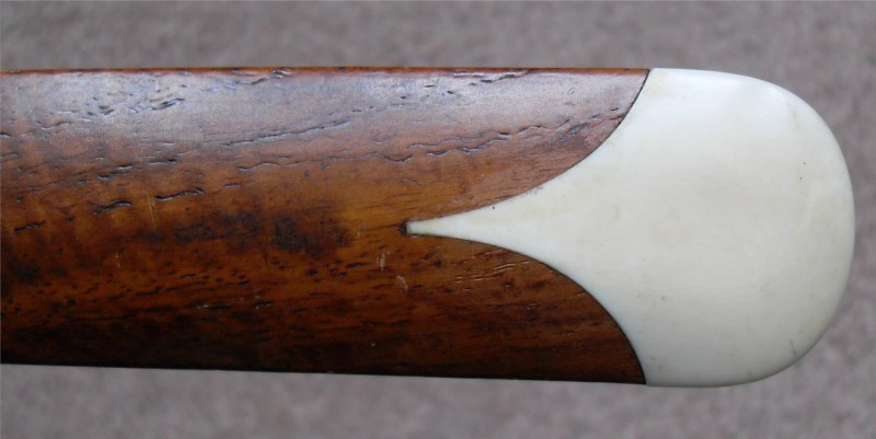

Blade:- if it looks like a duck, it is a duck, and I've seen thousands of this particular breed of duck. This is not an exaggeration.
Handle:- I've seen this hilt motif in new hilts from Madura, and it looks like Sumenep work, but I'm not nearly so certain of this as I am of the blade; it could probably come from anywhere where good quality carving is still done.
Scabbard:- I've seen the horn glued to the top of the wrongko to ensure good fit a few times, but never on anything old; the actual wood itself looks oldish, it may not have originally been a keris scabbard, but something else; the ivory buntut is perfect and obviously new, normally they're patinated and with a crack or two.
As always when looking at pics, I could be wrong --- but overall I don't think I am. I tend to automatically distrust anything I have not seen before, and I've never seen anything at all like this. With all the keris I have seen and handled, I should have, if it is a genuine type.
A. G. Maisey is online now   Reply With Quote
