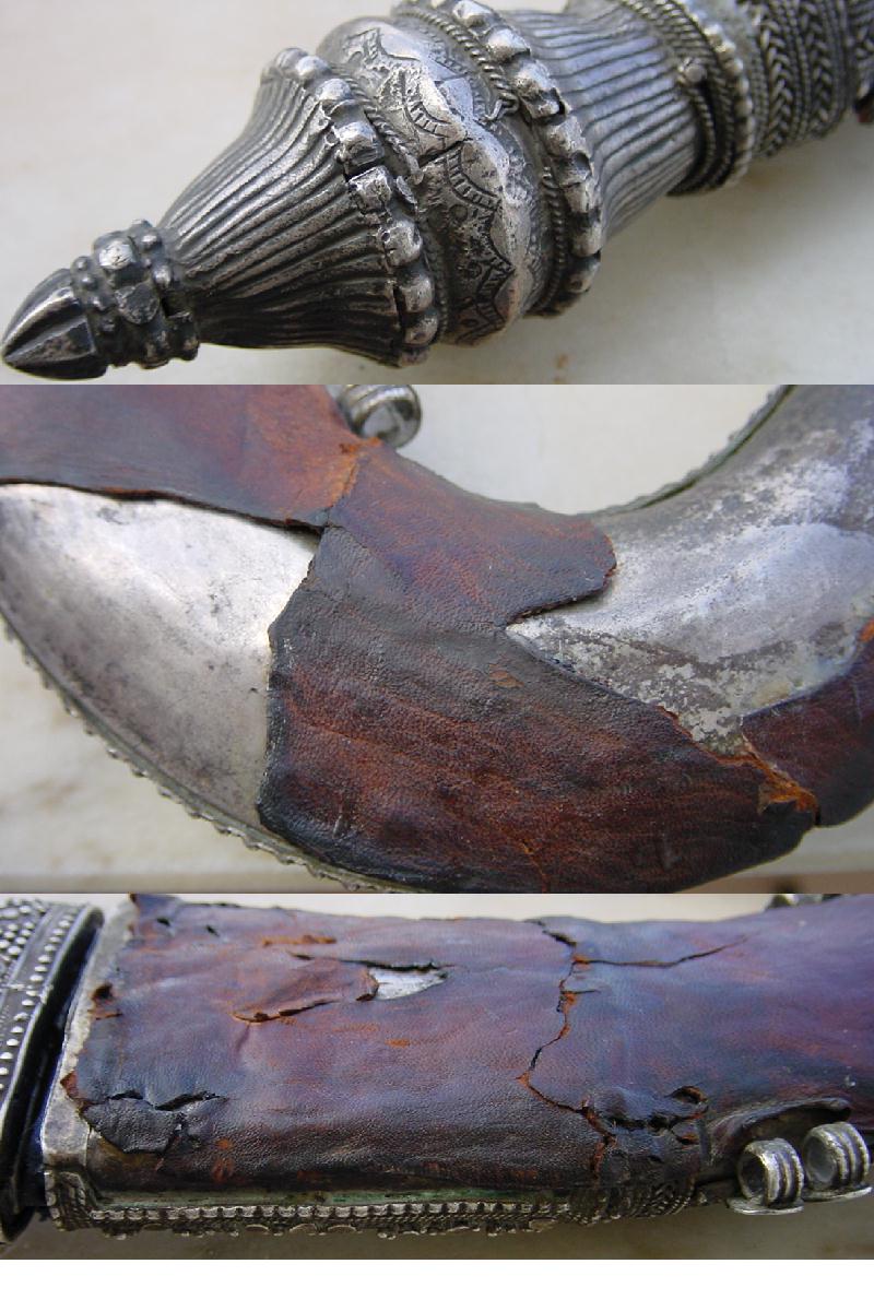

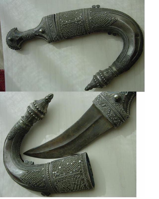

Hello Gentlemen
I just bought this jambia, with hilt and scabbard in what looks to be propper silver. I wonder if this is not just a tourist souvenir, due to the somewhat dark patina of the silver, and to the stifness of the leather cover in the scabbard back, like having being long sweated against the body. But naturally this could be all my fantasy, as i am an igorant on these weapons. Also the dotted inscription in the pommel back is beyhond my reach.
The seller said it was brought by someone, from Libya. Is this plausible?
Any help woulb be so much wellcome.

Hello Fernando,
I do not know much about these except there are a lot here in the UK as we had 'interests' in the Yemen. Yours may be from Libya but the silver work looks Yemen to me, it also has a reasonable blade. So many here in the UK even quite old looking ones, often with rather fancy scabbards have nasty tourist looking blades. I have not got one of these, I have not seen the right one. Tim

This one is old, no doubt.
It is a Gusbi Jambiya from Hadramaut, South Yemen. Not a "run of the mill " finding! Congratulations!

Hi,
I agree with Ariel. Yemeni and probably fairly old, definitely not made to be sold in a tourist shop.
They still make fantastic jambiyas like this today, though I have only seen them offered by Yemeni (from Sanaa) sellers at the Dubai Shopping Festival. I never ventured to Yemen as it wasn't the safest place for a yank. Anyway, I saw more than a few hundred examples and the only way I could tell the new from the old was the blade - another aspect of yours that looks older.

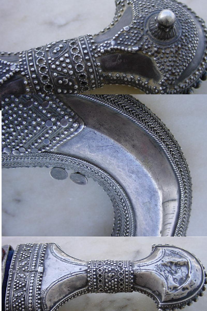

I notice a little hole in the leather on the back. Is there a small silver coin there with an incsription?
Carter may be able to read the back of the grip.

Posts: 273
Based on the shape of the grip my guess would be the Najran area of Saudi Arabia.

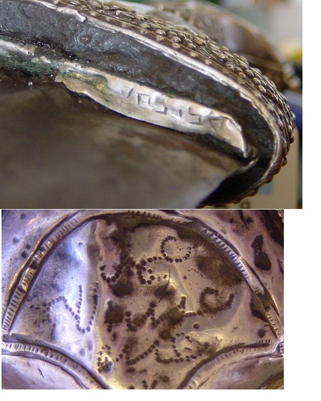

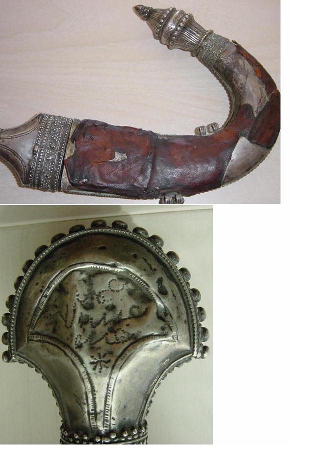

Thank you so much for the precious info. It would still be great to figure out the meaning of the arab engraving on the grip.
I would be so much obliged for help in this area.

Posts: 7,416
Yes it is definitely Hebrew. Artzi's Hebrew is better than mine. Good probability of Jews in Yemen and their silver artistry. Also, most likely low grade silver, or the part that is not seen much could be in white metal to lower costs, soldered to the rest of the silver work.

I think the greennish efect comes from the bizare reaction of the digital camera coulor definition, maybe because the pictures were not taken with
natural light. The only green i actually see, is some verdigris in the seam soldering. I also appreciated the scabbard interior, as its two parts were loose, and i had to refix them; to me, it looks and bends like silver sheet, rather than white brass or alpaca.
I will take it to a local jewelry shop friend, for appreciation, as this is a point i wish to know for sure.
Needless to say i am already deeply pleased with the findings on the arabic owners name and probable hebrew maker's marks.
