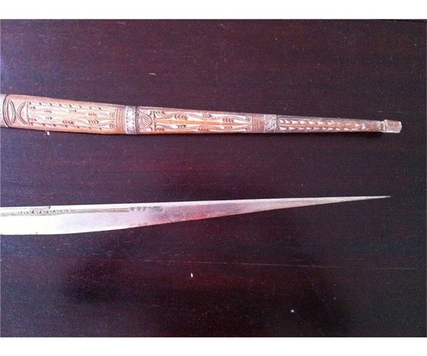

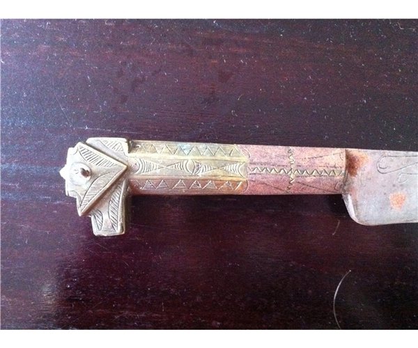

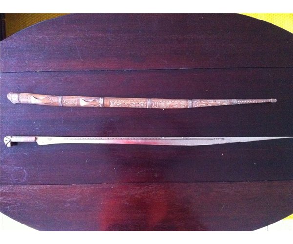

Can anyone tell me about the shape of this sword like history, use and rarity? I think its in a very good condition, but are they easy to find better?
Thanks!

Your sword is an Algerian Berber Flissa.

As Eric said, it is a flissa or flyssa, sword of the Kabyle people of Algeria and part of Morocco.
Your example seems nice, although you should clean the rust. The large ones are generally considered more attractive and the quality of the decorative engraving and inlay is also a way to judge them by. It is hard to see from your photos very much detail about this.
A little searching on the forum for flissa or flyssa will give you a lot of information about them. Some of the members have done quite a bit of research into the type.

My understanding is that flyssas were used virtually exclusively for slashing, which will go along quite well with the comments of the contemporaries about absent stabbing technique in arab and indian swordplays.
Indeed, the point is weak, and the absent guard would allow the hand to slip off with stabbing. However..... Any evidence of stabbing anyway?
